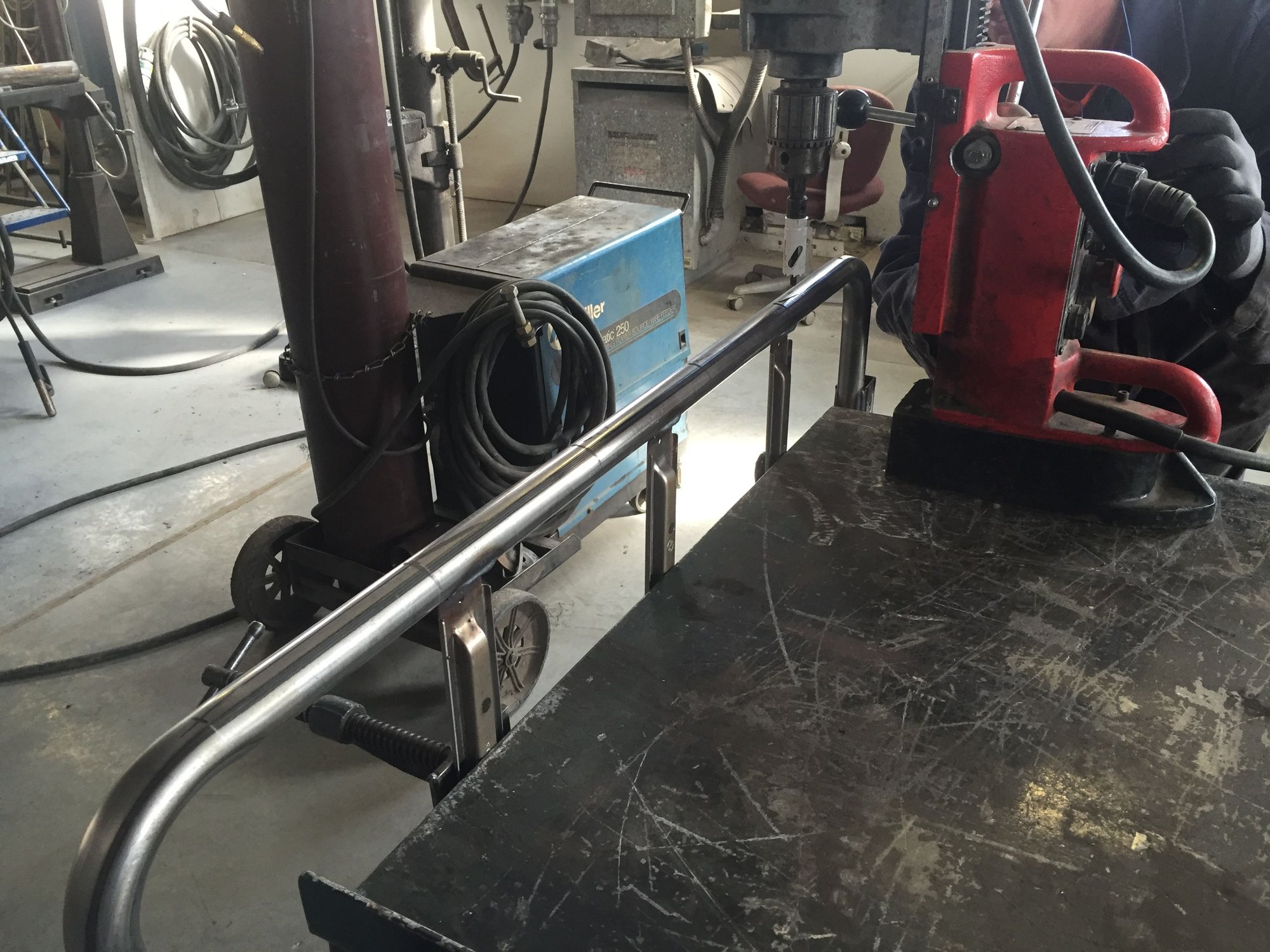

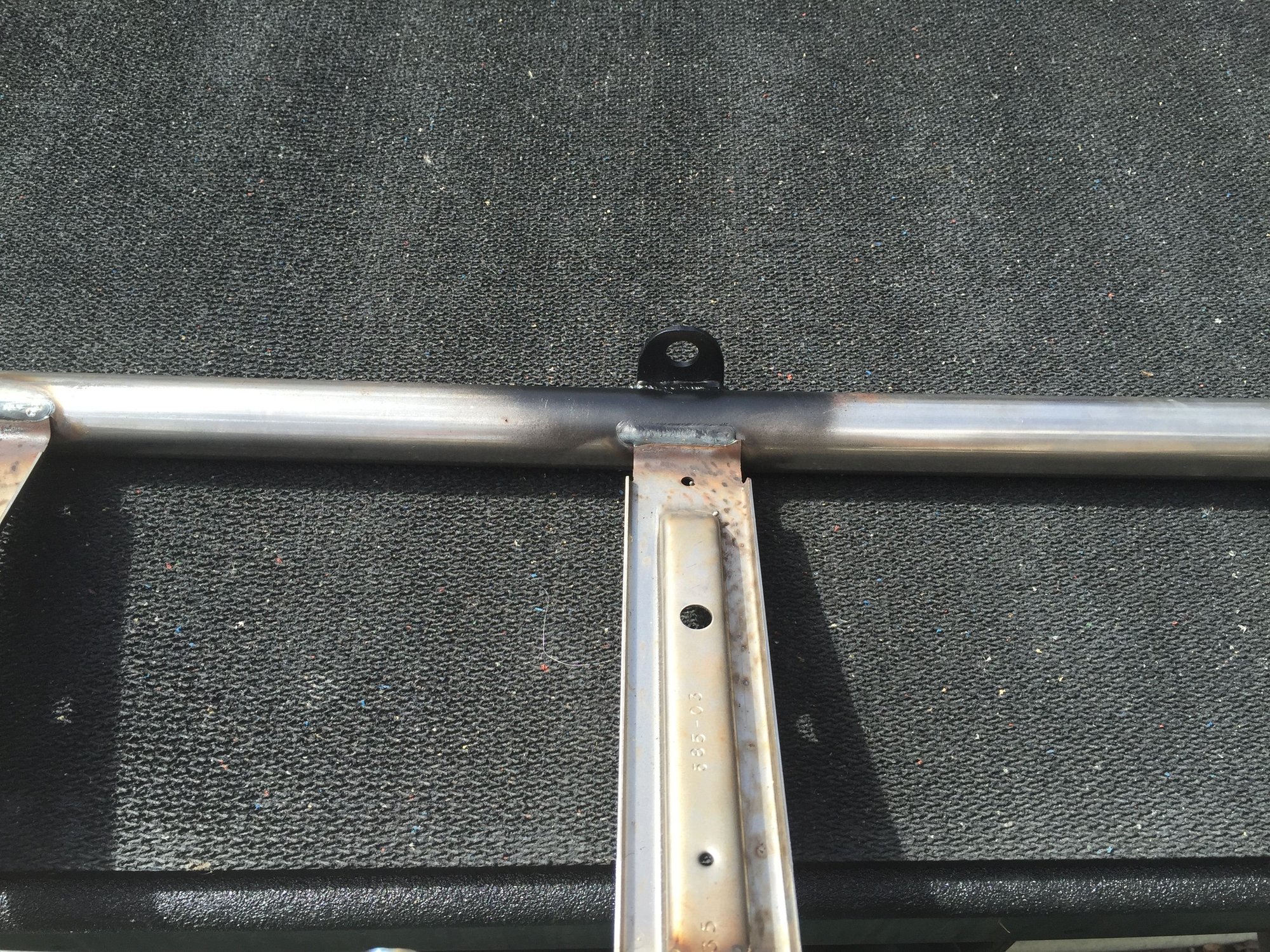

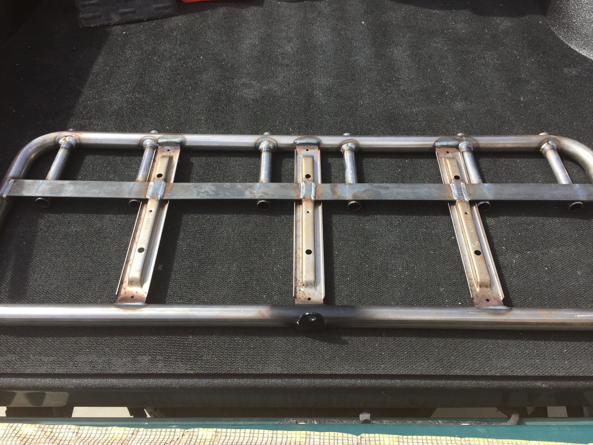

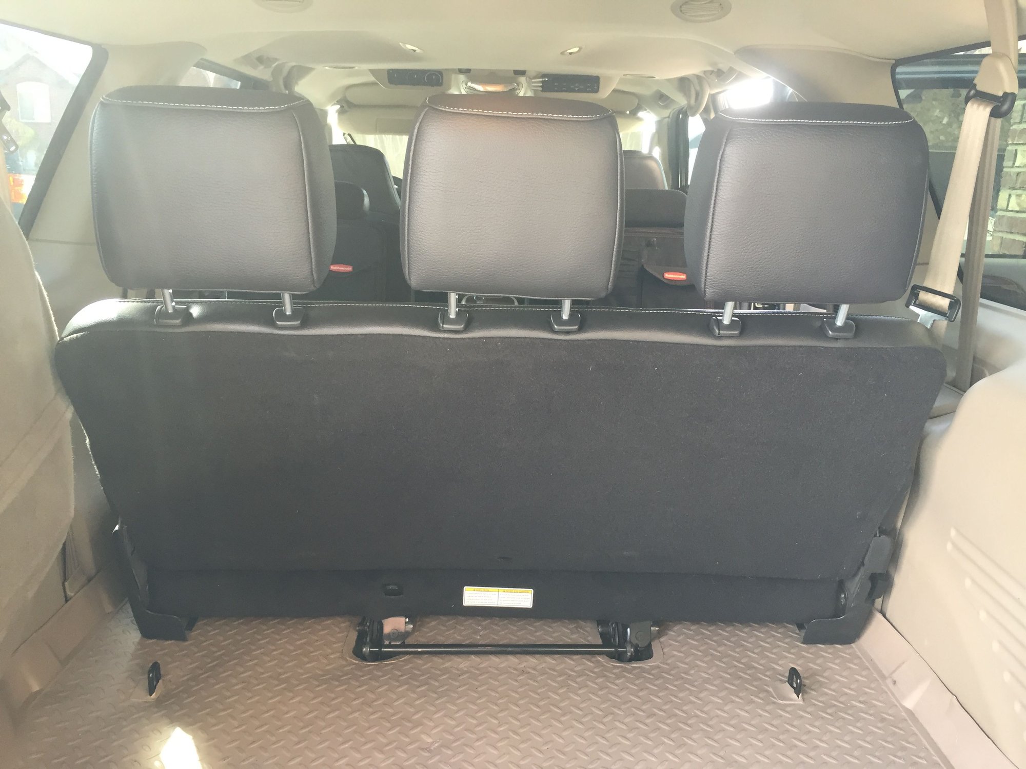

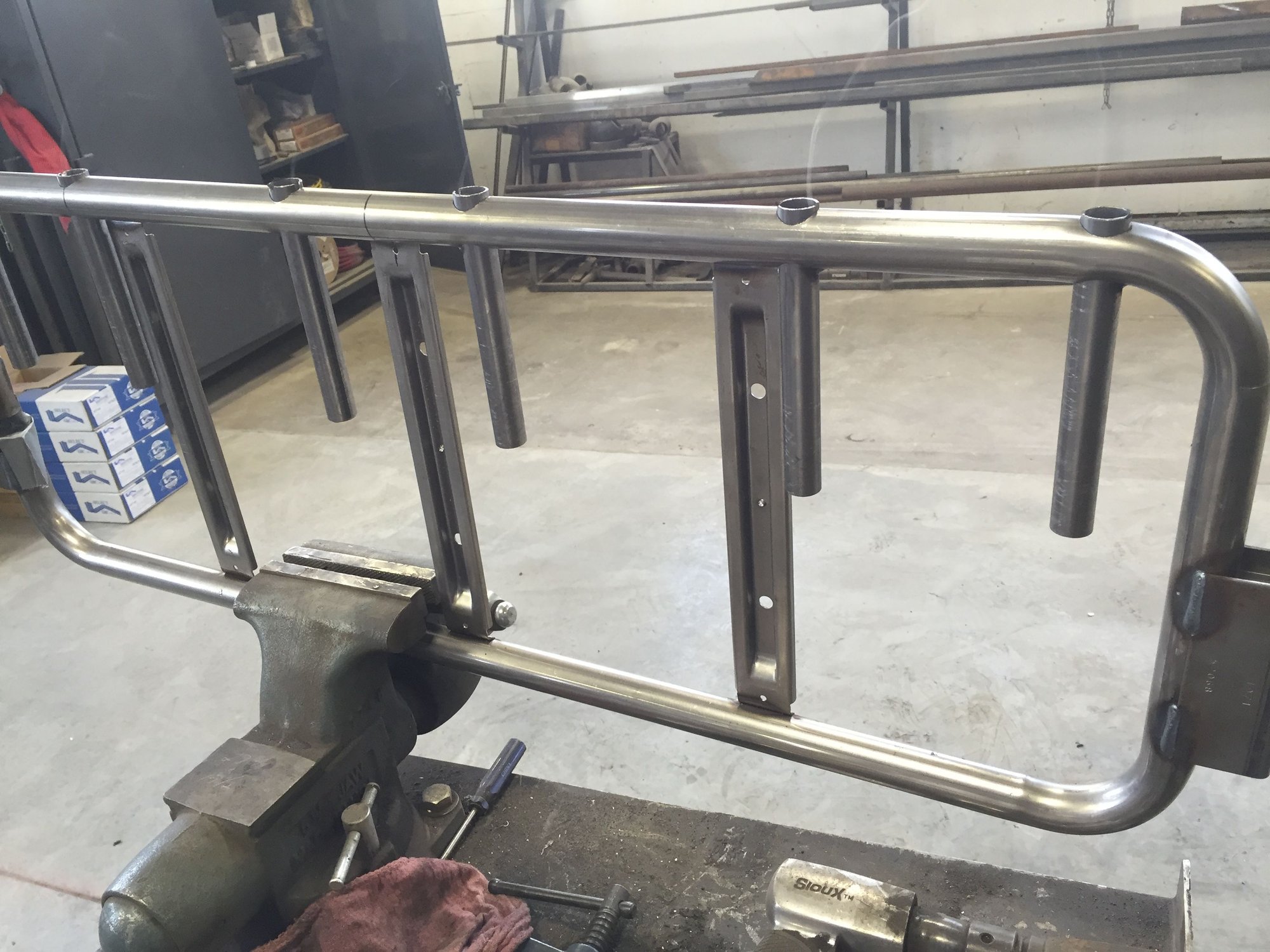

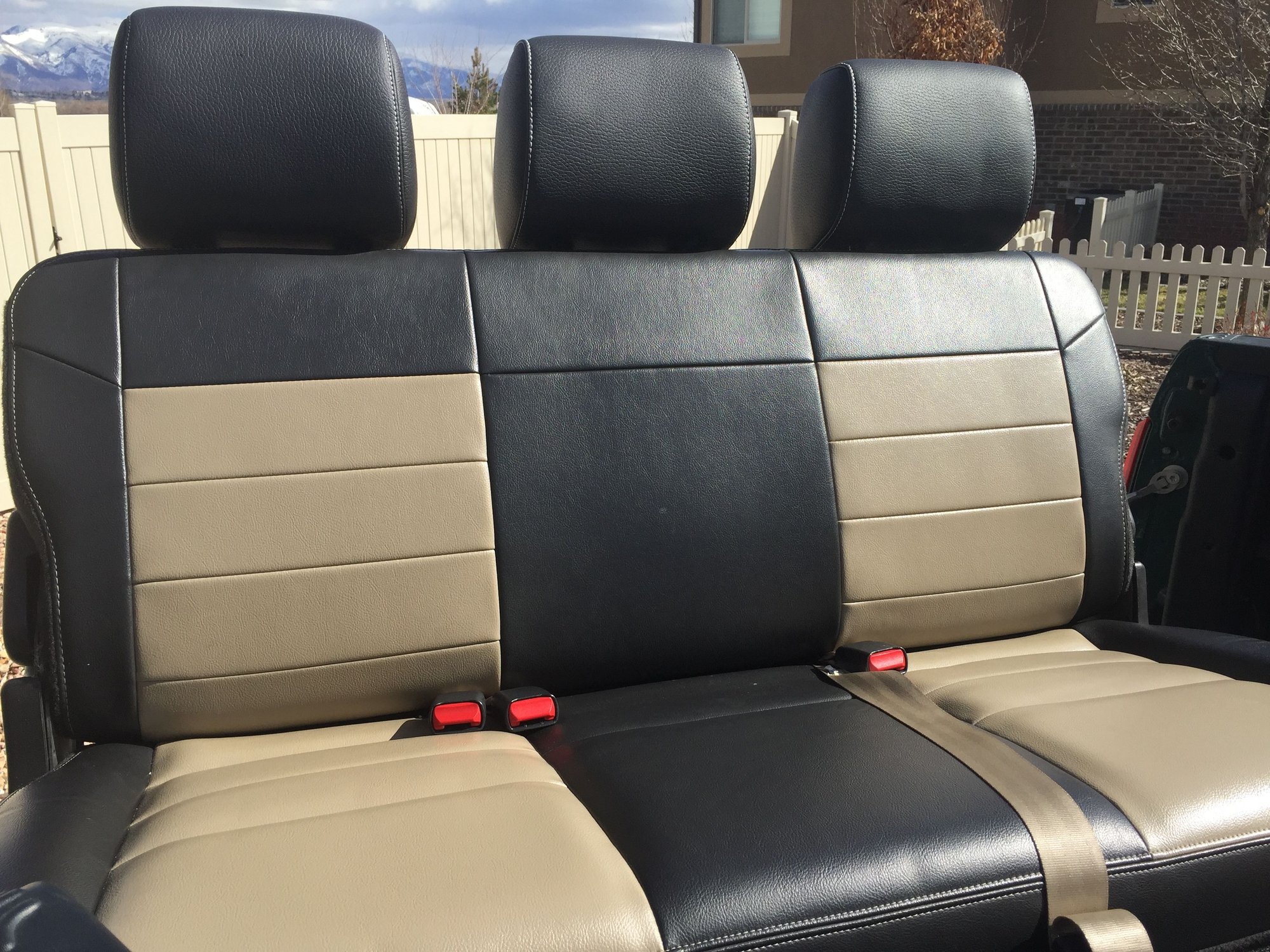

I'm going to piggy back on this thread so I hope thats ok Mrs Mouse. It doesnt seem like there is a reason to start another one of these threads. Besides this thread is what motivated me to get this done.
I added the headrests to my 3rd row on my 05 eddie bauer. I purchased upgrade aftermarket 2011-2014 Mustang tilting headrests http://www.stage3motorsports.com/11A...drest-Kit.html that matches the black leather with white stitching the 05 eddie bauer excursions have. $250 for a set. Then I ordered 6 black oem mustang headrest guides. CE5Z-54610A16-GB
I used a mag drill to keep the holes I drilled in the straight. I added some reinforcement straps to the bottom of the new tubes the guides sit in. Probably overkill, but I thought what the hell. I also added a car seat teather to the middle of the seat. The factory one and only one is not lined up at all for an upper child seat teather to fasten to.

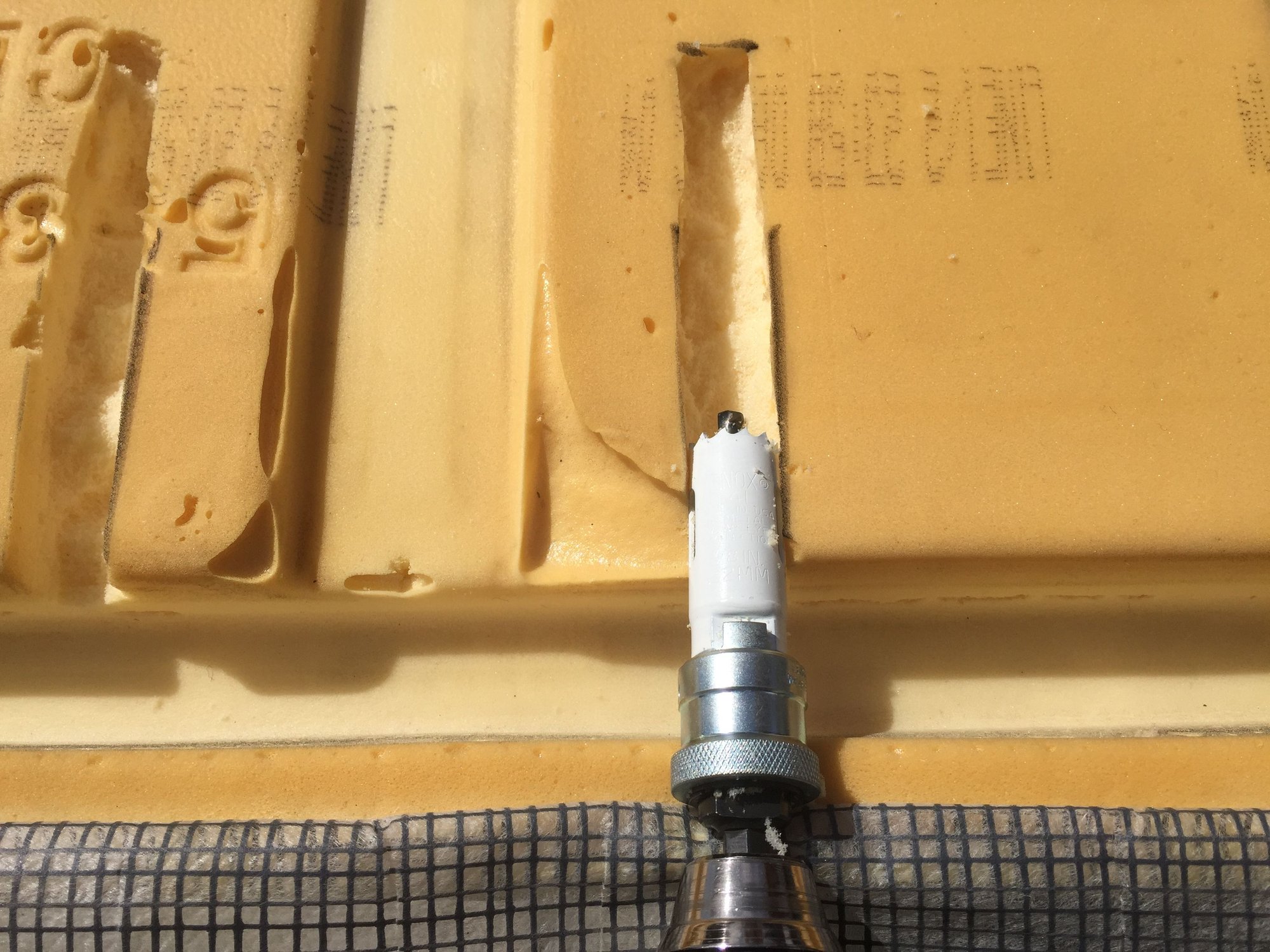

The only other pointer I have is a 3/4 hole saw with the drill on reverse makes cutting the foam out for new guide tubes much easier.
Then the final product. Sorry for the crappy pictures.
This is a easy and great mod to do. My oldest boy was getting to big for his booster seat, and I wanted some whiplash protection for him in the 3rd row.

Just finished up my third row seats and it came out good. It a good thing for me the welds are all covered up because I made a mess doing it but I got it to work for my first time welding.
The headrests on the end seats are are from a 00 or 01 Navigator the center is my original Excursion head rest. The color and the stitching of the headrests match pretty well.
