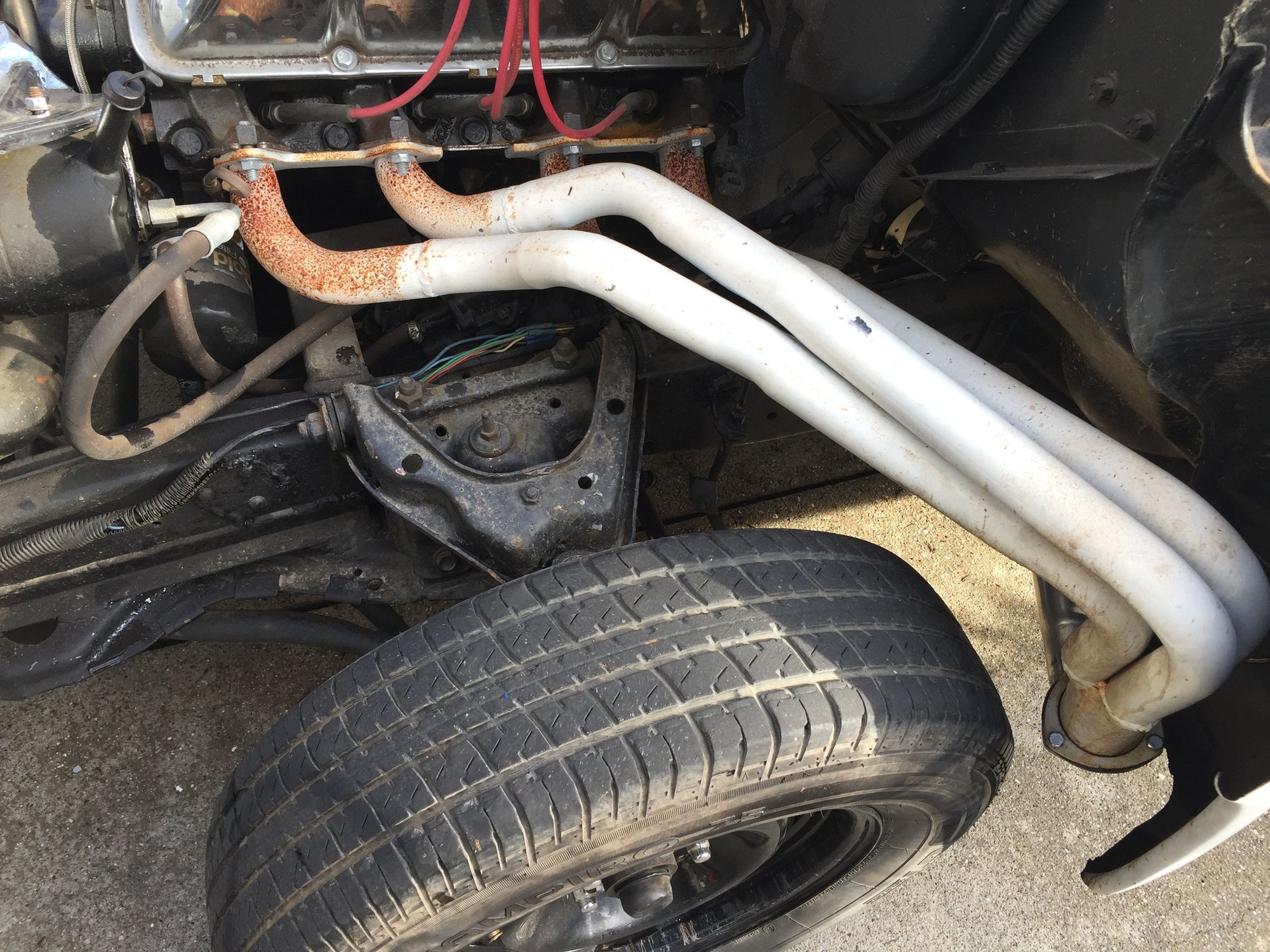

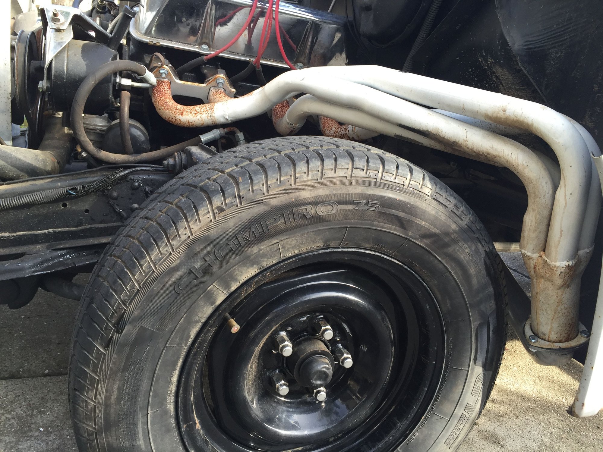

Here are the headers. As ou can see, not much room to lower it and it sits high

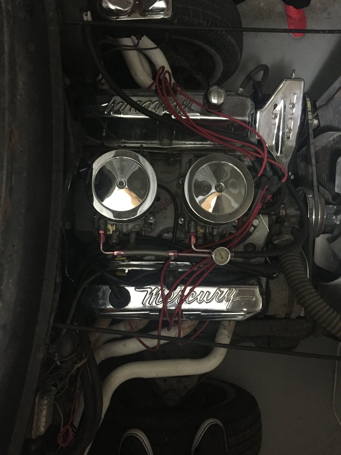

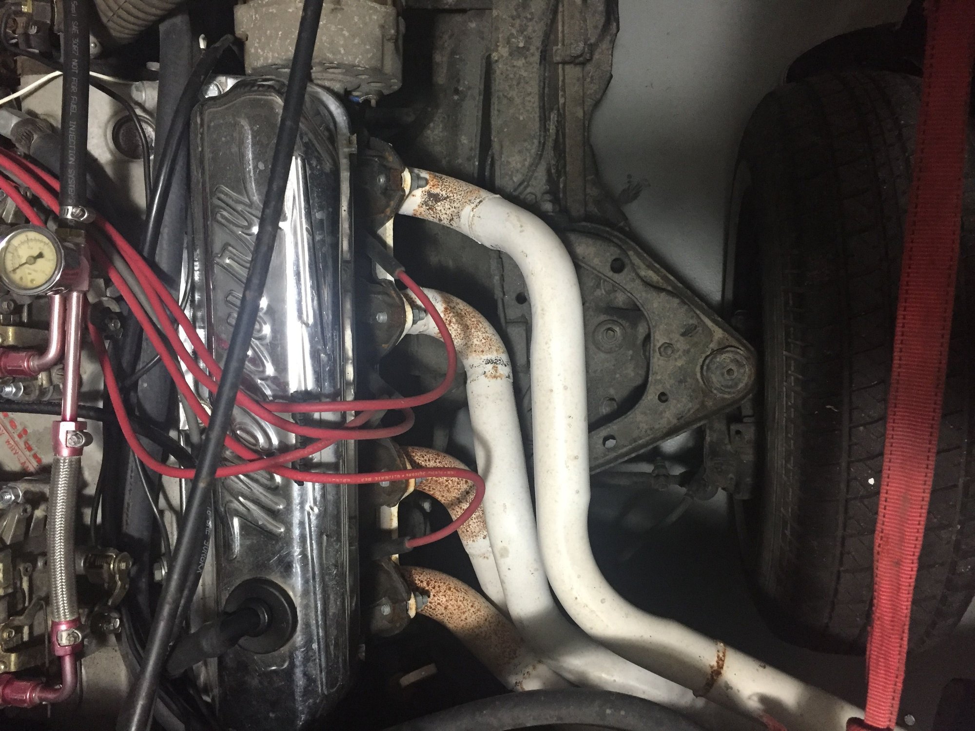

What is the frt clip?
Looks to be GM, which will affect what headers will go in there. See if you can get a top view of the frame area around the motor mount to see whats in there for clearance.

Here are some pics. Might be too dark but I'll try taking a better one tomorrow. From what I know, it's a volare front end. A dodge/Plymouth. But I'm not an expert...
