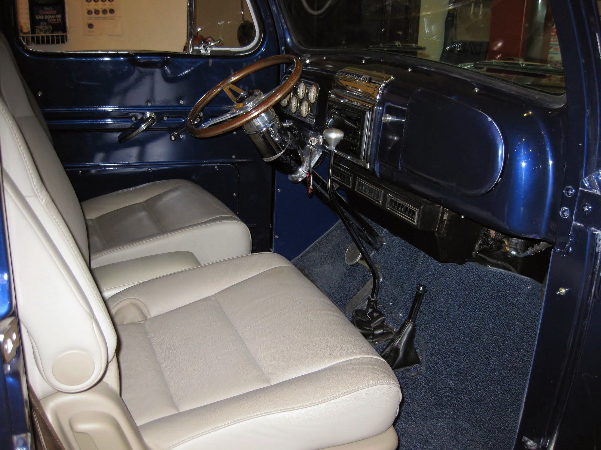

This is what I did on my wife's 52. Speaker grill is the center outlet and there are two small black outlets at the outside bottom of the dash. I used a 53-56 heater control panel for the controls and tucked the evaporator up under the dash. Most people don't know it has AC.
looking through drivers side window. I'm doing some work so the shifter and kick panel are removed.
Looking through the passenger window. Had to tell it has AC. That little silver thing you see below the glove box is the bottom of the evaporator. The cowl vent still works.

Great job Mike! What is the evaporator out of? Is there still a flatty under the hood?

I still have the flatty but not in the truck, has a 2015 Mustang GT 5.0. Evaporator is a Vintage Air unit. Here is a link to my build thread that has photos of the evaporator installed.
https://www.ford-trucks.com/forums/1...ld-thread.html
