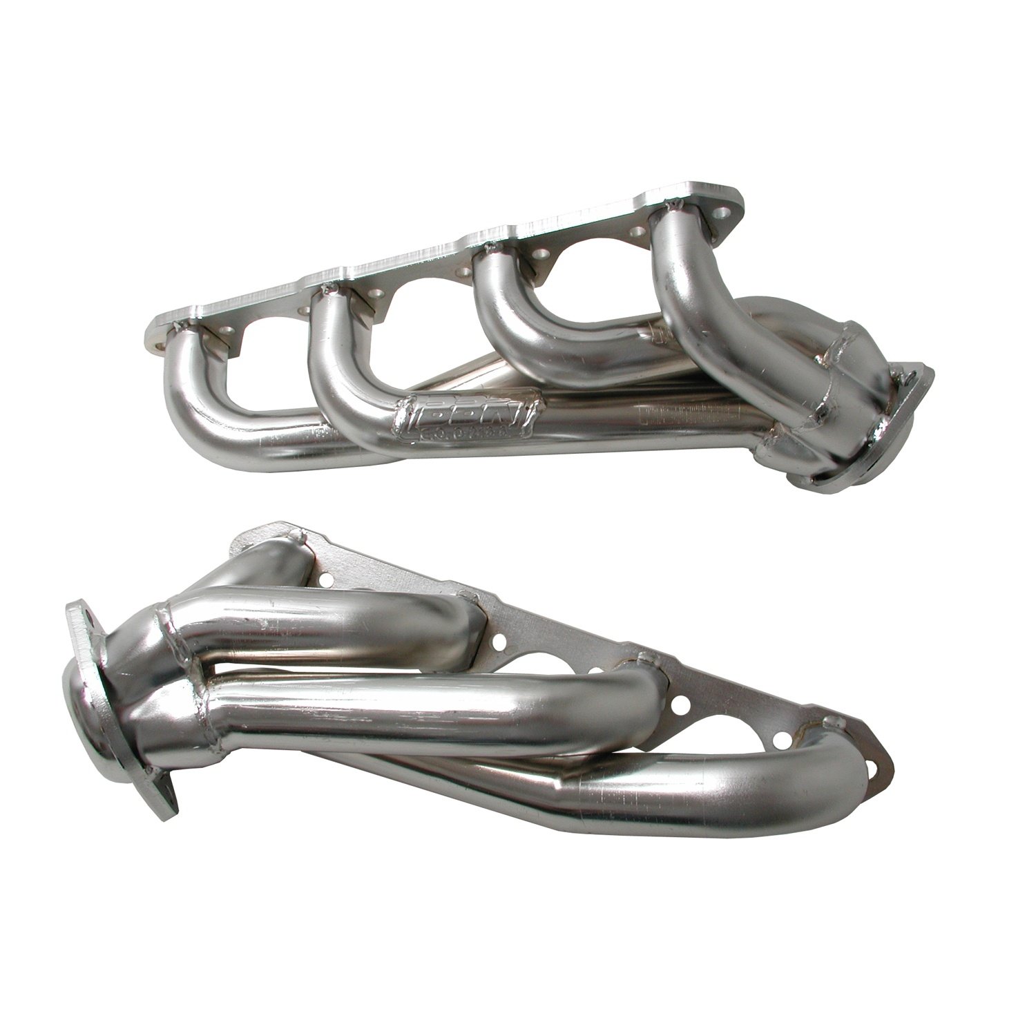

I don't remember seeing a 351W/C.V. swap header post. If nobody chimes in might I suggest Mustang Shortie headers? These would miss the motor mount stands. Dunno if you're going to have clutch linkage though.

Hey I have a 351w with AOD and I'm using the 66-77 long tube headers. I had the Mustang shorties and just switched to these Hedman Bronco headers and they are way better. A good muffler shop can work the exhaust around the tranny mount if your using a C4/AOD.
