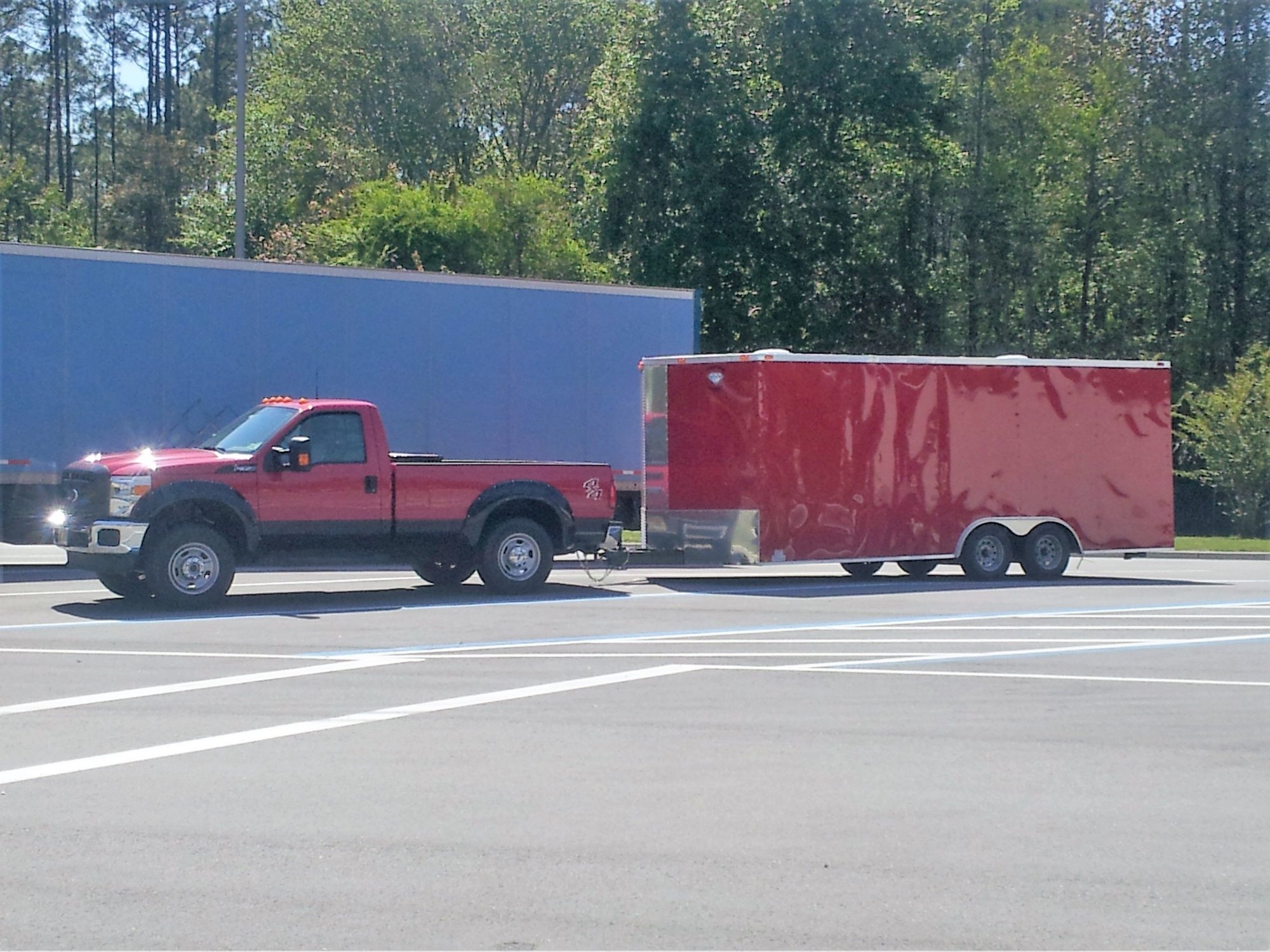

I know it's not the same set up - I made the trip back and forth New Jersey - Florida a dozen times towing this trailer, all of the weights put the trailer between 9600 & 1045 pounds. Never a problem !
Gas, 4x4, automatic, 3.73.
Trailer loaded weighed in at 9800 pounds. <br/>

I meant all of the scale weights put the trailer between 9600 & 10045 pounds. I weighed the trailer each trip just for my own knowledge.
You should be very happy with the 6.2 gas engine.
