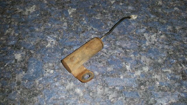

So I'm not sure what this is and I can't remember where it is mounted ?

That looks like a condenser (aka capacitor). Might be used to suppress radio interference. It doesn't look like the one that fits inside a distributor. But, spark plug wires and general ignition noise can make it's way into the radio and come out the speaker so they often used a device like this to block that noise.

Cannot see the term on the end of the pigtail, seeing it might help. Judging by the size of the mounting hole I'd say it goes on one of the hex screws that mount the volt regulator up next to the radiator. It would help with noise suppression, especially with a generator charging system. Pretty sure your 65 Merc has an alt.

Thanks, now I can at least search my parts book and maybe pull up a diagram of where it mounts. I'm not actually installing my Pushbutton AM radio until it's tested and repaired.

The end was broken and some tin foil was wrapped over it. I believe I have an alternator.

You'll know if your in a vehicle listening to the radio that this part is either defective or missing if - as the engine accelerates and decelerates in RPM - the squeal coming through the radio speaker matches it by going up or down in frequency. The buzzing will start to drive a person bonkers. You can still hear the radio station but it's overshadowed but this constantly changing noise. Easy to recognize. Actually, it's a steady buzz if on the highway at steady speeds or idling, but idling it's not AS bad because it less cycles per.

Having an alt.you would have a flat connector with a place for 4 terminals that plugs into your regulator. If the harness is handy, look at the the connector wire side and see if there might be the broken part of that pigtail showing in one of the slots, it could have been attached/double upped with one of the other wires. My 66 f-250 doesn't have one as mine never had radio. I would be interesting to know if Ford ever sold a complete Radio installation kit for these Slicks if there was a parts breakdown for the kit.

I agree that it looks like it gos by the voltage regulator

I cleaned up the end, C60A-18832A is the number. I'll check the harness tomorrow.

There must be a spare bolt or screw that held the condenser down, thanks for pointing my in the right direction!

It would have attached to one of the regulator mounting screws, I believe
