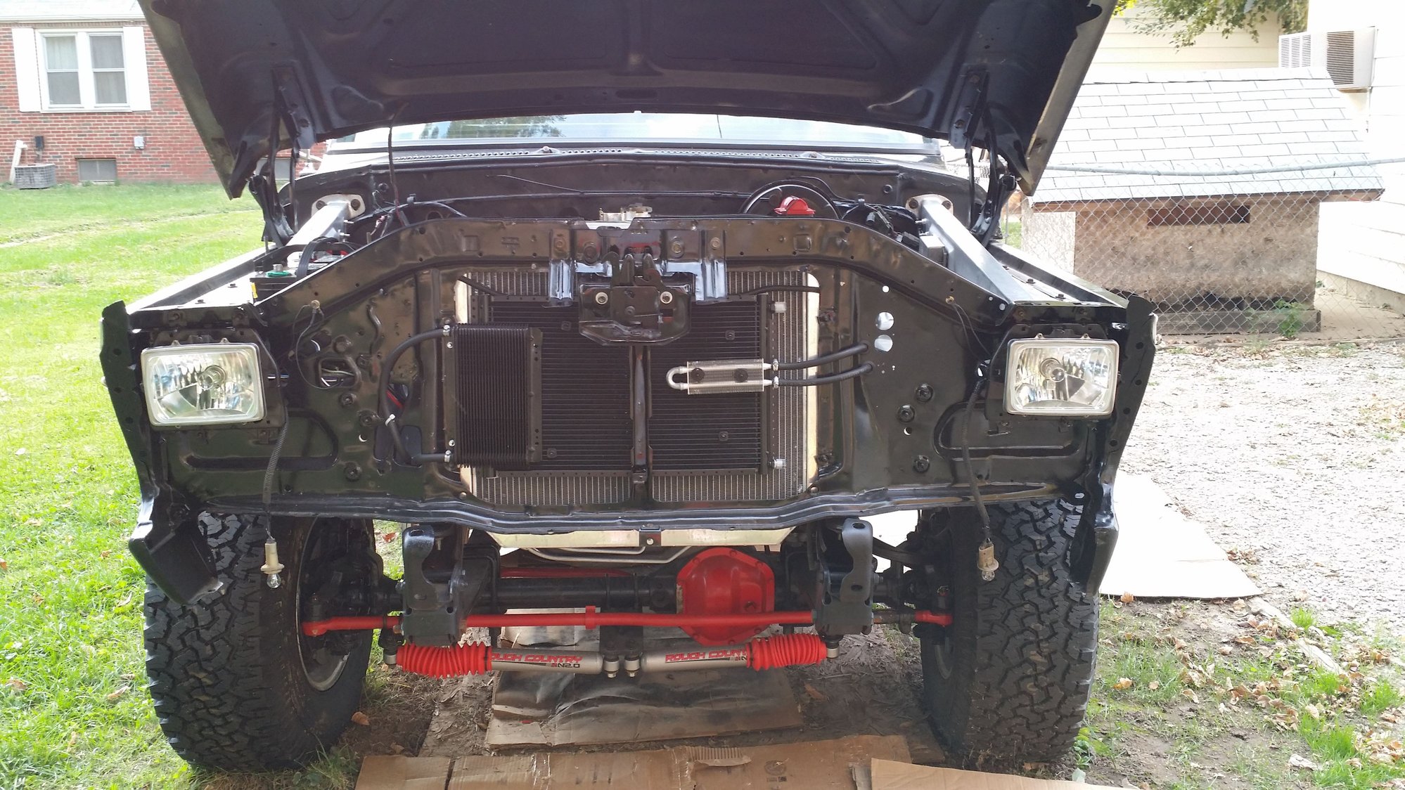

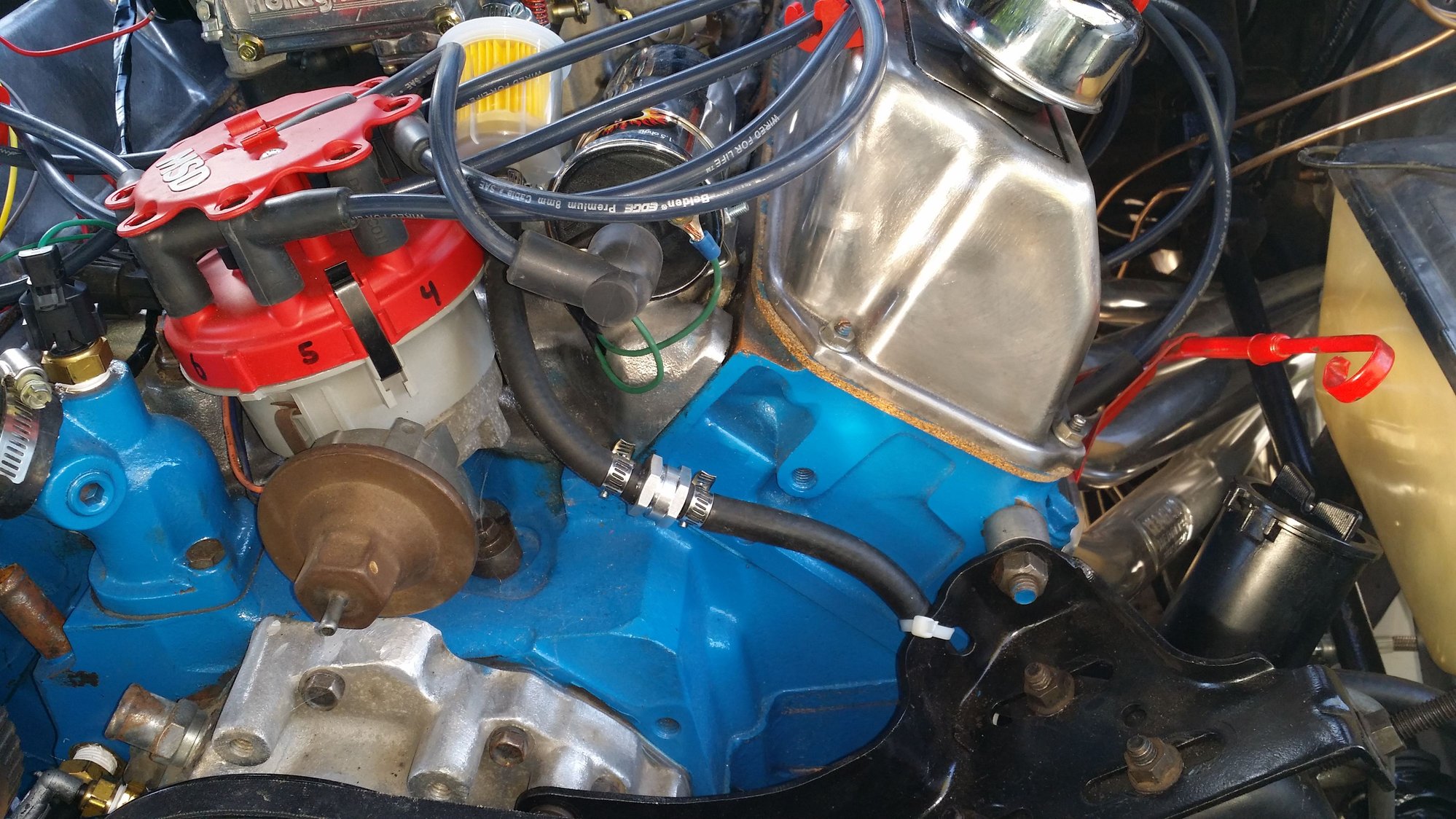

Here is my two cents. I use a carter electric fuel pump in my 78 F250 and it works great. I bought a check valve and installed it by the fuel filter as well as a small cooler for my fuel line and all problems solved.
