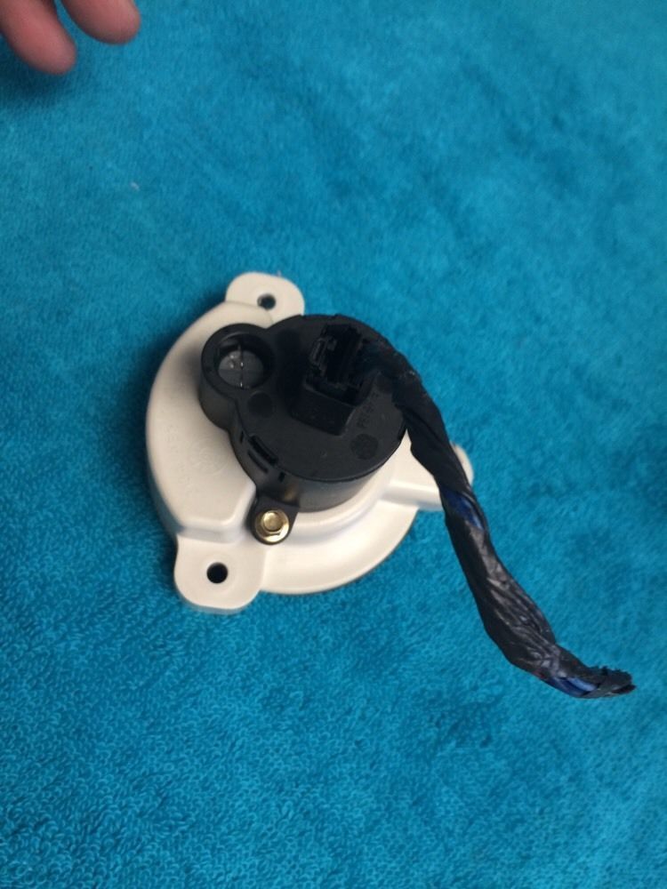

The 4x4 switch has the illumination on the small connector on this picture:
Not sure if it's replaceable, but might be.

The illumination feed is on pin 14 on the smaller 22 pin connector, LB/RD wire.
