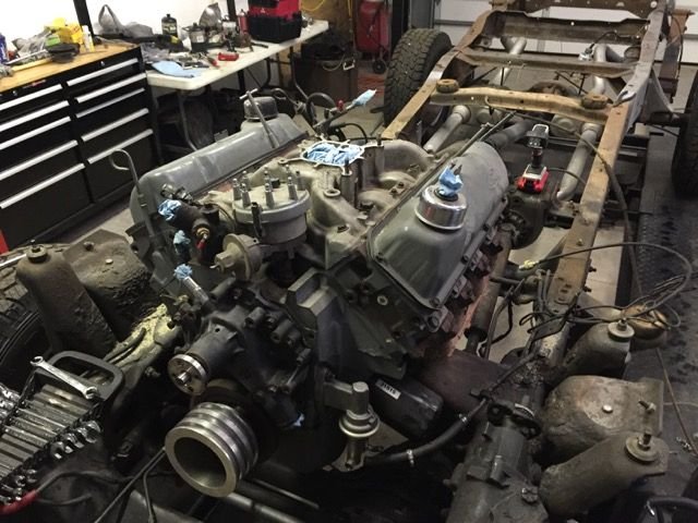

Old Dec 29, 2015 | 08:31 PM
Heliguy's Avatar
Heliguy
Joined: Jul 2015
Posts: 426
This is where I left it today. Tomorrow I should have the drive-train out and then its time to start cleaning and putting her back together. Thanks for all the responses, Ill start beating those mounts out tomorrow.
