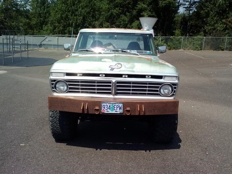

I already have a 6 inch suspension lift I need to go 2 inches higher to go with my tires. My bumper weights just over 300 pounds and the winch almost a hundred. The tires on my truck right now are Dick Cepek
38X15.5-15.The tires that are going on my truck are 39.5X15X15. Those blocks came from Mcbay performance. It goes between the spring perch and the housing. They don't look very safe so I'm going with a 2 inch body lift what do you think.
38x15.5-15 Dick Cepek 15X12 41/2 back space.
0806131417a
