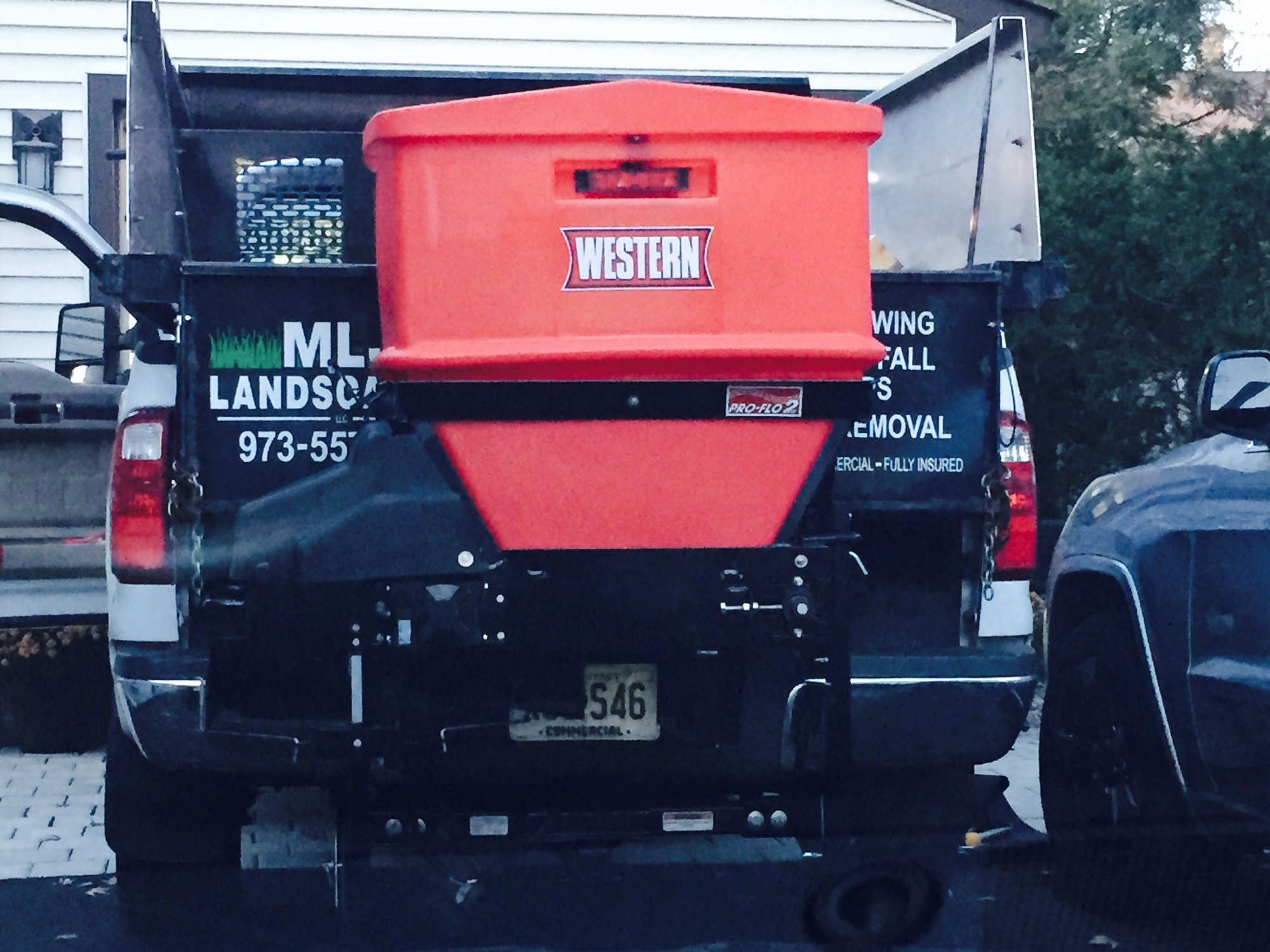

2008 Ford F-350. Regular cab 8' bed.
I'm looking for options to increase payload. I have my dump insert in the truck year round which is about 800lbs. I now installed a tailgate salter and when that sucker is full it adds about 900-1100 lbs. which includes salt and the salter. Plus some extra salt in the bed.
What are my options? Air bags ? Add a leaf ? My buddy was telling me about having the springs re done. Meaning they take your stock leafs out and do something to them and re-install.
Thanks guys
Matt

Well I think my squat is noticeable because with the tailgate spreader mounted the weight is out past the end of the truck. That's my main issue here. If the weight was in the bed over the axle or in front of the axle there would be no issue
