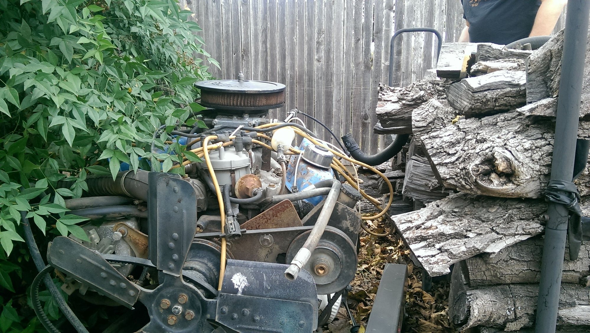

Actually not replacing. Adding. Planning on something from vintage air or old air (not sure which yet). The pic below shows what the accessories looked like before I tore it down. Note the saginaw ps pump that I'm hoping to re-use, on the driver side and alternator on passenger.
What I would like to do is keep power steering on driver and have alternator/compressor on passenger side.

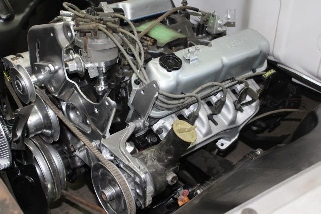

These are stock brackets on my 351 which came out of an 83 F150, they are not the prettiest of brackets but what I'm going to use for this build. I'll be using a Vintage Air sure fit kit and they generally supply any additional hardware to mount the compressor.
