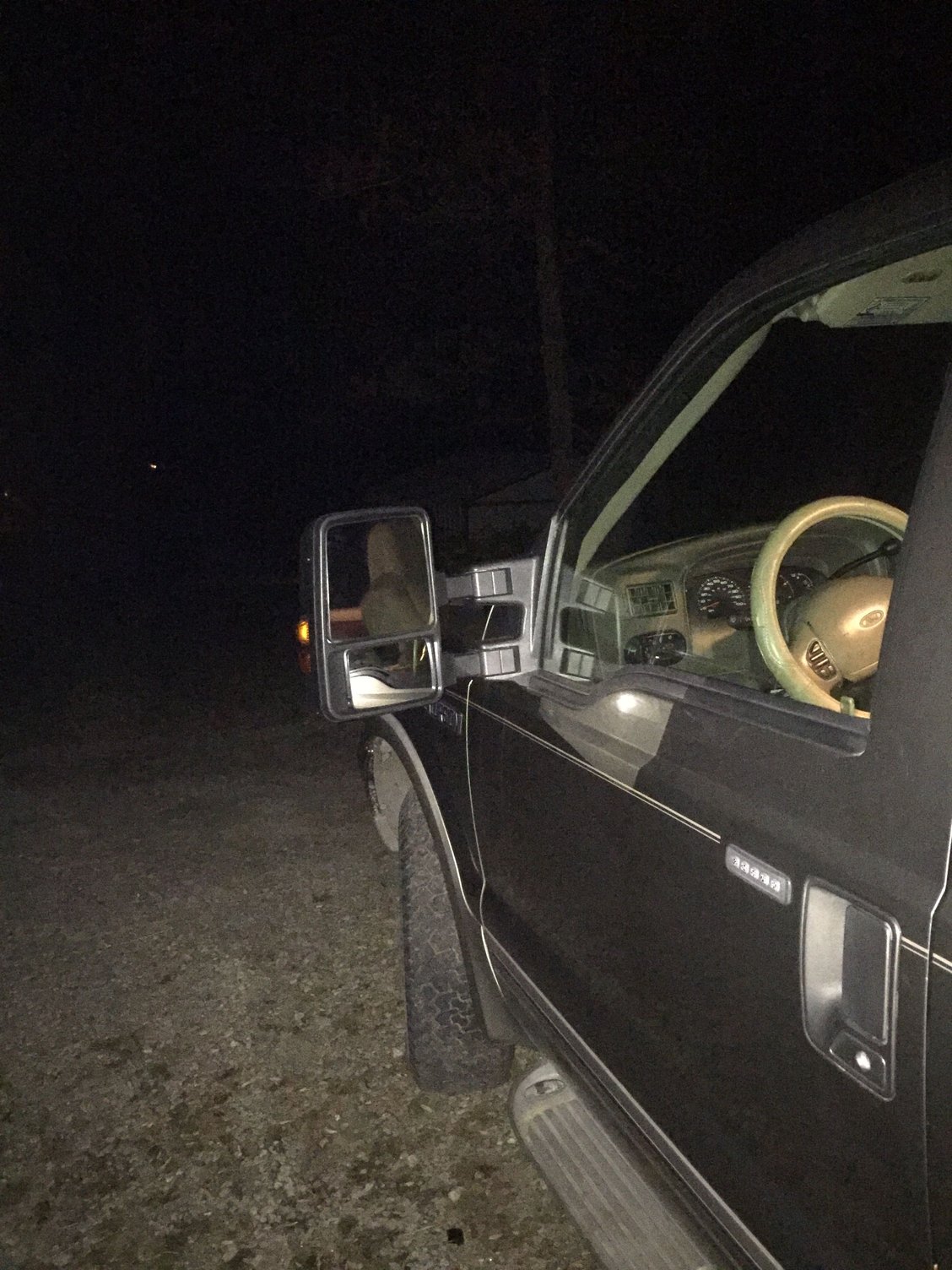

Did a few things to the X today...
Installed my new 08 mirrors! Man, these things are awesome! Got them off ebay for $155 for both, brand new. They look great with no wrinkles like I have heard about some of the ones from amazon. Didn't get a chance to hook up the running light on them yet, I will wait until the weather is a little warmer for that job. Plugged right up and worked properly. I did get a little over-zealous and broke a nut off one bolt on the driver's side, but it doesn't seem to have affected how sturdy they are. Also changed the bulbs on my driver's side running boards. The plugs are a little corroded and the rear one had some fresh water in it that I dumped out. Then I let it air dry a while before plugging the new bulb in.

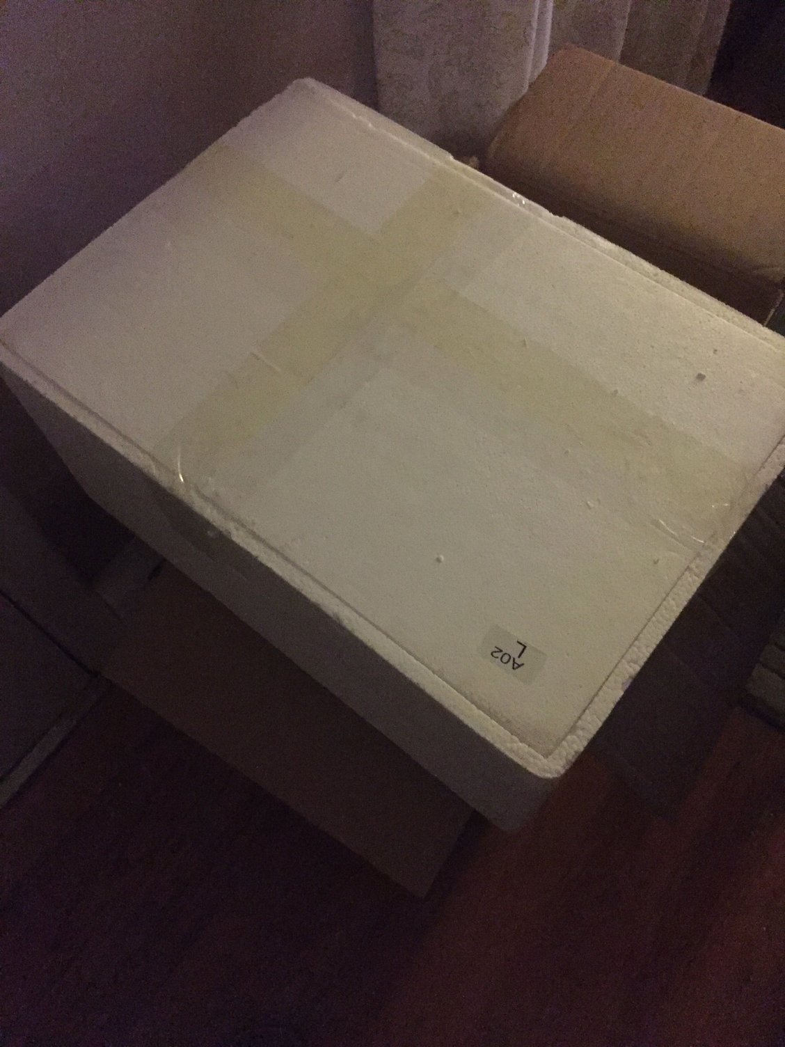

This was one of the mirror boxes.

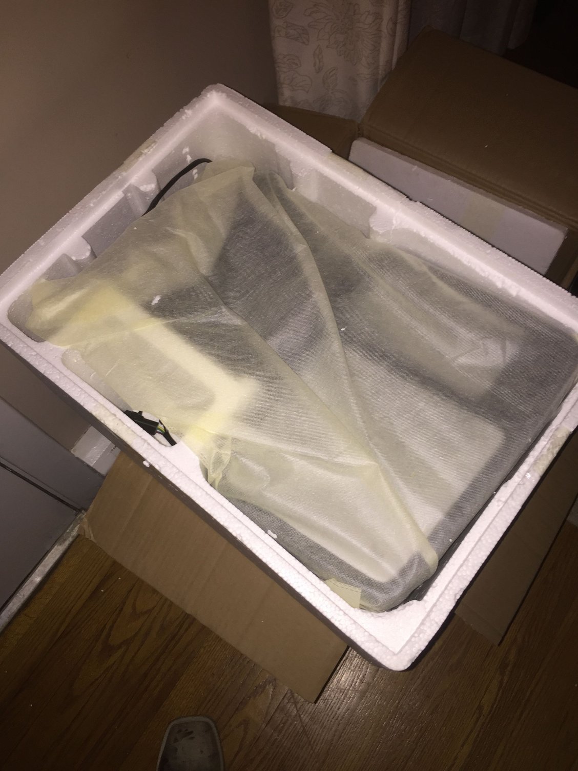

Mirror packed in nicely.

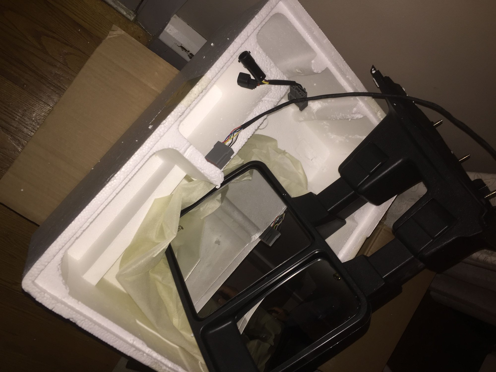

Notice the rectangular plug to match the factory plug. Also notice another pigtail that came in the box...I guess that is for an older model X?
Bigger is better!

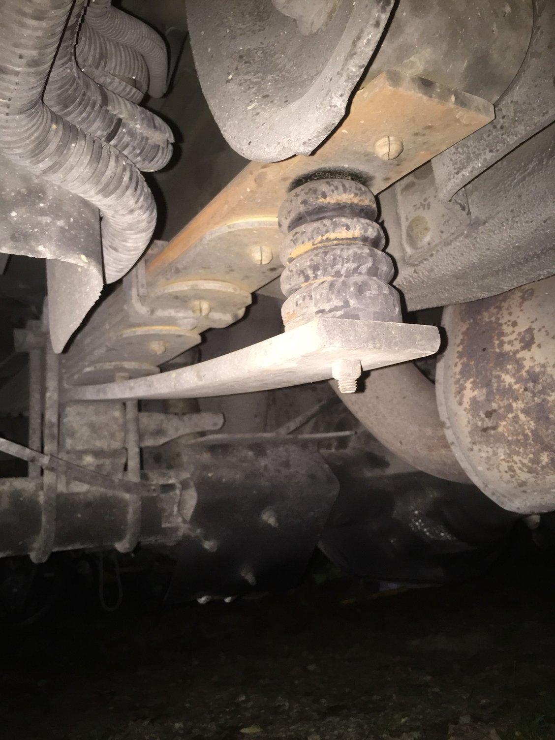

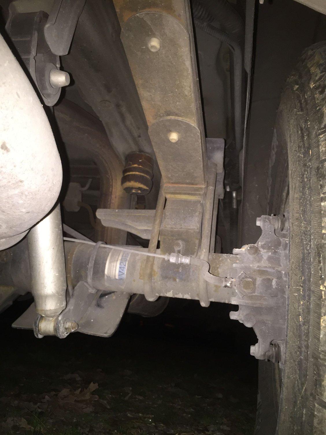

Also, I took some pictures of my rear spring pack. I'm not sure if this factory. Looks like an add a leaf with some rubber bushings attached. Anybody seen these before?
Front side of right rear spring pack.
Rear view of right rear. Notice the overload rubber springs.

The long metal piece with the rubber snubber Is to limit axle wrap during hard acceleration

So...is it factory?

Yes.

Yes, it looks like everything is factory stock on the rear suspension. Most of the stock EXs have chewed that front rubber snubber away by now, yours still looks pretty good, your Ex must have lead an easy life!
