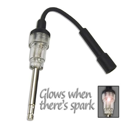

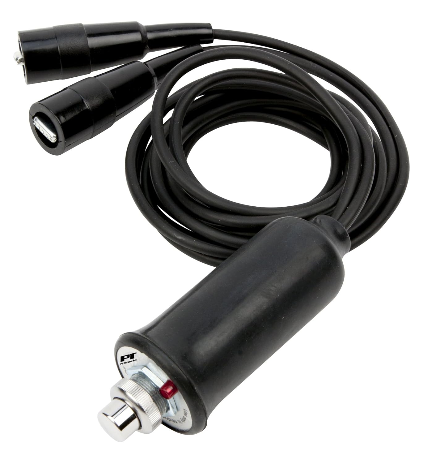

Suggest conduct a quick timing check to determine if, or, how far it's off. Couple cheap tools I like to use; a button type remote start>http://ecx.images-amazon.com/images/...L._SL1500_.jpg and an inline spark plug tester:http://ecx.images-amazon.com/images/...bL._SX425_.jpg Rotate engine, immediately stop when #1 fires and check position of rotor; if 180 degrees off then go thru 1 more cycle.
