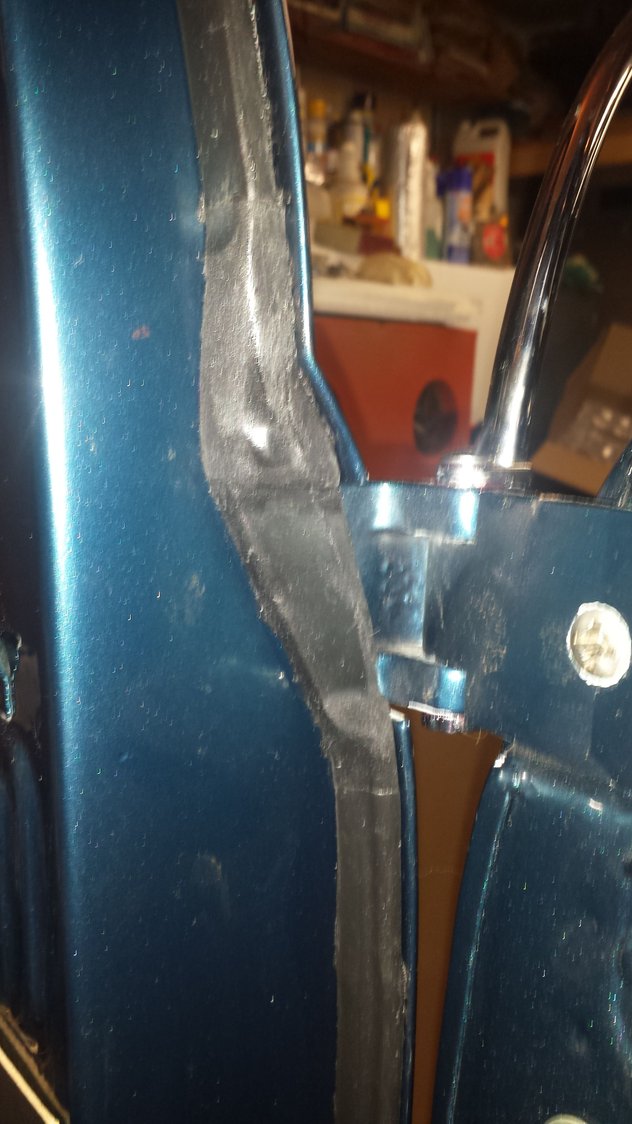

OK, here goes. I can't say for sure they are hollow but that is what I was lead to believe.
[I]Closed door.[I]
Upper hinge.
Lower hinge.
Latch area

Thanks so much for the pictures Rich. Nice clean install on the seals.
Those look exactly like mine. I might have to call soffseal and ask if they are hollow core. I don't want to buy another set like the ones I have.
Thanks again for all the pics. It helps to know they did a nice job around the hinge areas. If they are hollow core I am sold.
Rich

These were recommended by my Body and Paint guy after we tried another set. We couldn't even close the doors with the first set. The hinge areas are pretty solid but the rest is much more spongy like newer car seals.
