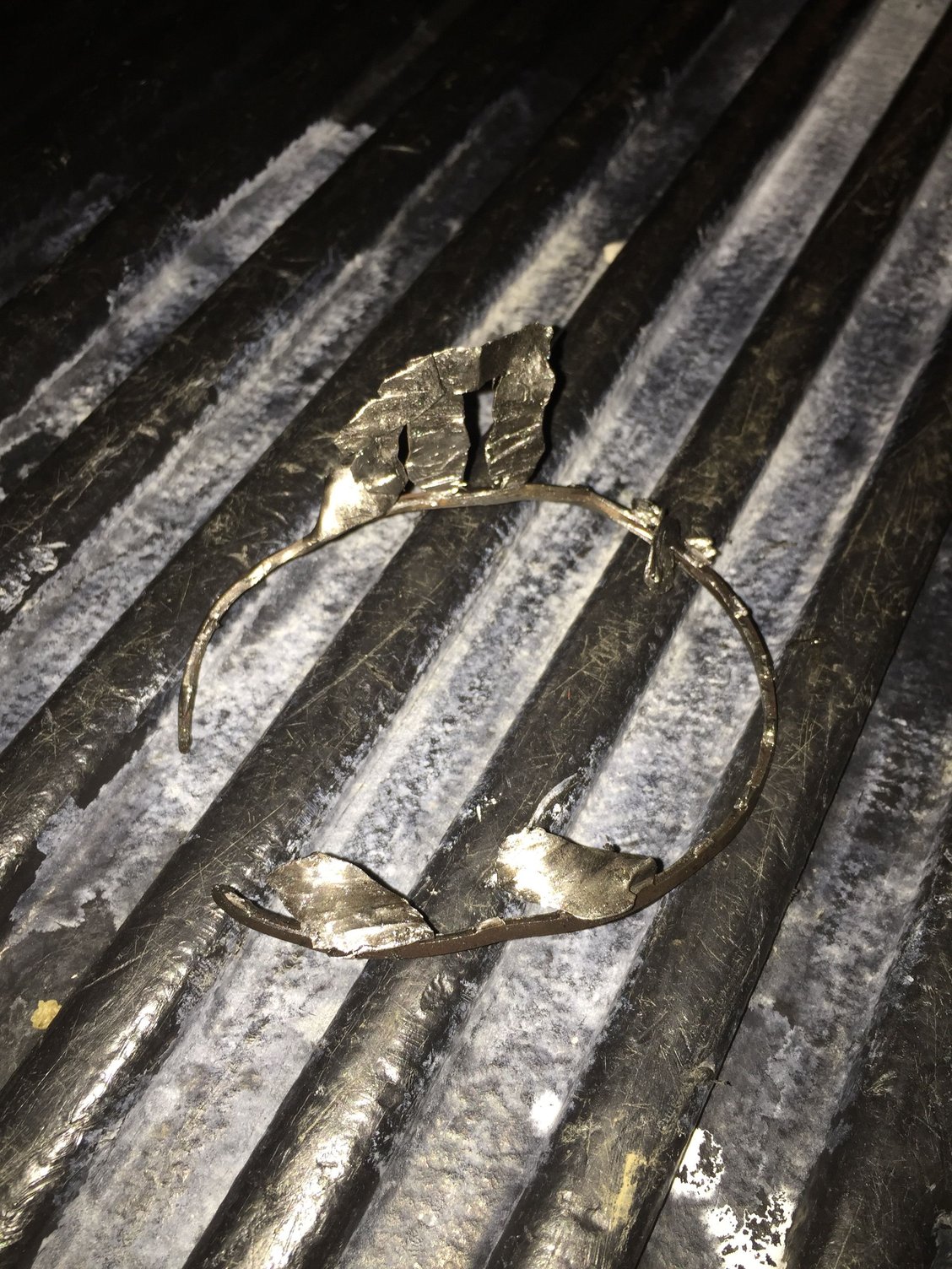

I have a 2000 Ford F350 4x4. I have been experiencing some issues that started about two months ago. At first, whenever I would hit a bump I would get a short vibration, similar to when you hit rumble strips on the highway, which the went away when you either hit another bump or flicked the truck into 4 High. This problem disappeared afer a week or two. Then I began hearing a whirring between 5 and 30 mph. I replaced the drivers side wheel bearing, and nothing changed. I began hearing a grinding noise in the drivers side, like when a backing plate is scraping. It got increasingly worse, and three days ago I hit a bump and heard a loud grinding noise in the front end, and the left front wheel locked up (hubs unlocked, 4x4 engaged). I turned 4x4 off and have a consistent grinding noise.
Yesterday I jacked up the front end and spun the passenger side wheel after discovering the universal joint on the axle shaft had gone bad. Whenever I spun the wheel, i heard a grinding from INSIDE the differential.
Today I removed the differential cover to find that I had no gear oil in there. At all. I have had the truck since July and HAD oil then, and found no leaks in the seal around the diff cover.
I did however find this:
It doesnt look good to me. Does anyone have any idea what my differential shredded? Everyhting looks ok, apart from a thin film of fine metallic dust.

Looks like a shim got left in there by accident or crush washer. If you have no gear oil it has to leak out somewhere so there is a bad seal somewhere
Can you post a pic of the spider gears and pin

I believe it is the pinion bearing that was shredded. Here's what I found
I will roll the truck back and post a picture of it as soon as possible

Yeah that looks like the cage for it. Well what's left of it. Pull the front driveshaft. I bet there is a ton of play on that pinion. That's a better pic too. Most likely you lost the seal lost the oil and finally the bearing cage

You'll need to redo the front gears. Everything must come out. You can reuse the gears but might as well get new R&P. You'll need new bearing and seal kit and clean all the metal out.
Keep the old shims as a starting point to set up new gears

Basically you'll need to
Pull wheels off
Pull hubs and axle shafts
Drop differential and ring gear
Remove driveshaft
Pull pinion gear
Replace all seals and bearings at the differential and pinion.
(If it was my axke I would pull the whole axle out set it on a set of stands and rebuild it all from end to end)
Set up the gears. This will require knowing how to install gears and setting up the correct pinion depth diff carrier and backlash and preload. It's a pretty involved process . If you have never done it you'll most likely need to take it in. Unless you know how to read a caliper and a dial gauge (don't mix up your bearing caps. Mark them left and right.)
Cost will probably be around 900-1100 bucks parts and labor at a shop. Maybe cheaper if the dude isn't busy and needs money.
The reason you need to redo the bearings is because all these metal shavings along with no gear oil pretty much destroyed the bearing surfaces on the axles.
I guess you could disconnect the front driveshaft and just not run in 4x4 just keep hubs in Free setting.
Wanted to add. You will need a hydraulic press to pop bearings off and install new ones

It also looks like the lock bolt for the round pin is missing...

That could be what took out the bearing.
