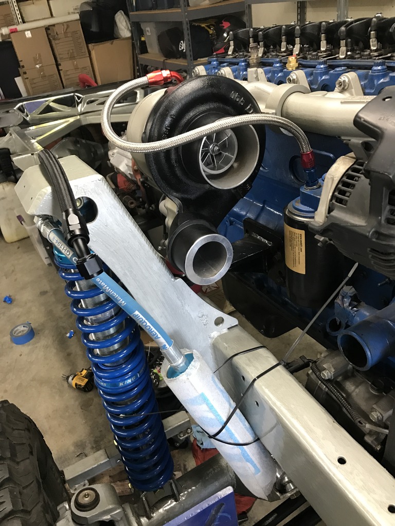

I have sorted out the steering dilemma,
I decided to go with a steering gear box off of an 06 Dodge ram 2500. the power steering lines and hydroboost are pretty much setup, the master cylinder and slave cylinder are mounted, and the steering shaft and u joints are ready t be installed, i am just awaiting my ididit steering column to show up (ordered it 2 months ago literally...)
The mount for the steering gear is incomplete in this picture, i am not leaving it as a square piece and will cut it down to look nicer then weld it to the frame.as well as brace that top piece of the mount so it has no chance of moving.
The Powersteering cooler and intercooler are mounted temporarily as i have to change some things to get them aligned right.. OH and i did happen to find a good radiator core support along the way!
