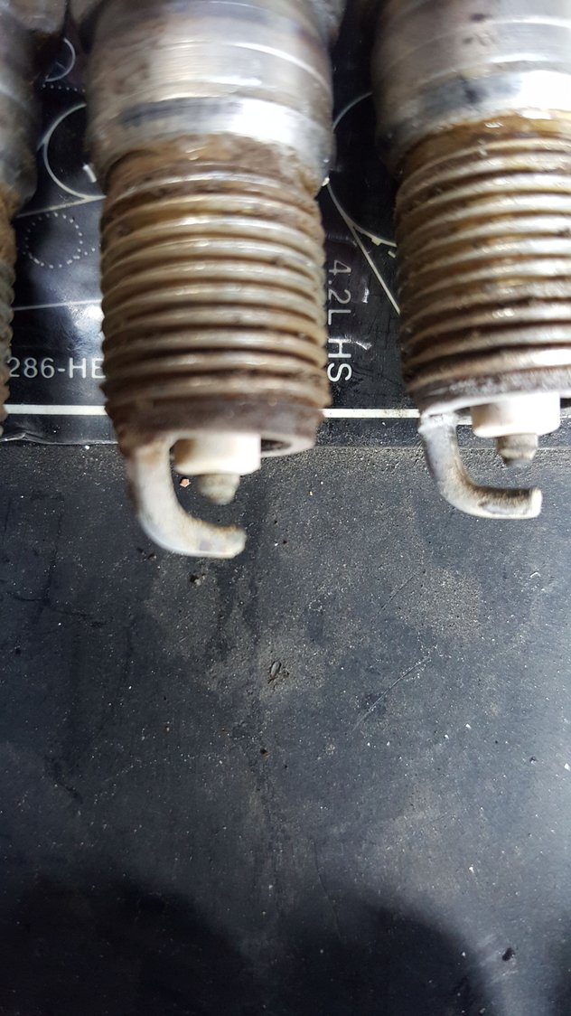

Pulled plugs today. In prep for compression test.
Most looked like picts above and below this one. This one looks diff. It is rear most pass side.
The rest look like this. They are about a month old.

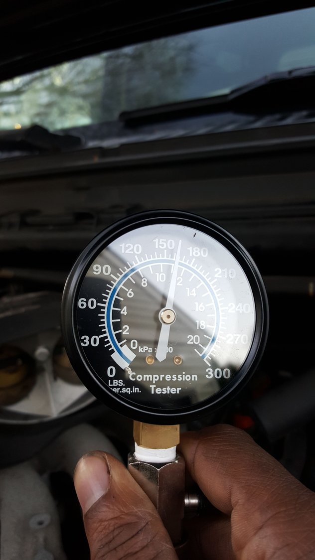

Thanks for the info here is my procedure.
Remove filter
Remove all plugs and coils. Disconnect all fuel injectors
Screw in guage hand tight and turn her over a couple times.

160 !!! Should be a good #.. Now, where are the rest !!

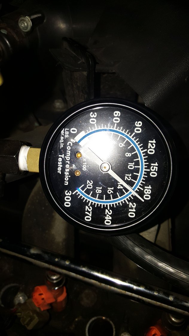

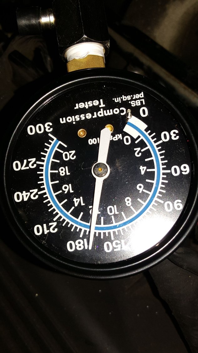

Got this
And this in two adjacent cycinders is it ok?

The rest so far are around 175

A spread of 20 is what you're looking for. Low numbers in adjacent cylinder cylinders could indicate a leaky or bad head gasket amidst other things.
Don't go for that junker motor. If this is the only issue yours is having, you can be up and running for less than $300 parts and fluids.
