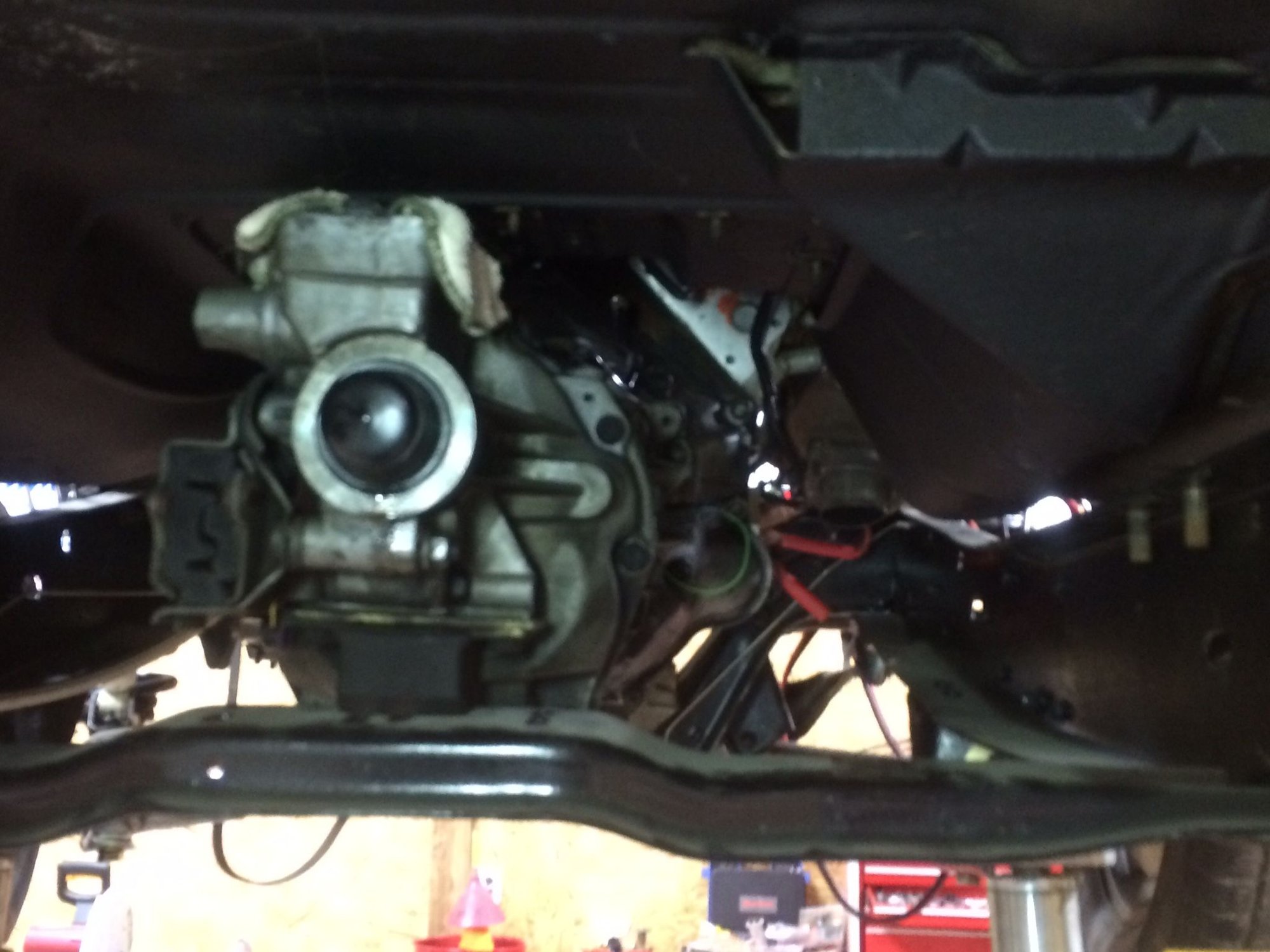

Here is the t 56 6 speed trans
I wanted to keep my bench seat so I put a front shift conversion in the trans

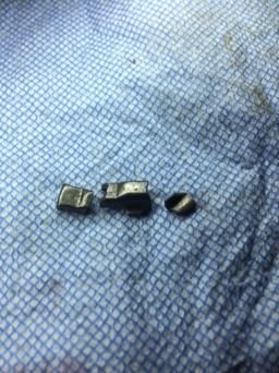

Found some broken synchronizer keys so I up graded to the billet keys while I had it tore down.
