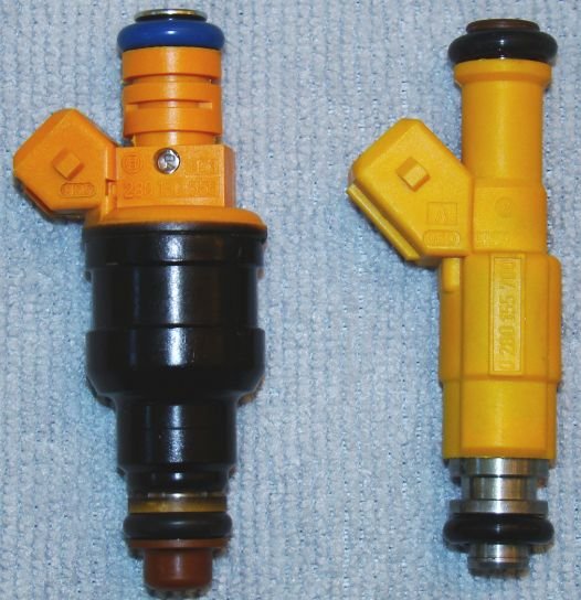

Left is the Single hole (Bosch Type I/II design - Those Ford Motorsports are this style.), right is the 4 Hole (Bosch Type III) style.
That particular color is indicative of a 19#/hr injector. If you're not reburning the PCM, stay with the 19#.

There are improved, wide body #19lb injectors, w/4 hole spray pattern. They were introduced around '92 on V8 engines. The latter slim body designs, actually flow just a little less than their wide body counterparts. I did research on this 2 years ago. I may even have a thread, but I don't know where its at.
I have also read that the wide body injectors don't heat soak as bad as their slim body counterparts. Due to the metal case they are surrounded in.
Also, the slim body #19lb injectors do not seat well in the lower intake and also do not project farther into the lower intact for a better spray pattern. The spray actually can hit the sides of the upper intact following into the intake side of the head, combustion chamber, and you get half spray, half dousing/saturation.
Not trying to contradict anyone's finding, just my research and observations.

They seat ok, but their wide body counterparts have the top hat, and actually sit around a 1/4 - 5/16ths into the injector hole. The spray is the same but its not as recessed, protruding further into the lower intake manifold injector housing.
When I get home, I will use a '92, 302 truck intake and take pictures. I have used both and can't say if they made a difference or not. I will try to dig up the thread from a few years ago on the research on the injectors.
May even Google the engineering # and it will show you the flow rates of dozens of different injector's.

I took measurements for the wide body and the slim body injectors for depth into the injector hole in the lower intake.
Wide body #19lb. Injector
The wide body injector measures .0625 from the edge of the lower intake.
Slim body #19lb. Injector
The slim body injector measure 0.883 from the edge of the lower intake.
Now, also note the difference when both are inserted into the lower intake injector holes.
If I find the link for the flow rate difference, I will post it.
EDIT: I spoke wrong of the wide body injectors not being succumbed to heat soak. It's the other way around. The slim body injectors don't have this problem.
Also, the flow rate of the wide body is 230cc @ 3 bar
Slim body is 210cc @ 3 bar

In that last pic it sure doesn't look like they fit all too well. I wonder if the fit is the same in the newer Explorer etc.
