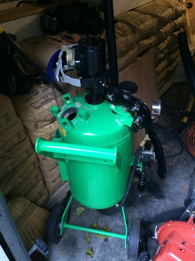

It depends on the nozzle you use. I'm using the smallest nozzle - the SLV-3 instead of the SLV-5 - and my 30 CFM compressor is able to keep up.
Nah, I couldn't recommend the DB-150 to the average home hobbyist. Too expensive if you only plan to ever do one or two vehicles. There are cheaper alternatives that work fine. But, it should hold a decent value, too. It does work well and I use it right in my driveway. I connect the compressor to the blaster with a 3/4" I.D. air hose, the yellow hose, and the black hose is the blast hose.
I keep it near the doorway and have all the media stacked behind it next to the pony wall. It doesn't take much to set it up and start blasting.

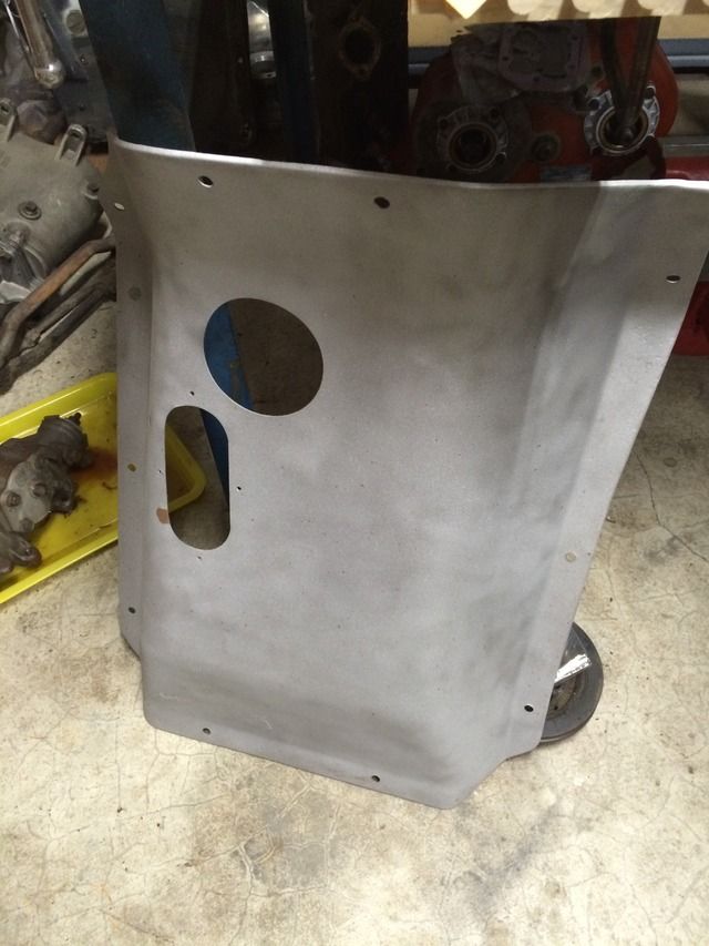

Here's a fender and transmission cover plate I did the other day. It's great because unlike soda, which doesn't remove rust very well, this thing eats rust, undercoating, powder coating, anything you put in front of it. But the blast is easy to control and has a decent demarcation line so you don't overblast as much - and, of course, no dust.
