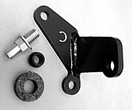

No.. not all SBFs have it.... The drilled/tapped boss was omitted in like the late 80s when they went to clutch cables. There is an aftermarket bracket available though....
I don't think any roller blocks have the boss. Contact whomever you're gonna get the crate engine from and verify?

The threaded hole on the left rear corner of the 302 blocks, for the clutch equalizer (Z) bar pivot stud, went away beginning in 1974.
See images at bottom of page 16.
https://books.google.com/books?id=dc...%20302&f=false
You can get a bracket that attaches to the bell housing bolts that has the pivot stud attached to it.
Pivot bracket vendor.
Classic Mustang Equalizer Bar - Z Bar | FREE SHIPPING
