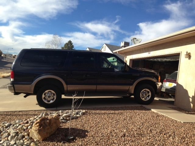

Thank you all for your input, it's much appreciated. The PO had air bags installed, and used it primarily for towing a boat. They did not have the Helwig sway bar on back, I added that. As for wander there isn't much and the ride seems pretty solid. Is there a way I can tell if maybe the PO installed different springs?
Are there any identifying marks on the springs. I swear my EX looks taller than most looking at pictures of rigs not modded.

Check out this thread and take your measurement to confirm where you are ride height wise. https://www.ford-trucks.com/forums/1...easurents.html
A picture or two of your springs will also help us to see if they appear to be stockers or something else.
Nice looking EX.

(Not completely Level)
Front 22.5/23.5
Rear 25/25 (air bags might be fuller than i though)
Front Spring Code
Rear,Front view
Part Number
Rear, Rear View

^ Both are stock, the fronts are 350 lbs/in, the rears are 380 lbs/in. The later Excursions had 410-430 lbs/in in the rear.
Not all Excursions wandered, mine did but it wasn't spring related. Between greasing the ball joints, front end alignment and adjusting the steering box I resolved my wander issue. It's not always that easy. I did upgrade my springs because I didn't like hitting the front jounce bumpers any longer.

Rear springs look to be stockers along with the factory EX blocks.
Try contacting Rob Ross for help deciphering the spring numbers, he has done some great detective work with them here.
