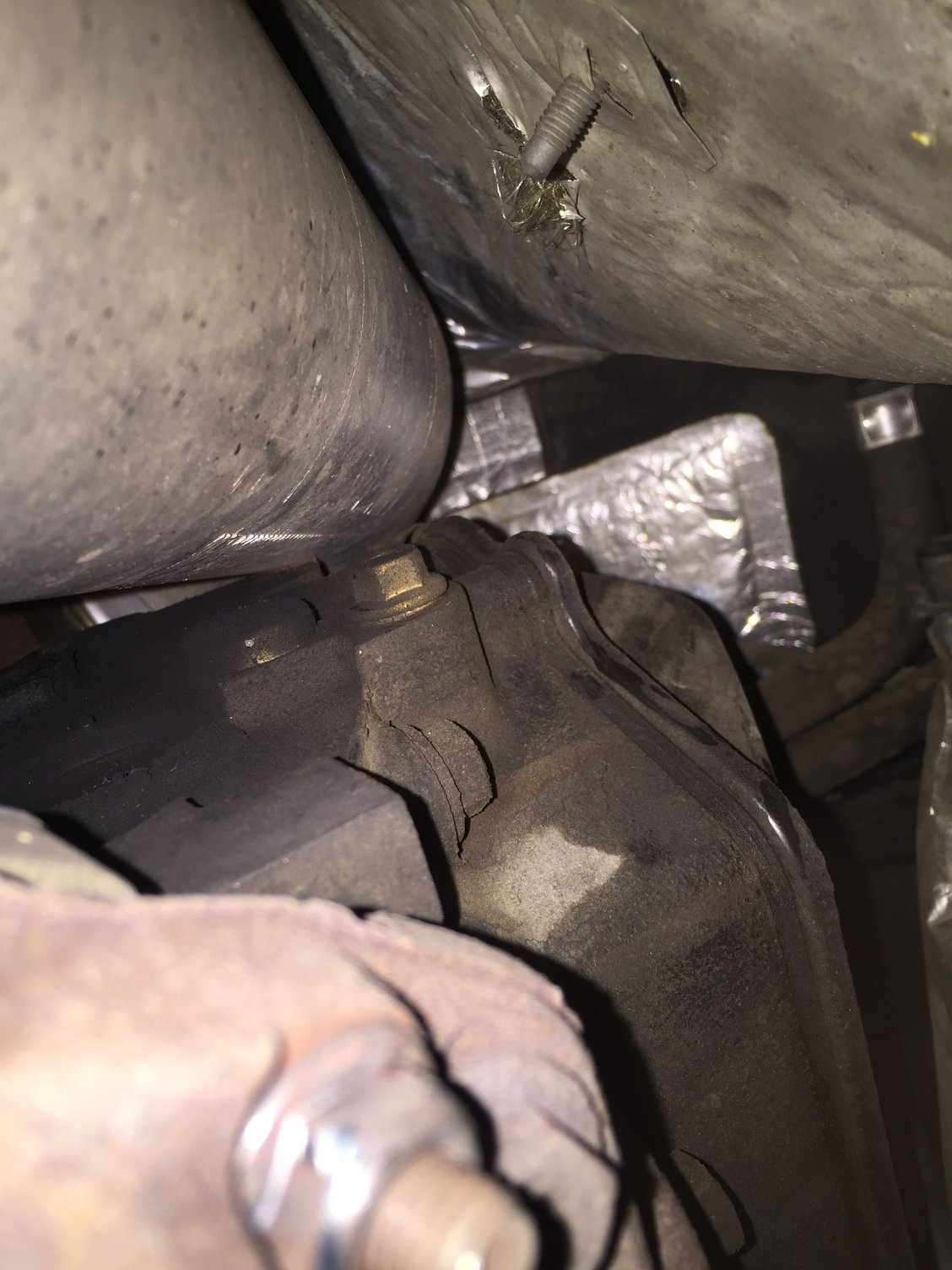

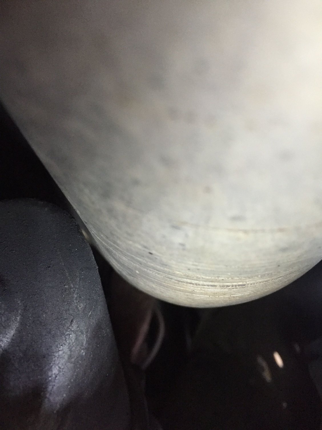

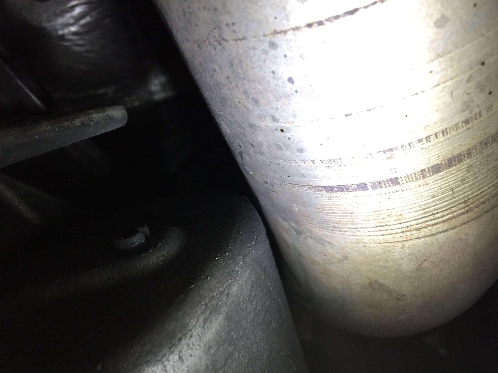

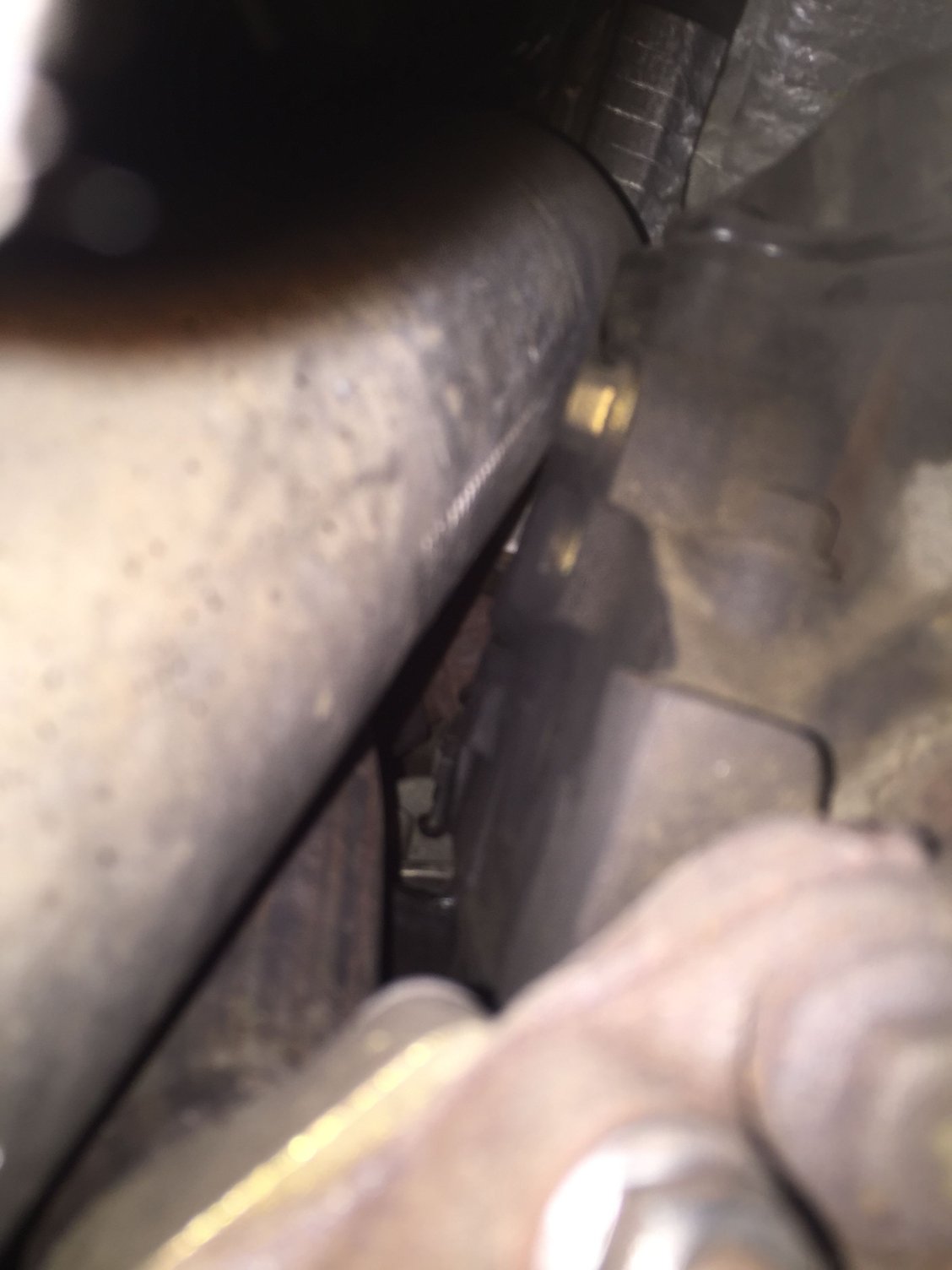

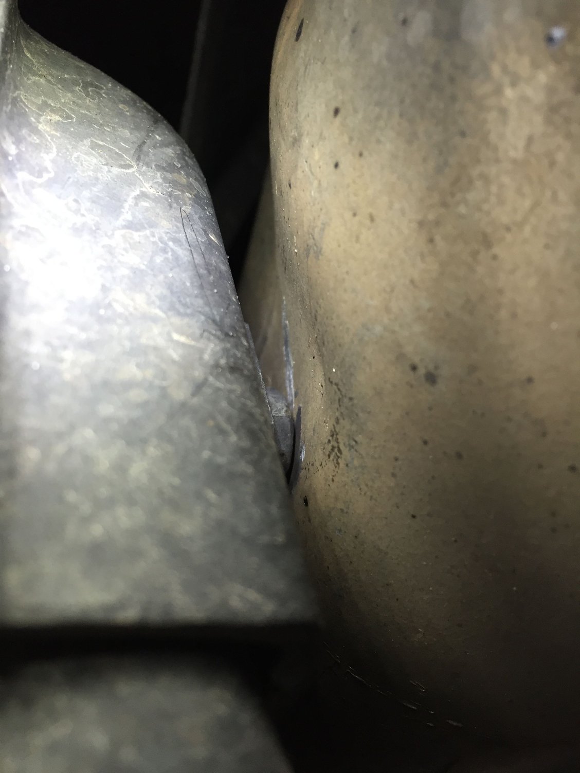

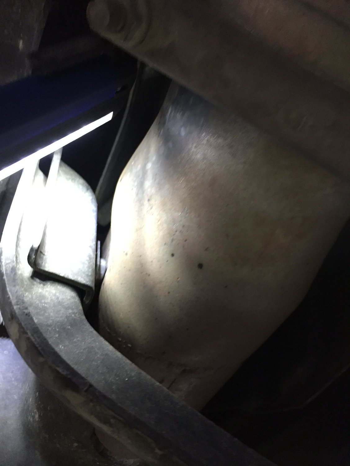

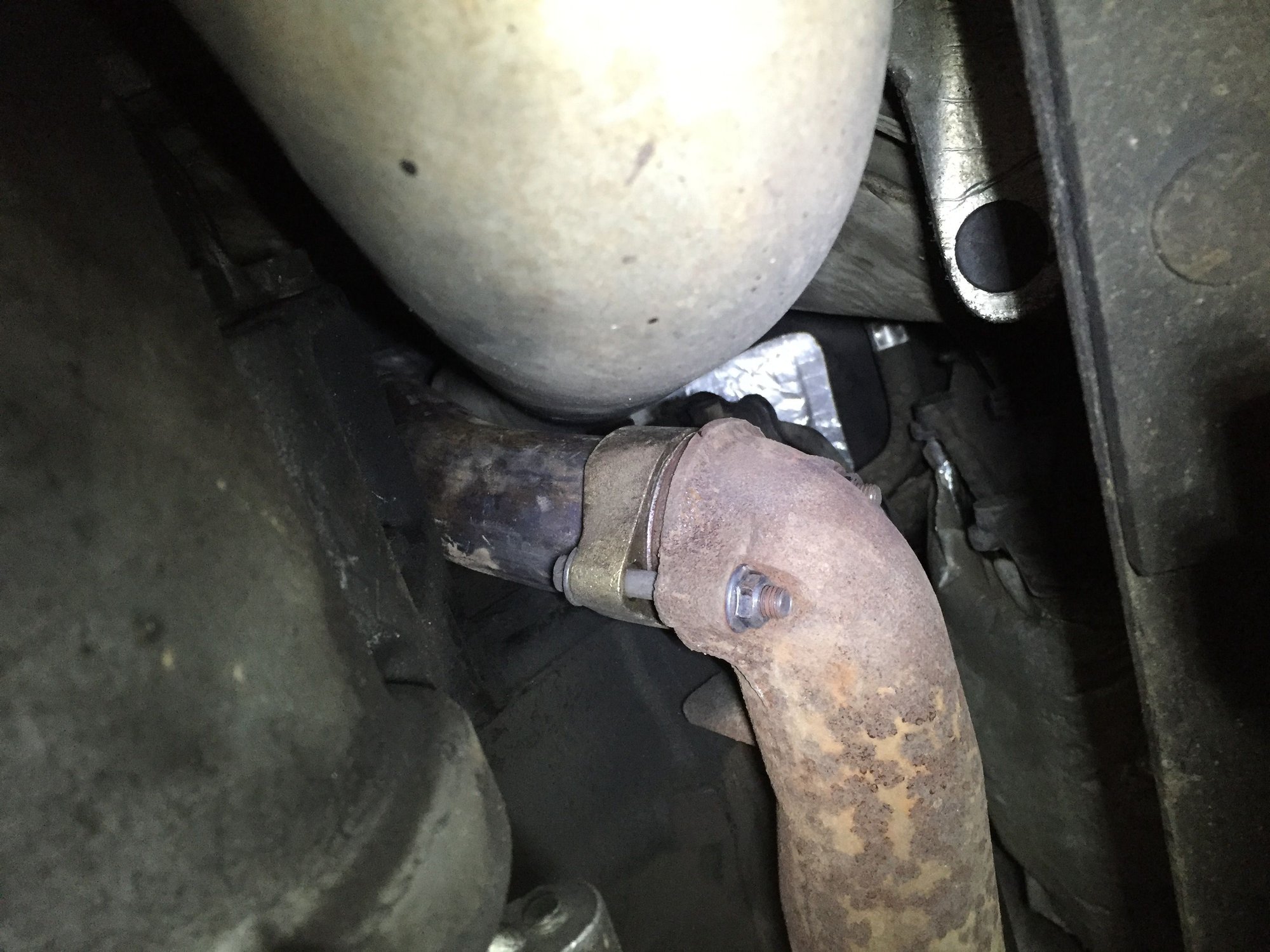

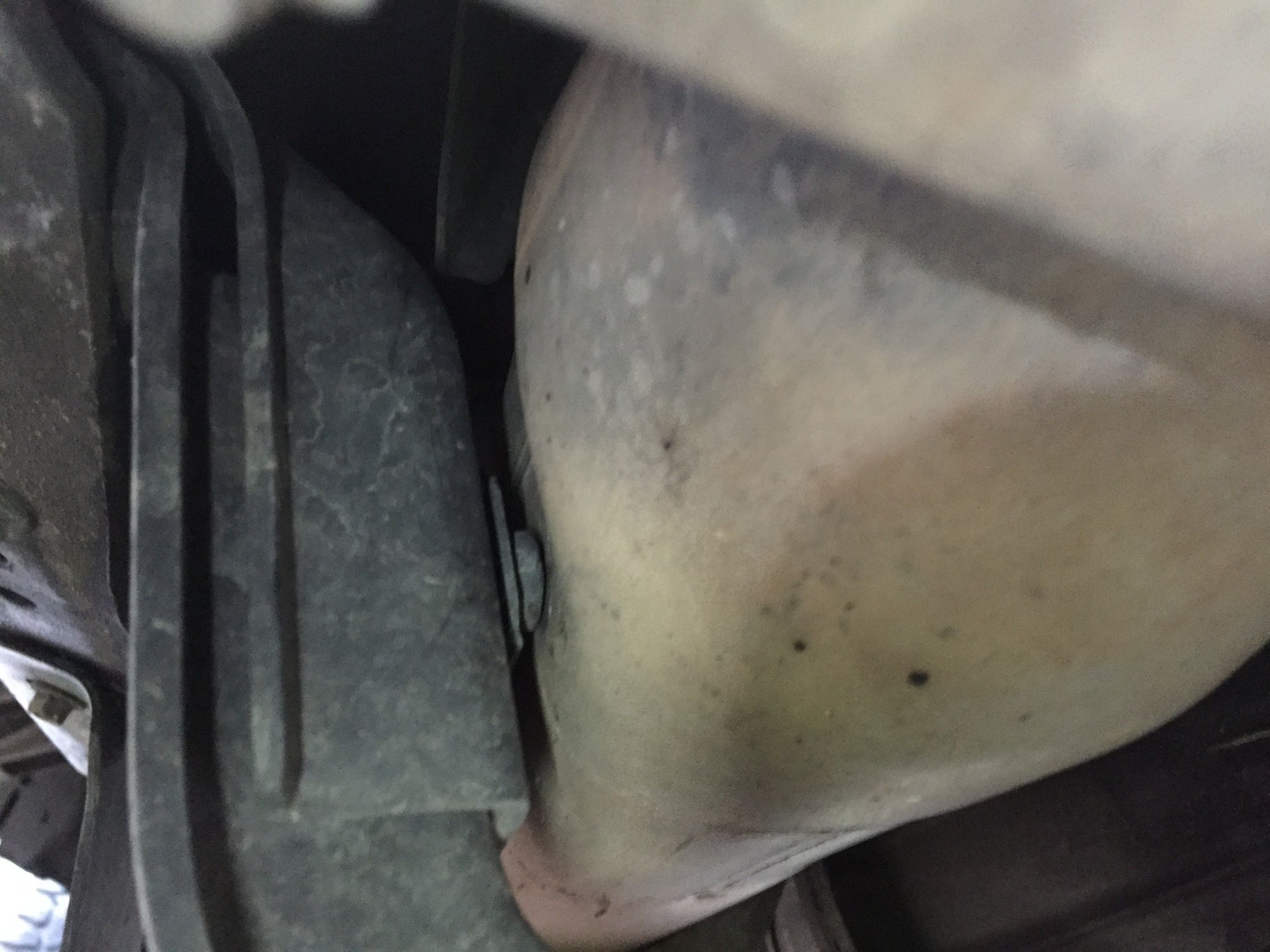

Here's some pics. It's definitely hitting at tranny cross member. But if I shove it yhe other direction it's going to hit the starter housing.

On the 6th and 7th pic it's not hitting. Just barley clears. Bad camera angle
