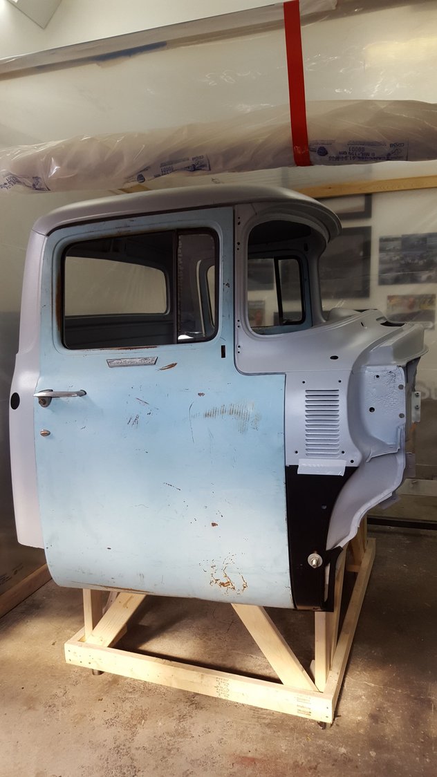

Put a new floor in and have the doors mocked up and somewhat fitted. Gaps are decent.
I fitted the front cab corners already(they were easy)
Rear cab corners don't seem like they will be as easy. Maybe that will change once I start cutting them to fit.

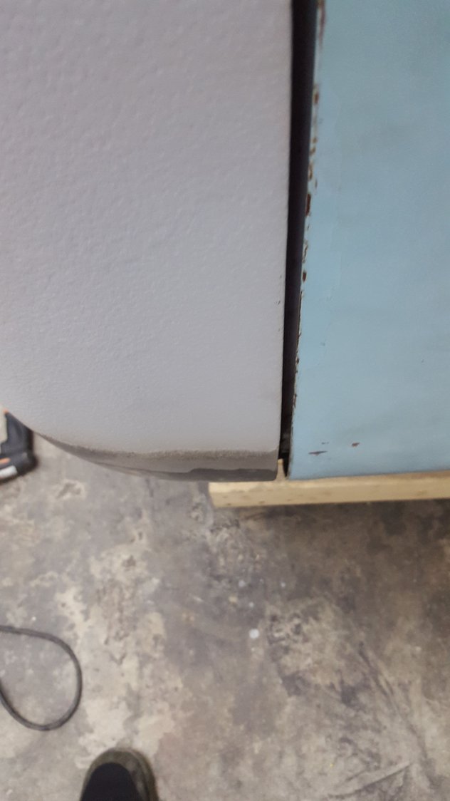

Rears are tougher but nothing overly complex. Just a little tedious as you make the panel fit the cab and lower door but that's just bodywork. Your skills appear fine from the looks of those door gaps. I fit my panel to doors I later replaced. It seemingly never ends.

looks real good from here.

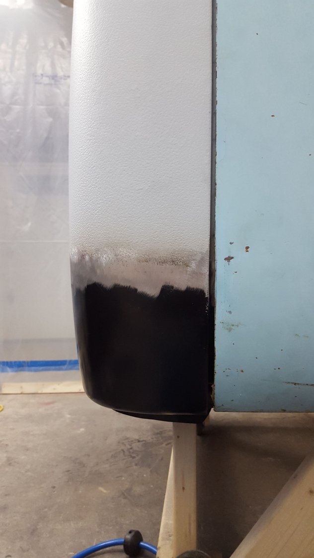

Started the fronts tonight. Definitely more tweaking needed

Looks pretty good to me.
