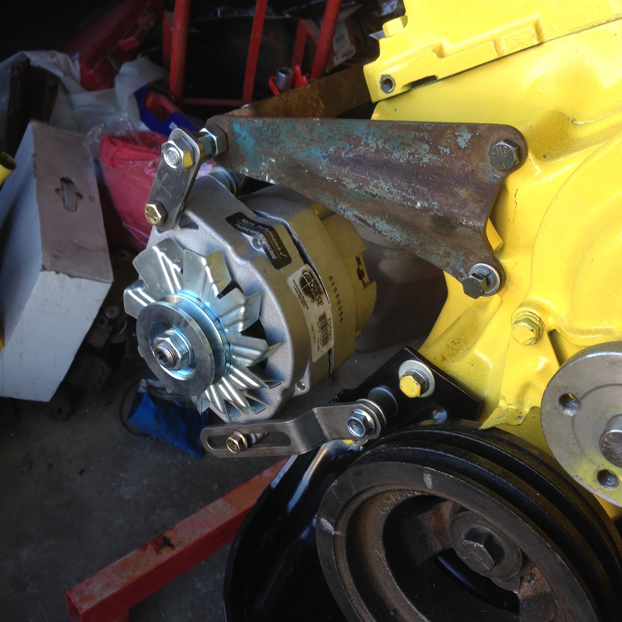

My ole 272 gave up the ghost and blew a head gasket a couple of months ago. So since I had a 292 "extra" I decided to build a new motor. While doing all this I decided to add my Flat-O adapter and C4 as well as Toyota power steering and a 3 wire alternator. I researched the alternator install and found an easy affordable way to add a alternator using the generator brackets. It involves a piece of 7/8th threaded rod and a couple of pieces of 1" steel. Installation was pretty straight forward.
The added pieces of steel installed on the original brackets.
Use the original generator bracket and adjusting arm.
7/8ths threaded Rod test fit will need to be cut down once everything is aligned.
My question is what keeps the added pieces from moving? Since the engine is being mocked up on an engine stand I can't test it to see if the added pieces will stay put. Anyone done this conversion?

I would cut pieces of iron pipe to slide over the all thread so the end nuts can "lock" down against the pipe

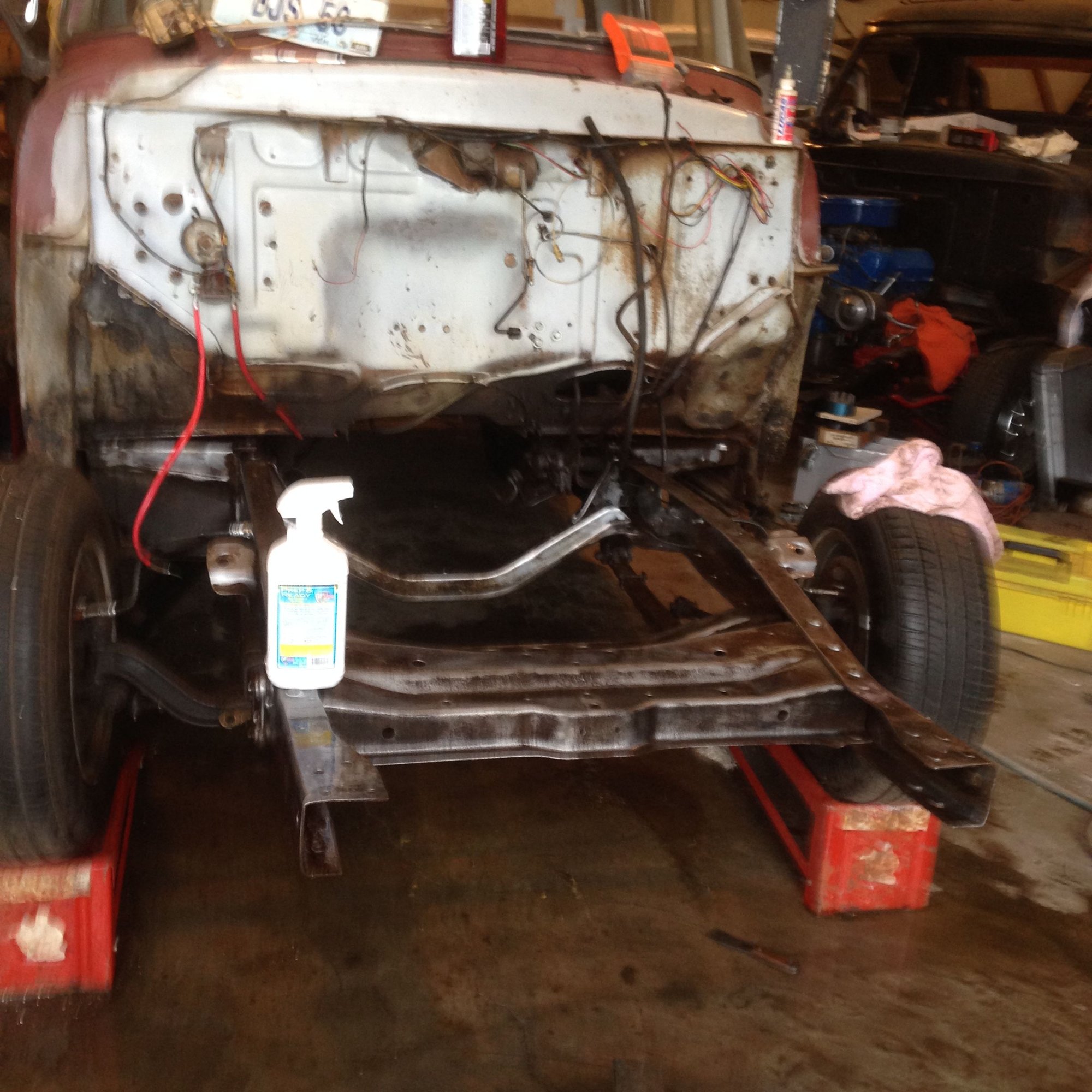

For all you Vets you'll understand mission creep! I decided to clean up the frame and paint it with POR15. I'm sure I'll think of more to do before I get the engine back in.
Marine Cleaned
About to use Prep & Ready.

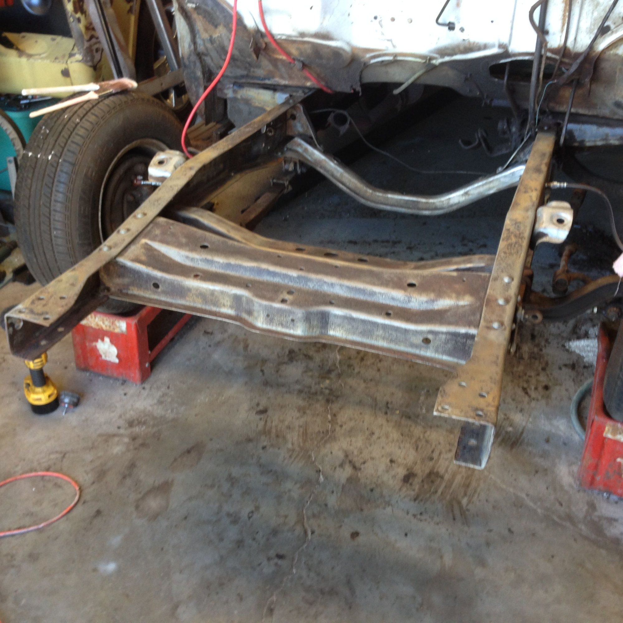

Finished up cleaning around the rear motor mounts. Time to begin applying the POR15.
Cleaned Frame.
First Coat of POR 15.
