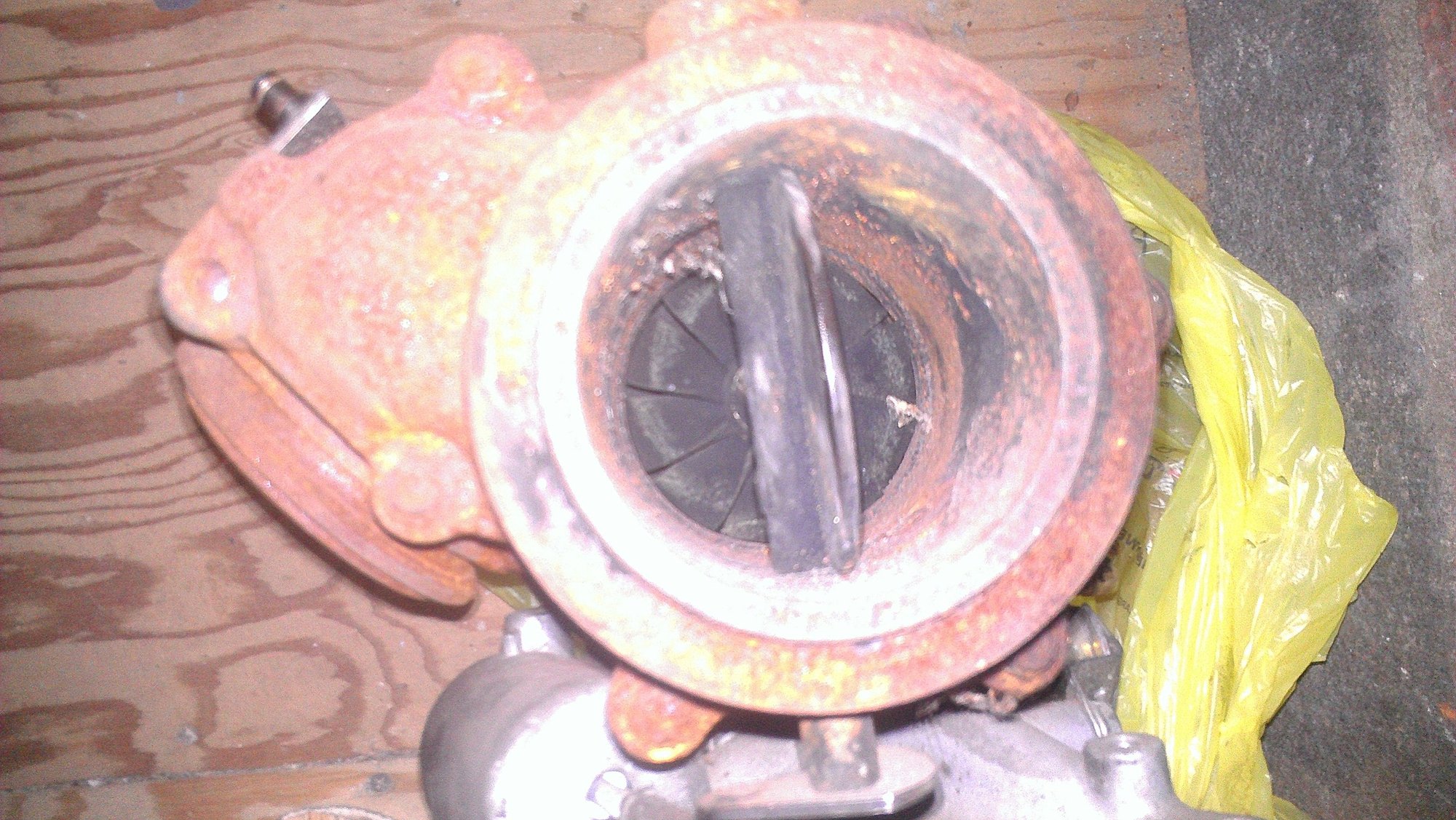

Ok I have some issues with my turbo I have a E99 truck. Now that I have been getting on it after the rebuild the EX wheel is rubbing on the housing inside. Obviously cause I have to resurface it so it would not leak(posted pics but did not get a response so I machined it). Here are my options. I have a VAN turbo as well. Now my turbo has a .84 EX and a 1.10 intake AR. My questions are.

Cool thanks for the input and information. I think with all things considered I am going to use the 1.15 EX housing as mine is junk(pic below shows the bottom right corner up at 2 o clock it was not sealing on my .84 it was shooting all kinds of soot out. Along with a few other EX leaks at the up pipes). Then add my 1.10 intake with my Riff Raff 4/4 wheel. See how this all shakes down. I am hoping the reduced back-pressure of the 1.15 will make for reduced EX leaks in all points of the head to turbo system.

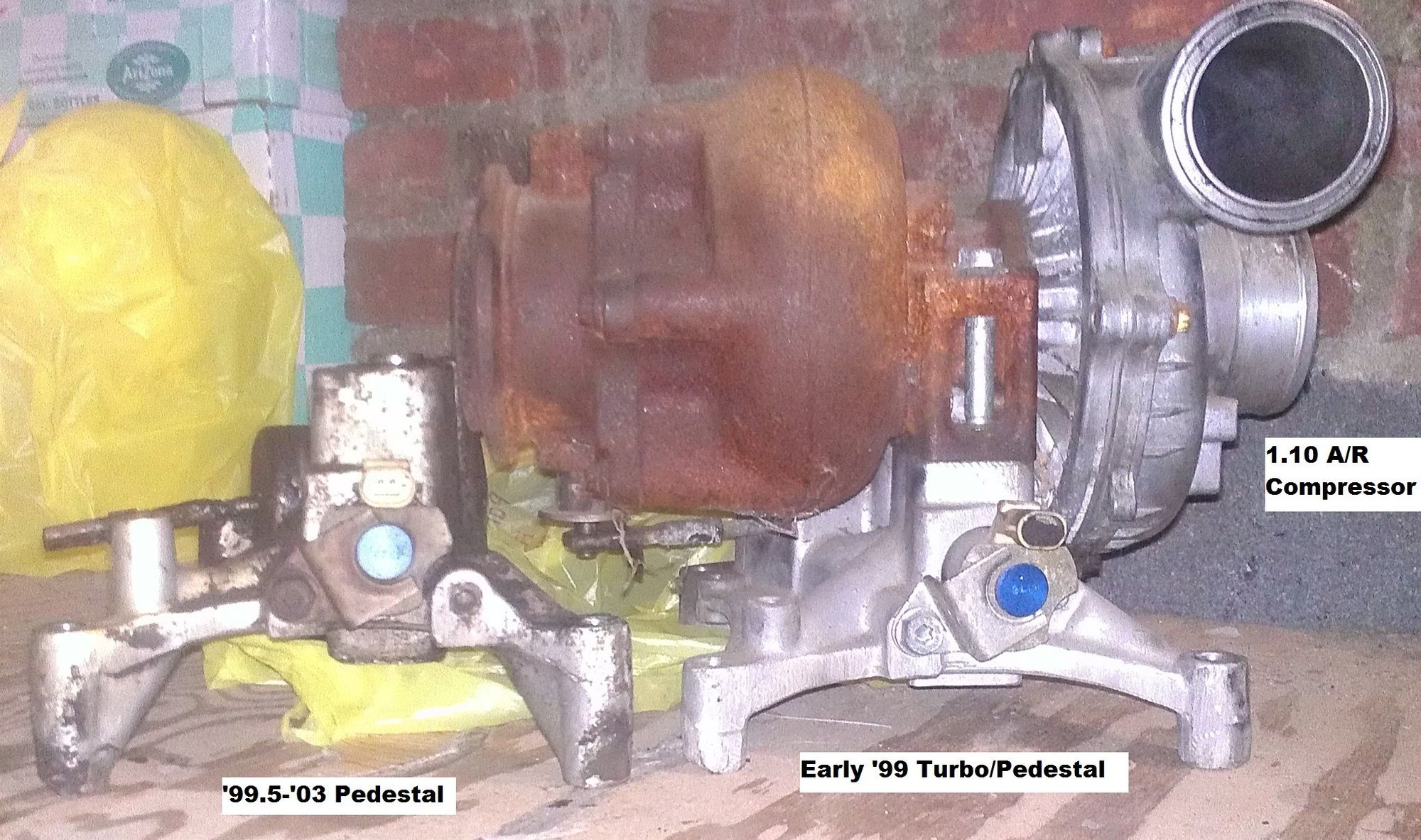

Did you also check to see if the larger van exhaust housing, and related attachments (EBPV, etc..) will clear with the e99 pedestal?
E99 (complete turbo) VS late '99-'03 pedestal

Oh, also, "hotrodfeguy", I forgot I had it, but that e99 turbo pictured above is "available". Its complete, minus the wastegate actuator ( the spring loaded canister). Minimal side-to-side shaft play. None in and out. Its clean, turns smooth, and does not appear to have any EBPV leaks. Wastegate and EBPV are "free" and move like they should. You could run it as-is. But I would throw a quick rebuild kit in it( and your RR wheel) and call it good for a long time.
