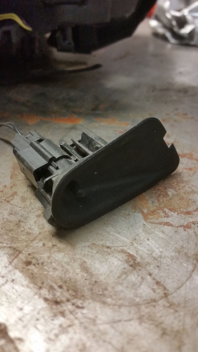

just started my truck from being stone cold ( is 10 above C here in BC) and just noticed my engine light on but no messages came up on the message center. everything seems and running fine. is there a way to get the code without having to take it to the dealer?
2012 f350 SD CC LB 114,000Km's 6.7L
One thing to not is i just replaced my outside mirrors and are identical and work fine except the new ones don't have this thingy (see pic LOL)
Would this throw a code?
any advice or recommendations???
Thanks for your help guys

its found underneath the mirror. I didn't even know it was there until I took the old mirror off and flipped it upside down. I think it has to do with the outside temp sensor as the temp reading has not moved since I put the new one in. But why that would make the CEL go on is beyond me. I was able to take the sensor and wiring out of the old mirror and will plug it into the new plug and see if that fixes things after work today.
As for the CEL I drove it home and back to work with no messages or any problems so I assume that's what it is.... will find out tonight and let you know

Just an update in case anyone is curious.
I took the old sensor from my broken mirror and added the wires to the mirror plug and seems to have done the trick. Temp works again and engine light went off the next morning.
I temporarily just zap strapped it top the inside of the door shell until i can figure out a better place for it. I guess that's what i get for buying aftermarket Ebay mirrors.... NOTE TO OTHERS: if you buy off ebay make sure that sensor is in the new ones if your old one has it!!
