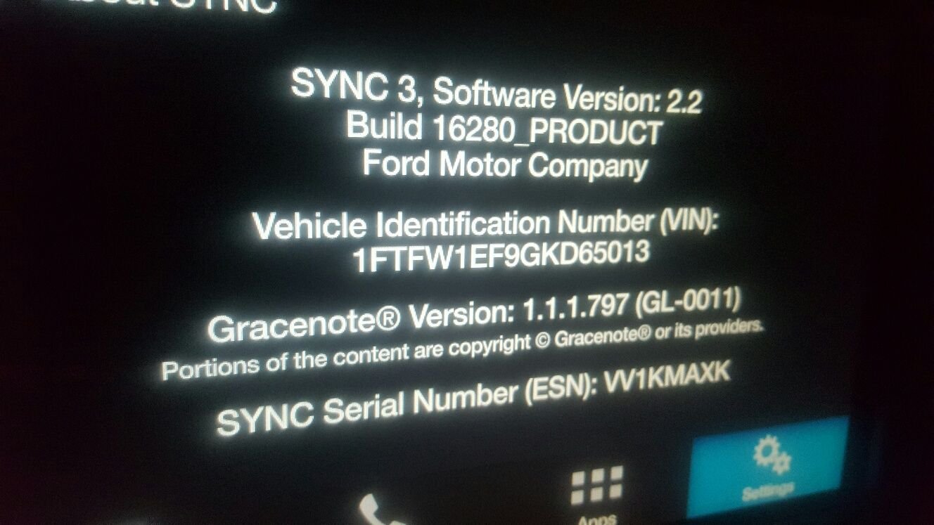

I just updated my
sync 3 to ver 2.2 Here is a photo of my screen and a link to the F150 forum on how to get the early release of the ford sync 2.2
https://web.mail.comcast.net/service...=249414&part=2
http://www.f150forum.com/f118/curren...mation-360660/

Here is a screen shot, my ford website doesn't show the update yet. This is the legal ford version that someone leaked. If you don't want to go to the dealer and pay for this...
