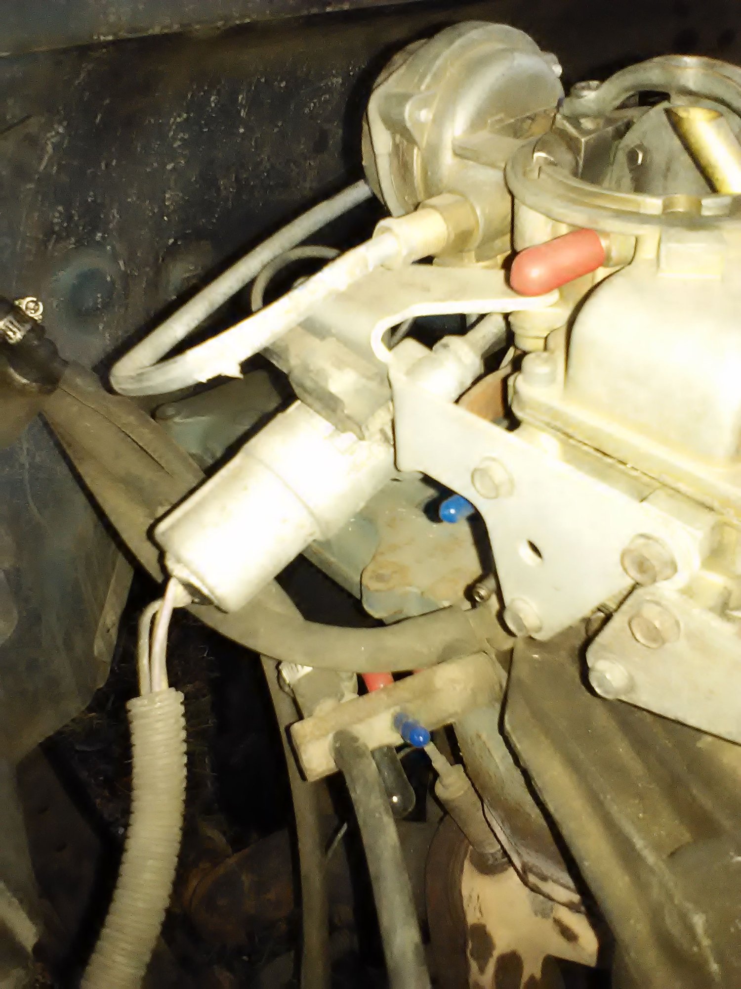

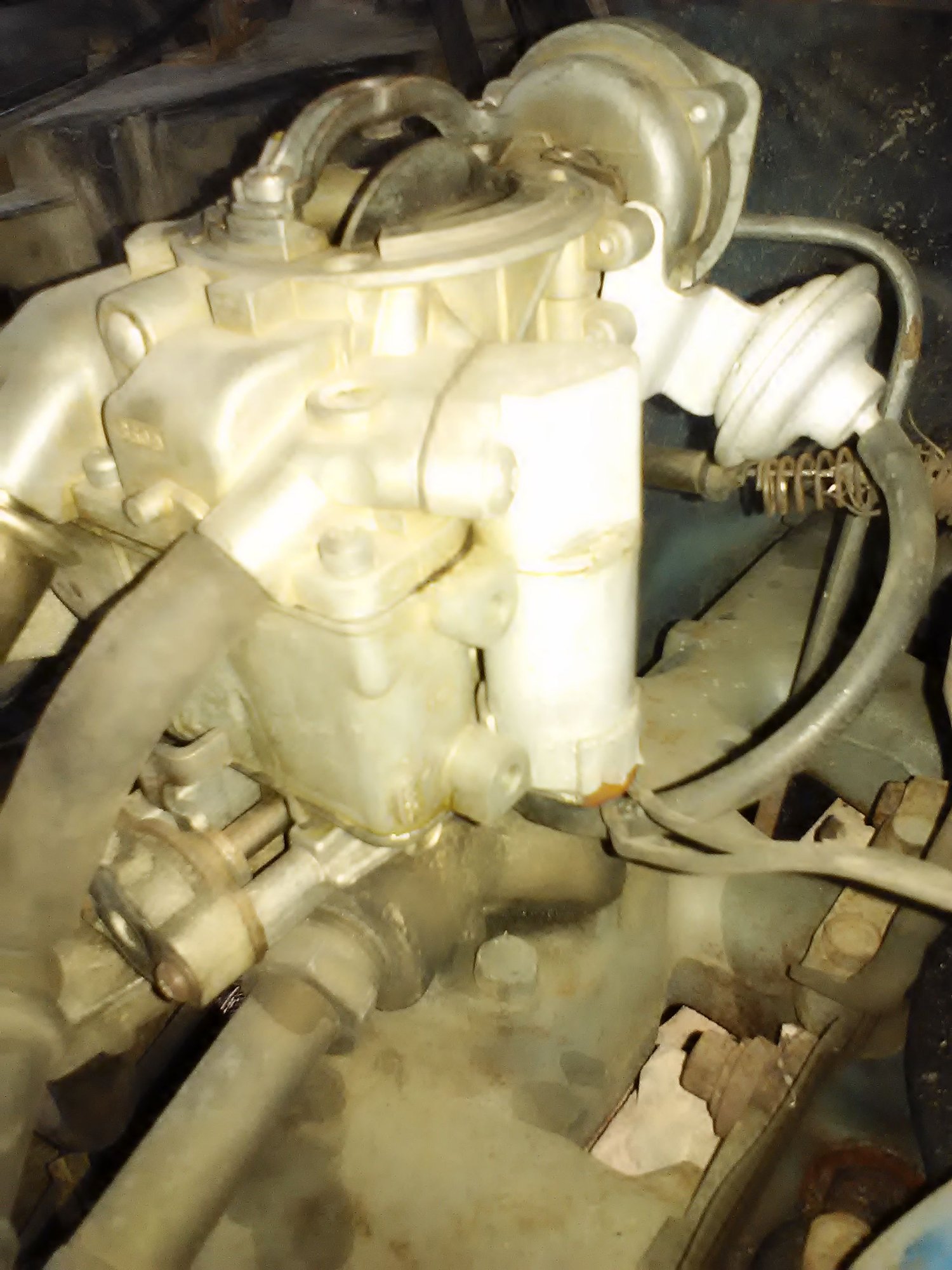

The sensors on my FEEDBACK Carb is a TPS (not concerned about that one) my FEEDBACK has an electric choke and what seems to be a ECM controlled high idle solenoid and a third sensor that I'm not sure of that is bolted on next to a vacuum port that the emissions junk is plumbed too. The third sensor is my only worry, I know for a fact the other two sensors will have no affect on the Carb with the ECM deleted.
The "hot" wires to the ECM fried along with the entire ignition side so, repairing is futile in this case or I would. I'll post a few pictures of my FEEDBACK Carb.

This is the sensor that worries me about the performance of the Carb without the ECM

I'm not very familiar with the feedback carbs but I bet the 3rd sensor has something to do with the A/F mixture.

I will try that and see what happens! The only sensor I have to really worry about getting to kind of work is the A/F sensor.
On second thought with no ECM there will be no limp mode. Hmm more thinking I have to do, if I only know what that one sensor is on the front of the Carb it would make life a little easier on figuring out a solution.
