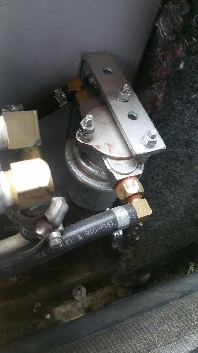

Alrighty. Finally able to get some pics here. There is a tank in the back under the bed. Held up with straps lol. All the lines run to and around the tank. There seems to be a line running for coolant back there out of a coolant heater that's mounted in the front. Not sure of any heater in tank. There are a set of meters in cab. 1 is a fuel gauge and other is temp. There was also some sort of **** along with the gauges. There were about 6 wires going to it. All that was un hooked and cut. If more pics are needed to give me info on it let me know. Thanks.
Setup behind seat
To the left of big setup behind seat
To the right of big setup

That's actually not a bad kit. Still a little hard to tell everything from a few close-up images, but I can tell the PO did put in some decent money. I'd say at least a grand.
That Duralift e-pump is a minimum of $90. The filter heads are pretty sold too. Not too cheap. I didn't see much of the tank, so I can't tell you if that's good or not. Lots of these DIY kits had a coil of flexible pipe in it, but some had heated fuel pick-ups.
The unfortunate thing is, he probably bought $150-200 worth of brass fittings on that kit, and it's kind of a general rule about WVO that you don't use mild steel, brass, or copper. Those metals react with vegetable oil, and create flakes of polymerized oil, which can clog filters. If those fittings are AFTER the filter, then you might want to move the filter closer to the IP.
I used to use brass fittings almost a decade ago on my TDI. After a complete rebuild after about 4 years in use, I pulled all the brass fittings, and did a complete WVO overhaul with aluminum fittings. I analyzed the brass fittings and there wasn't much gunk on them, so I'm sure your kit is somewhat ok. Maybe all the hype is just hype. Regardless, my aluminum fittings never had a speck of gunk, so I stand by my aluminum stuff.
There are some decent components on here. That shut off valve is of decent quality. The PO spent unnecessary bank on those "bio-fuel" fuel hoses. Reg hoses will work, unless he's running BioD, but it appears to be a WVO kit. Besides, BioD can be run in the stock system as long as you're running viton seals in your IP and fuel hoses. Got any pics of the gauges. Gauges can cost something decent if the PO invested in a good kit.
Some stuff that could be replaced. Install some new pipe insulation. It'll hold heat better and it's cheap to replace. Plus you get the benefit of seeing how your fuel lines are installed. There are HOH (hose-on-hose), HIH (hose-in-hose), and so on....It'd be good to find out. I have no idea what that big cylinder is on your fuel bundle.... Might be some sort of heat exchanger. I'd be skeptical of any heat exchanger that isn't nickel-plated. Most cheap heat exchangers are copper, and that is the WORST environment for WVO--heat+oxygen+WVO+copper. If that is a HE, and that HE is copper, you should replace it with a decent nickel plated one. If I remember correctly, I'm running a 40-plate on my IDI, which would be pretty compatible for your engine too.
I gotta run, but it's a good kit to work with. Just the components alone (used) would be about $500-$750 to obtain, so I would consider fixing it up. Clean the tank, test the fuel pump, change the filters, clean the filter heads, replace any questionable fuel lines, test the selector valve, test the guages, etc. Put all back together and test it with diesel fuel (with the coolant supply shut off) and if it runs, then you know it works. Then pour in some SVO (brand new veggie oil from Costco or big box store). If that runs with the coolant supply turned on, then check the temp of the oil at the IP (should be around 160-180 deg F).
If all works ok, then start filtering WVO. ..... Hmmmm. I didn't see how your return lines worked... Still lots to work out. Where're your selector valves?
