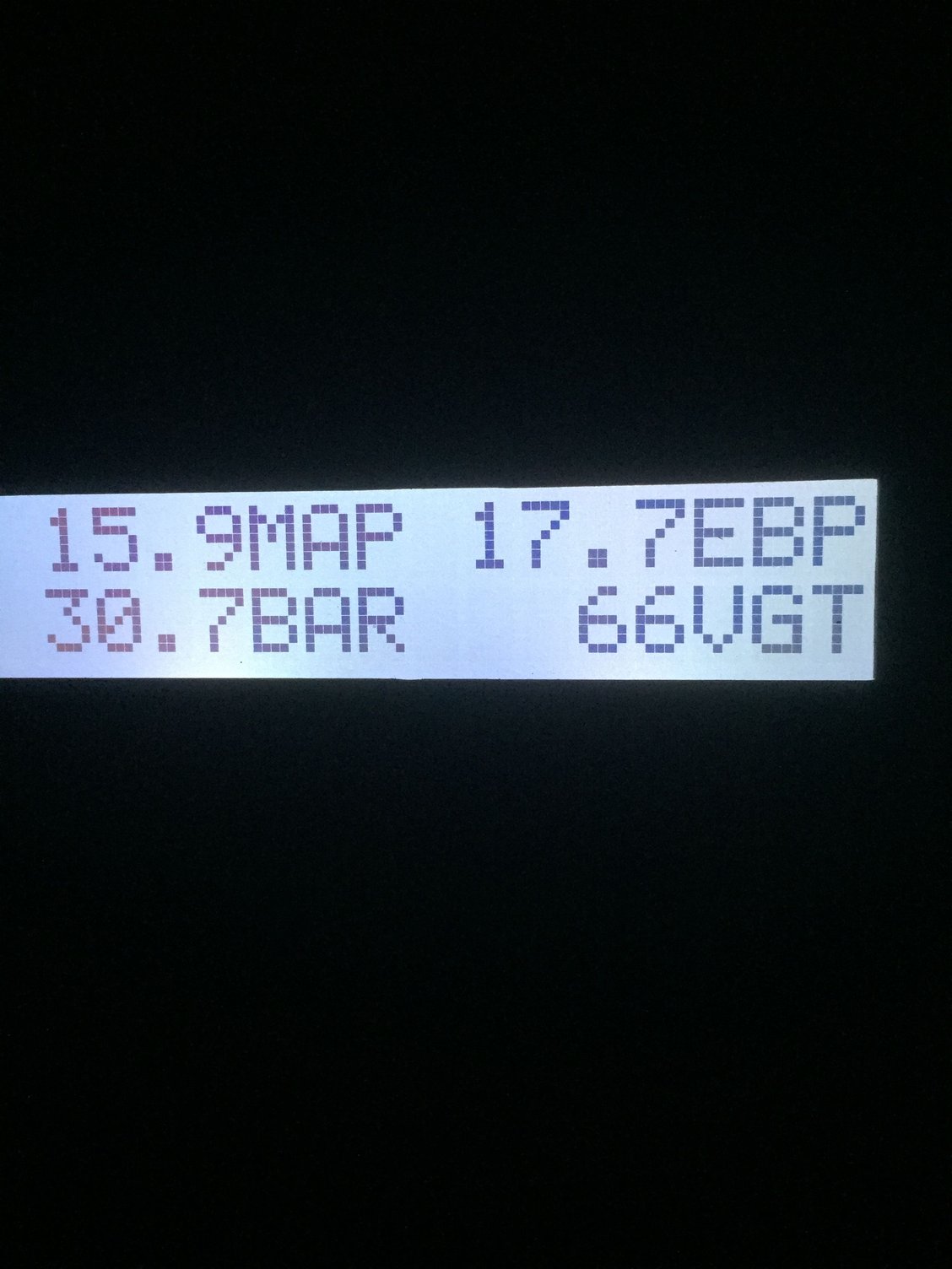

I'm thinking Turbo related, unisome ring or sticking vanes, if your truck sits for a while when your on the road or long idling periods this will soot up and rust the vanes , to where they don't open and close when asked , VGT Silinoid would also be another , let's run the Turbo test , do the test like this
Koeo- ( key on engine off) make note of values
Low- ( idleing no Throttle, no HVAC, no radio) make note
High ( 2500 rpm steady ) Make note
You want to look at
1 map
2 ebp
3 baro
4 VGT
Make a note on the Values on each of the tests. And post them so we can Decipher
Scan gauge can read up to 4 values at a time , if you have a I phone app , dash boss something that you can plug into the OBD Port to monitor these sensors would be a big help for you
KOEO
Idle
2500rpm
NOTE: BARO sensor is read in Inches of Mercury. 30.7 inHg is 14.7psi.

The 66 VGT has me wondering , as long as you don't see 15 on 2500 rpm and 85 on high idle , you will from time to time get 85 VGT on low idle , is this test in park ? Need to be in park no HVAC, radio, just getting the values in koeo low and high 2500 in park, the ICPV when the truck is acting up try to get those numbers, at what rpm we can guesstimate unless you capture these in park , could very well be an injector, just trying to rule out some obvious parts that do the same thing in Nature
