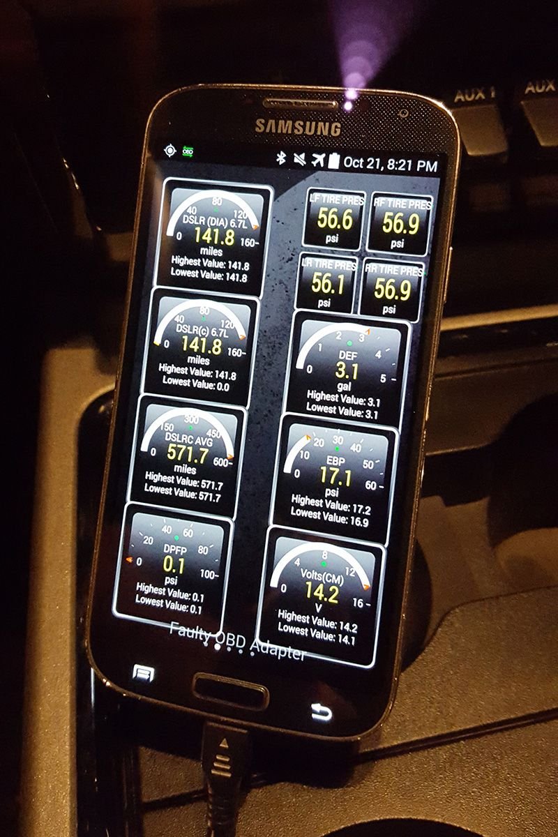

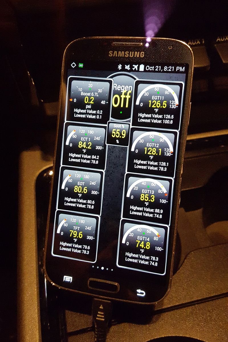

In my 2004 6.0L F250 I had a triple gauge pillar with Pyro, Boost, and Trans Temp AND a ScanGauge II on the dash showing ECT, EOT, FICM Voltage, and Battery Voltage.
Decided to go a different route in my 2015 6.7L F250.

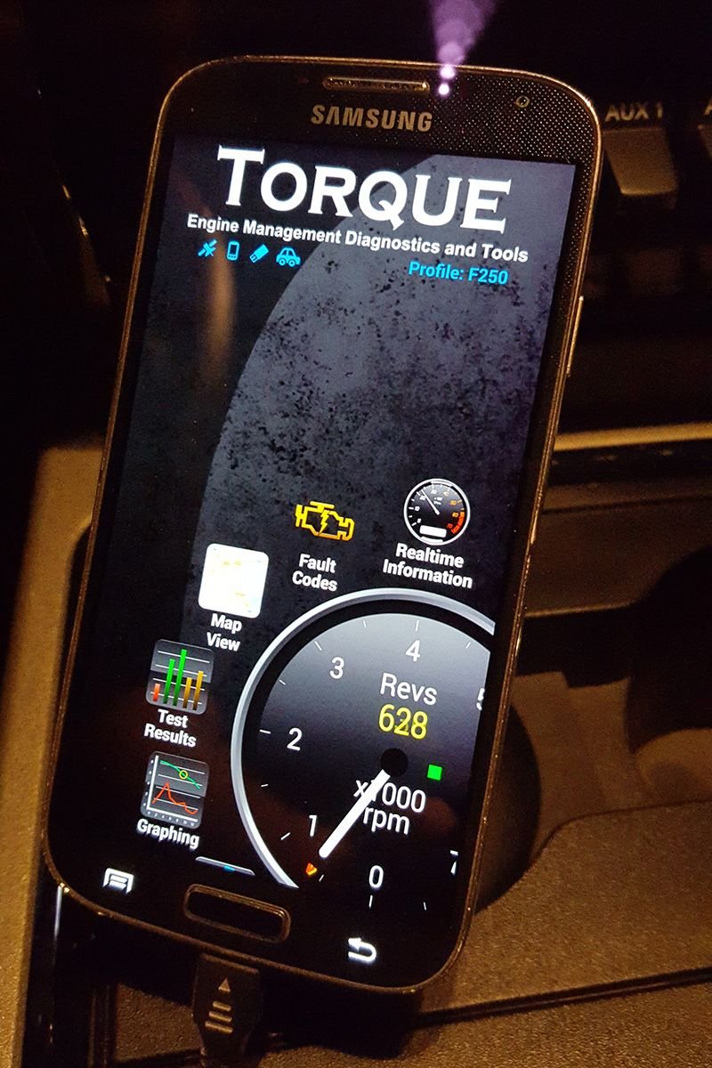

Got a
Bluetooth Adapter Bluetooth Adapter
and the https://play.google.com/store/apps/details?id=org.prowl.torque&hl=en Torque Pro App.

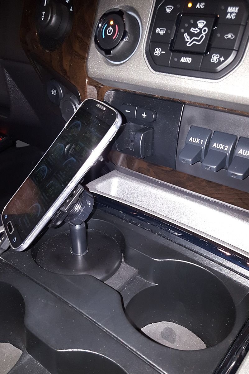

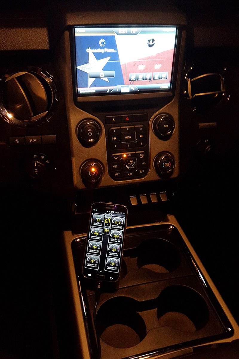

Then used an old Samsung Galaxy S4 I had laying around and attached it to a cup holder mount.
So far I'm really liking it. A lot more gauges available at one time on each screen. My only complaint is about the Bluetooth adapter. It doesn't seem to be very good with lots of data transfer and I get error messages when I enable "faster communication" which is supposed to refresh gauges data more quickly. I turned that feature off and it still seems to work fine.
Sorry for the poor quality photos....

Looks like my old setup. Like the new approach as well. Wouldn't it be cool to have showing on the Ford dash screen as an option.
Yes, it would be nice to have the MyFord Touch screen display vehicle info.
I know with certain high end Kenwood nav receivers and the iDataLink Maestro RR interface, you can display info like trouble codes, tpms info, certain gauges, etc....
We're planning on adding that system to my wife's 2009 Escape.

Yes but in leu of having another screen it would nice to have just displayed on My Ford screen. It is Blue tooth right.
Yeah, the My Ford system does use BT for certain features... maybe a hacker can figure out a way. That's way above my hacking skills.
