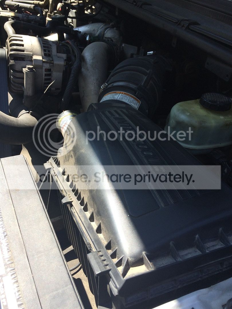

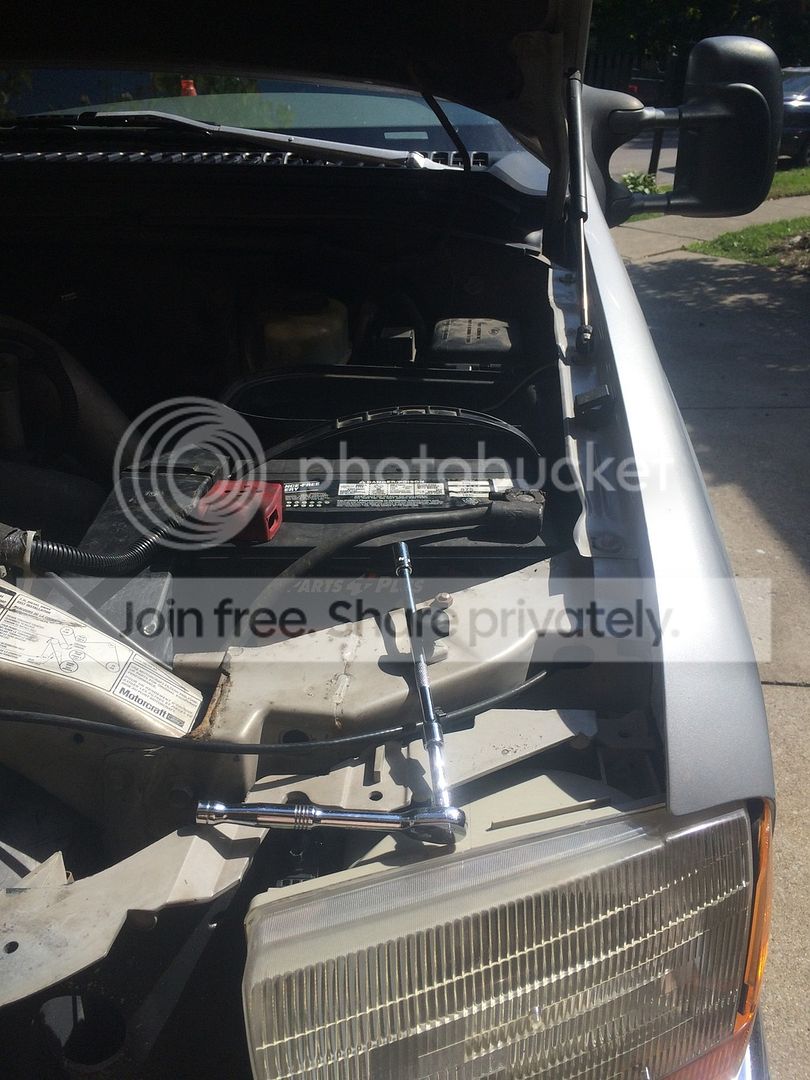

i would dump the "chip" for now...seriously lets work on making the truck feel better and help it fight the flu...yes thats right it HAS the flu and I can bet its not liking it right now, so lets work to get your truck back to 100% health then once you got a good running truck that can run the 5k with out an issue we can get into chips mods and that stuff, the only think mod wise I would suggest AT ALL for starting this process is switching to the AIS intake (unless your running non stock injectors), just do a search using AIS and my user name, there should be a few good threads on it that I posted in also about it, ect. we definatly want to make sure your truck is breathing like it should, if you go under the hood take a look at the air box, do you see 4 "tabs"?? if so you got the poor design air box and it will be worth up grading that to the AIS (yes a bit of work may be needed but I am in the process of writing that up into my build thread for others to have here).
reasom for the upgrad, is due to the flaw in the 4 tabs (if you look at my picture you will see the 4 broken tab bits) as they break and that is due to the top lid bowing out if the incorrect thickness of filter (the gasket bit) is used.
EDIT: below is the "normal" air box, and the AIS box
NORMAL:
AIS: (top removed from AIS, behind battery)
NORMAL:
