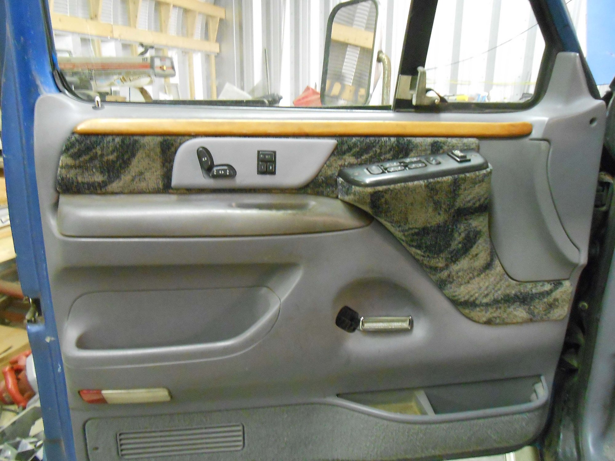

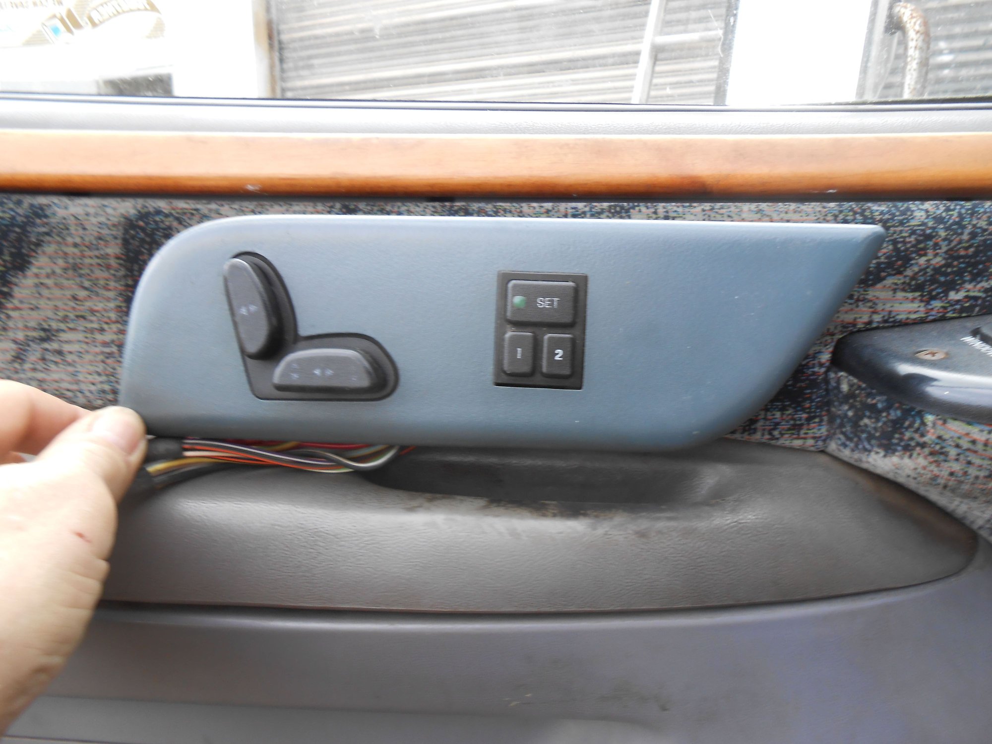

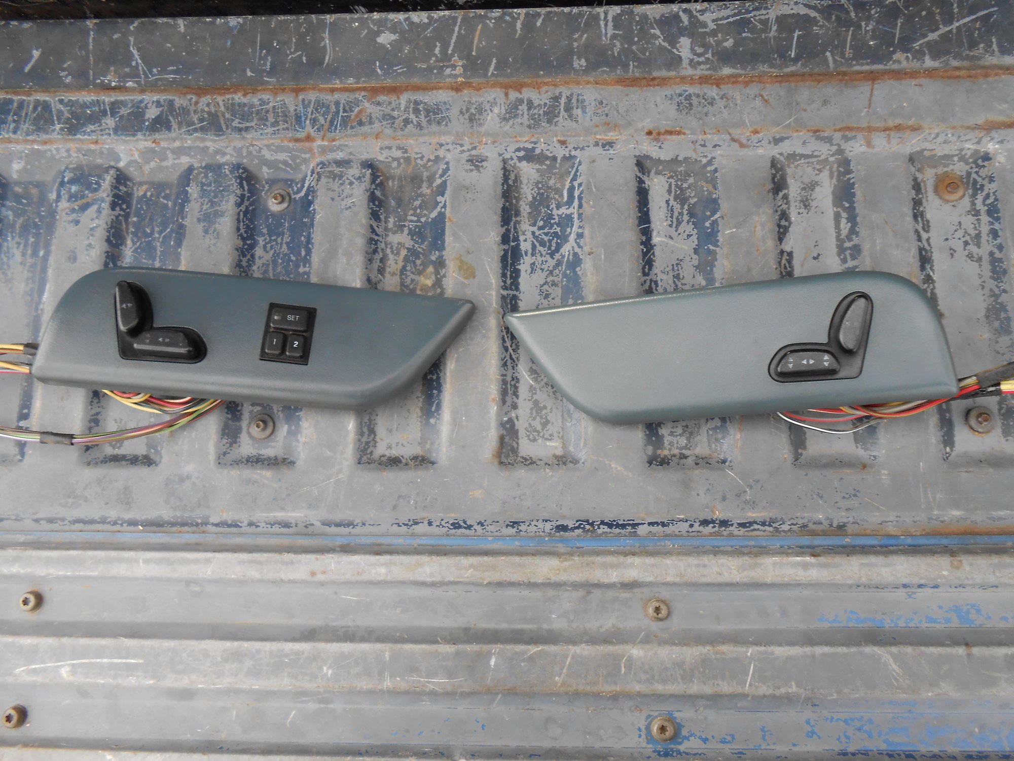

The Town Car has the seat switches on top of the armrest on the door, except for the backrest recline controls, that switch and a pneumatic lumbar support control are mounted on the outside trim on the cushion. Now I just needed some switches and a way to mount them. One row down and about 5 cars over was a 1996 Crown Victoria, loaded. It had keyless entry and separate front seats with driver's memory seat. Seat switches were up high on the door panels in mounting plates.
Here is a trial fit to see, color is almost right, just a bit too blue-green.

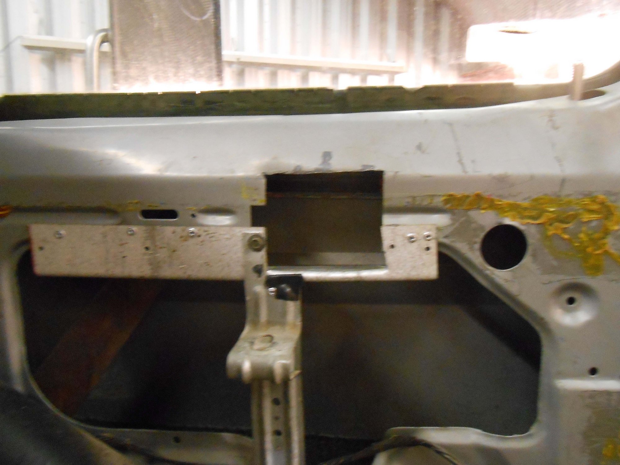

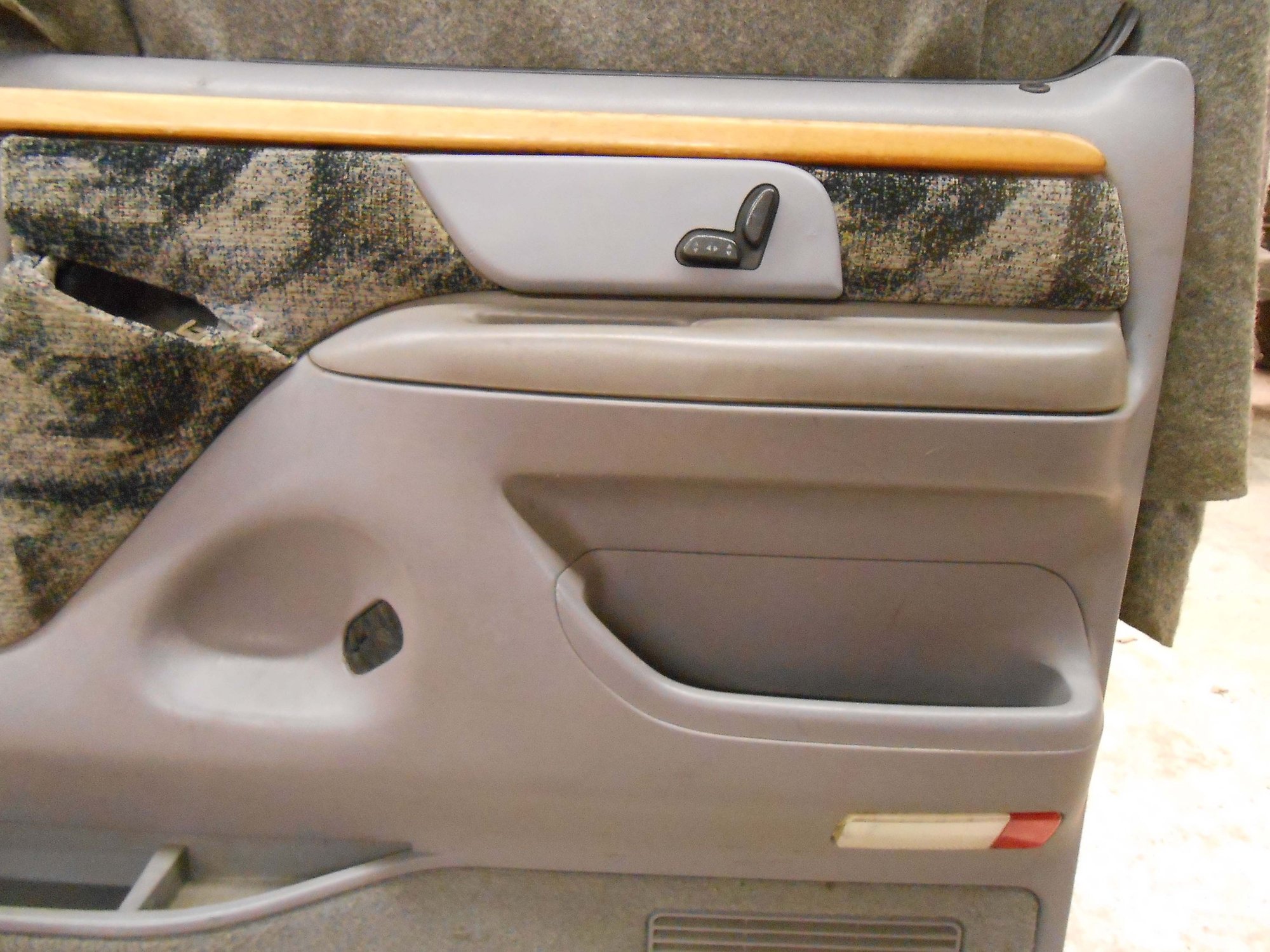

Well, the last couple of days the weather has been warm, but occasionally very damp (quack. quack). I took advantage of the weather and started first with the right side as that was only going to be wire in the door mounted switch. First problem, the door inside panel almost touches the inner skin of the door leaving no room for the back of the switch, and the best location puts the front edge of the switch "box" where the upright for the door pull pocket sits. It was hacksaw, snips and drill time to provide both an opening for the switch and retain the needed strength for closing the door.
Black tape is to protect the 10 wires on the switch from damage. Here is how the switch fits in the opening.
You can see where the wires run close to the taped area, the piece behind where it is cut for clearance, the cut section is folded in leaving a rounded area. Here is the finished product.
Works great, seat runs from the door and is much easier to reach the switch.

Finally got the left side done. Even though I had pulled the needed 10 wires for the switch (power, ground and 2 wires for each of the 4 motors) I still needed some others. There are 4 to the memory switch. Set, 1 and 2 and a lamp drive for the LED in the memory switch. I also wanted to separate the power source for the low current controls from the 30 amp lock breaker (also used for the seats) so I added a white/purple wire to be fused with a 10 amp fuse later. Here is what the left door looks like now.
I still have to hook up the door ajar switch and a wire to the start circuit as I think those are needed for all the memory seat features to work correctly.
