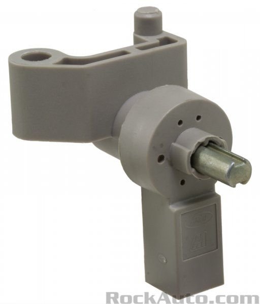

Take a look at the parking brake switch under the dash on the parking brake pedal assembly. It might've come loose. If it looks damaged replace it. Or, it's only $20 at Rock Auto. You might just replace it anyway. Or unplug it and see if that changes anything.
Originally Posted by Mambam
Did you ever find the problem? I have the exact same thing with my 2006 Navigator, no warning lights, etc. a single beep about every 30 seconds. If I slightly engaged the emergency brake...it stops
2006 Navigator Parking Brake Switch at Rock Auto
