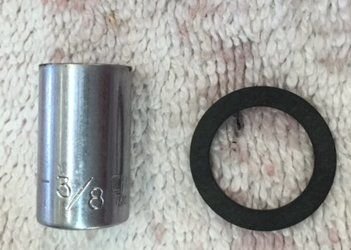

Installing a Transgo Shift Kit 67-1&2
The gasket pictured below was included and in the package with the drill bit, but the directions do not mention it. I didn't take anything apart that I can see needing it. What is your thoughts.

Looks big enough? Is it thin gasket material or thicker like a seal?

Is it not the oring for the filter tube?

Just spoke with Transgo Tech Support.
It is to act as a spacer between the modulator and the transmission. Says the spacer will decrease shift points and firmness if used.
