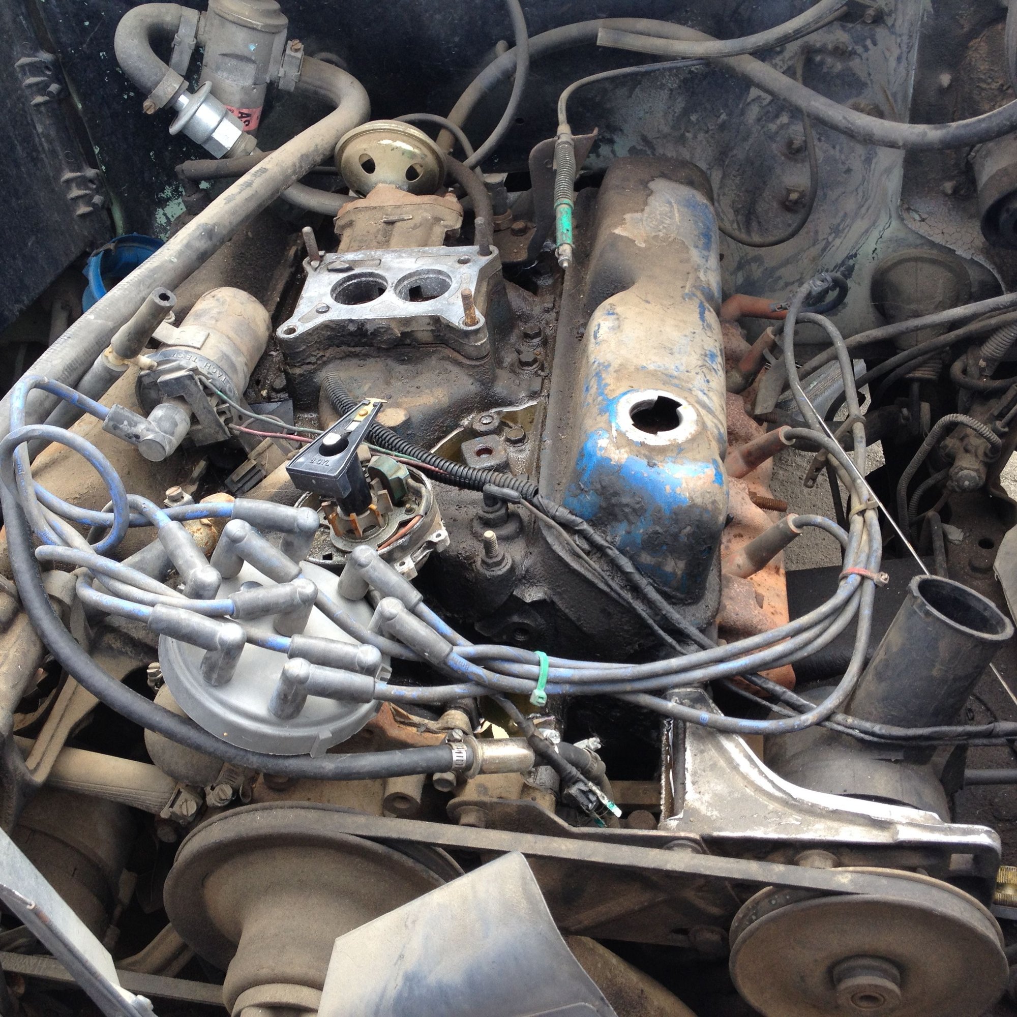

Here's a pic of the engine

In this link they say F is a 302.

F = 1980/85: 302 2V
E2BZ-3C511-A (replaced D8OZ-3C511-A) .. P/S Pump Support Bracket / Marked: D8OC-3C511-AA / Obsolete
1978/79 F100/150 302 / 1980/86 F100/250 & Bronco 302 / 1980/82 Fairmont/Zephyr 255 without A/C / 1980/82 Granada 255/302 without A/C / 1981 Cougar 255/302 except XR7 without A/C
