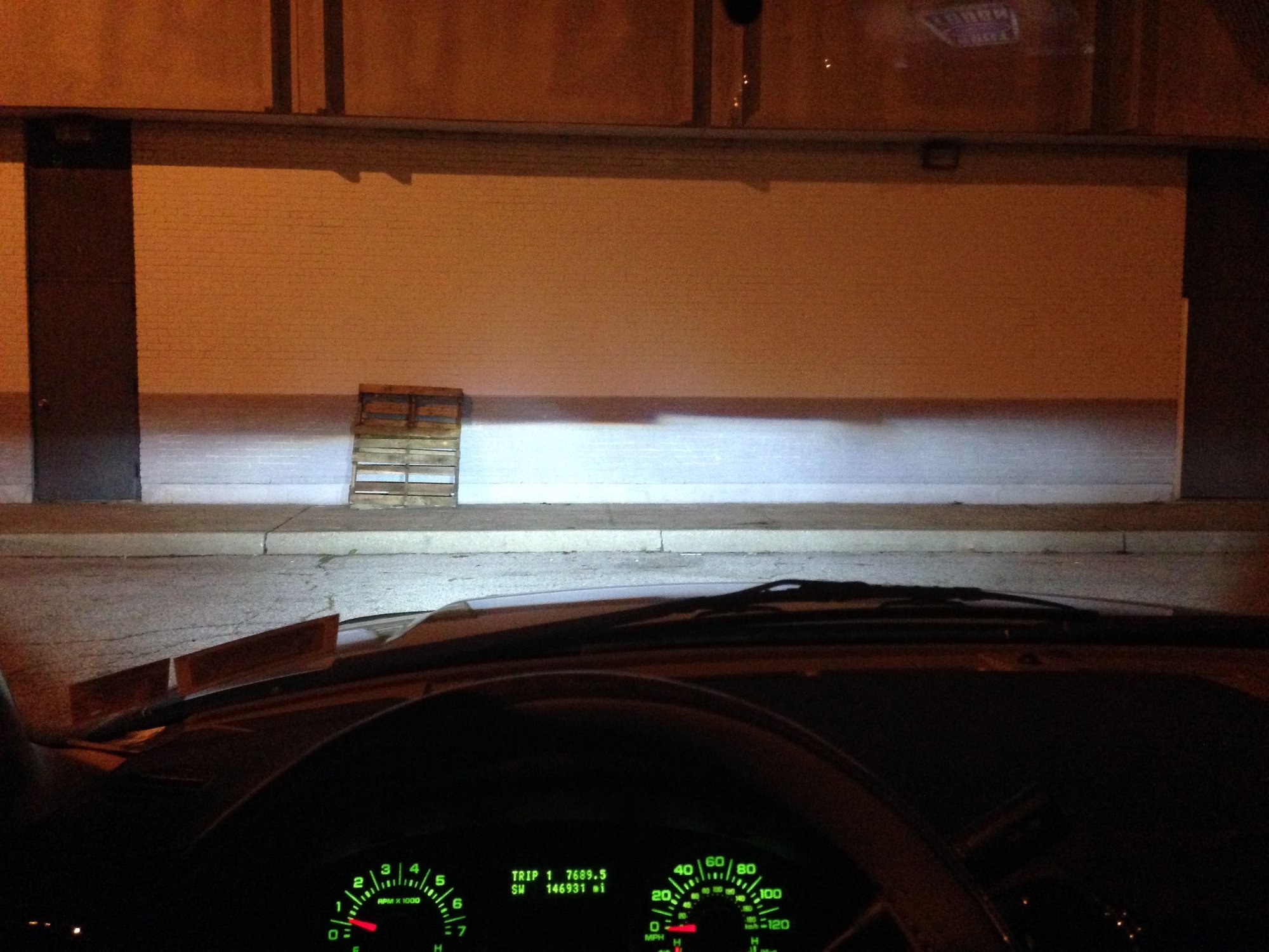

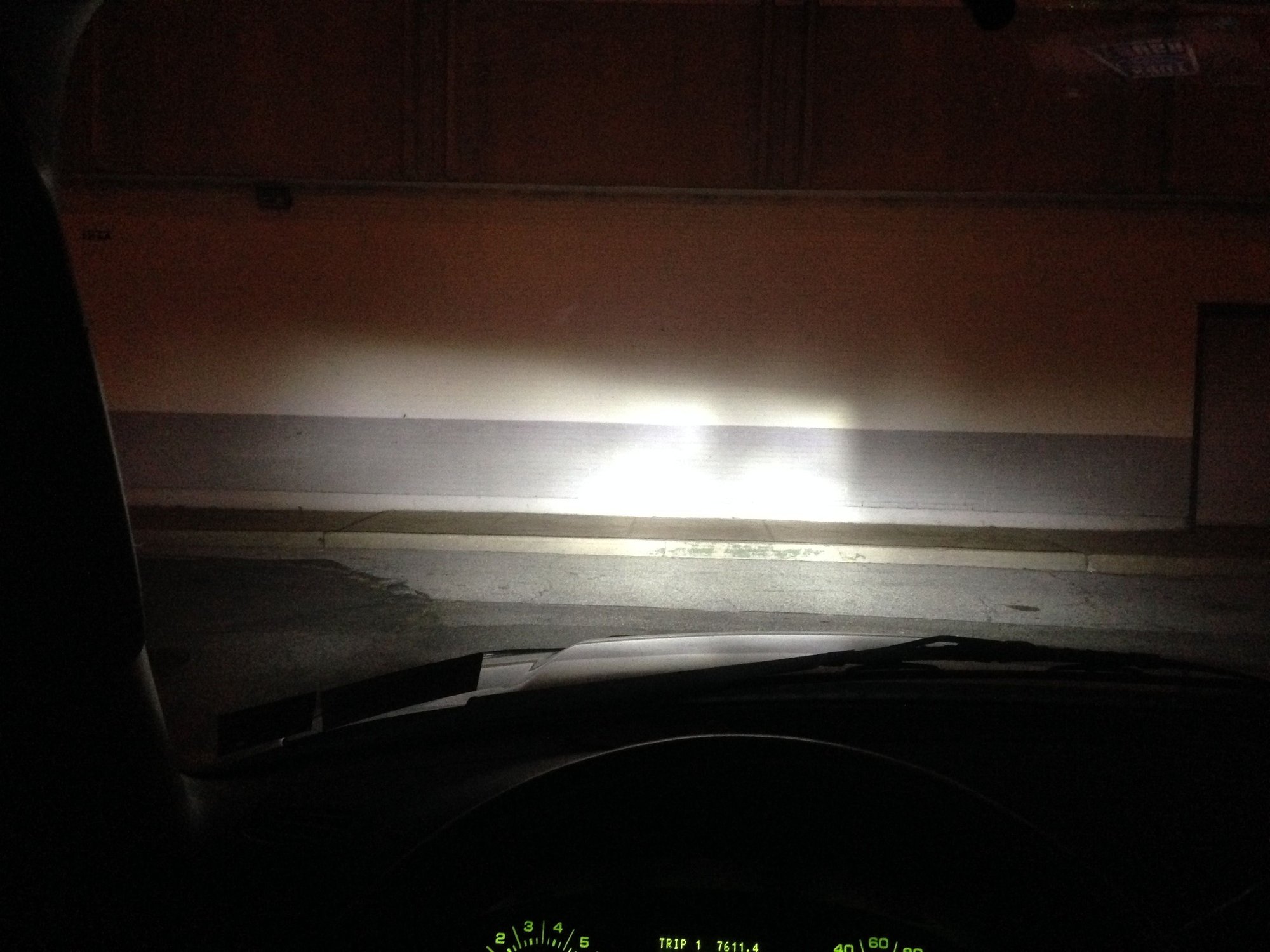

Ok, so the verdict is in. I would say its 20 or 30% brighter than my hids and far less blueish color. Less blue the better as far as im concerned.
HID: (Headlights and fogs)
Now i should say, my hids were scattered all over the road and most likely blinding the crap out of everyone. 5000k kensun 55 watt kit that still had a blueish tint to them. My auto headlights were finicky at best, even with me running a dedicated power with a relay. Still occasionally only one headlight would come on. I miss not being able to use my auto headlights. Also my 5000k kensun 35 watt fogs always look a different shade of blue from left to right and don't match the color of the headlights even though they are the same color temp. I tried replacement bulbs and they even sent replacement ballasts. no luck
LED: (Headlights, fogs and front rear parking/tail lamp turn signals).
Much much brighter than my HIDS which was surprising. Scattered light is far better but the light is brighter and much more blinding. The light has no noticeable tints of blue. My auto headlights work perfectly. Its a no hassle installation, plug and play. Lower power consumption. Longer life more reliable than HIDs (this cant be confirmed yet, just a theory). Being LED, they look really cool (as long as your not directly in front of them being blinded). The LED parking and tail lamps look awesome (also much brighter than stock incandescent).

Seems like the LED pattern is less defined, do they blind oncoming traffic? I really dont like headlight mods like the chinese HID stuff which blinds the heck out of oncoming traffic, which is why I only recommend getting HID projectors if you want to retrofit it. The reflector on the headlights are designed for halogen bulbs which has all the light in one spot, while LEDs and HIDs has the light source in a much wider and bigger area which throws off the focal point of the reflector...

Agreed about the projectors.. I really should have had them with the hids too. In these current reflective housings, the led is far more blinding yes. I know adjustment would help some but how much?

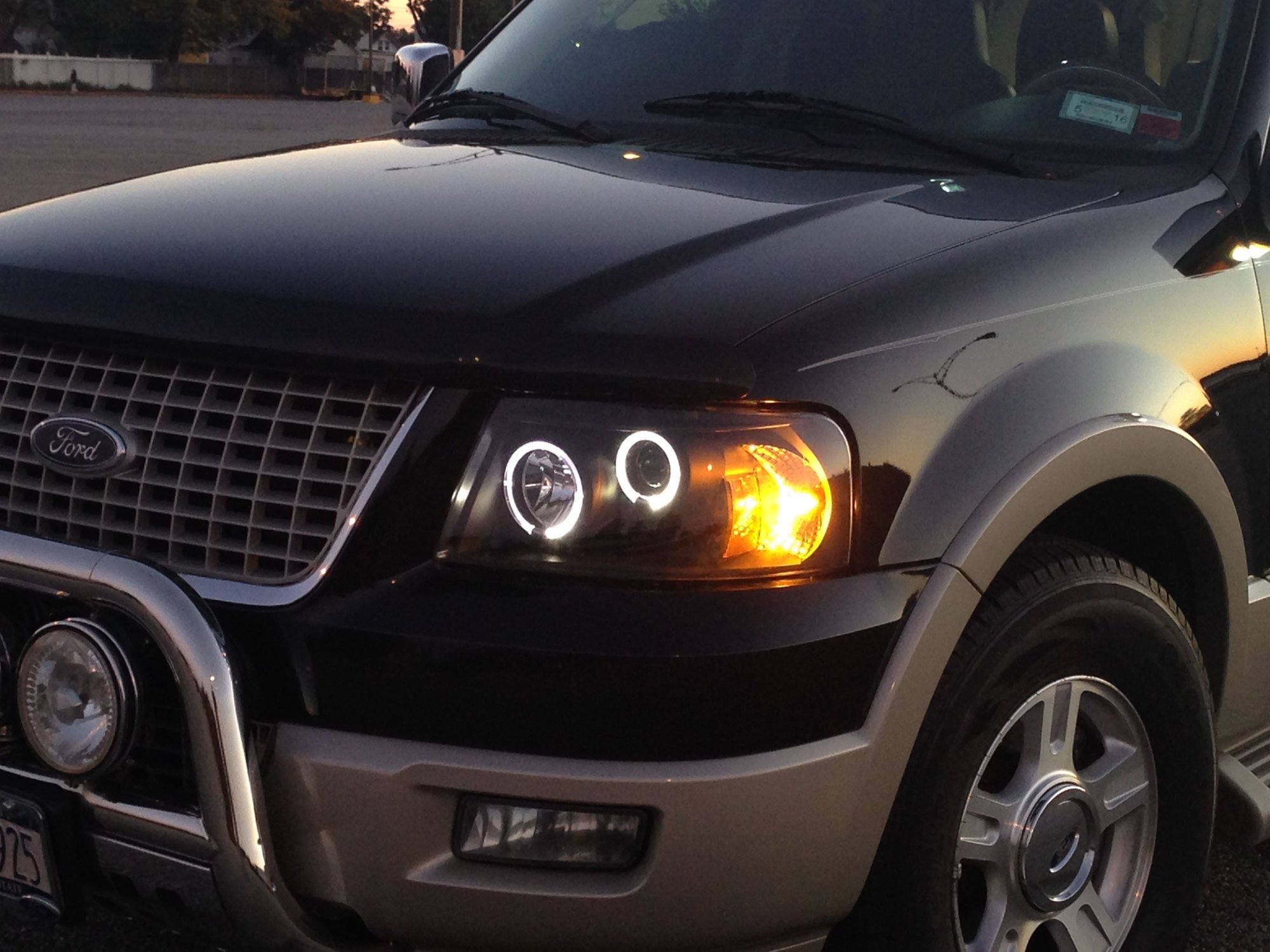

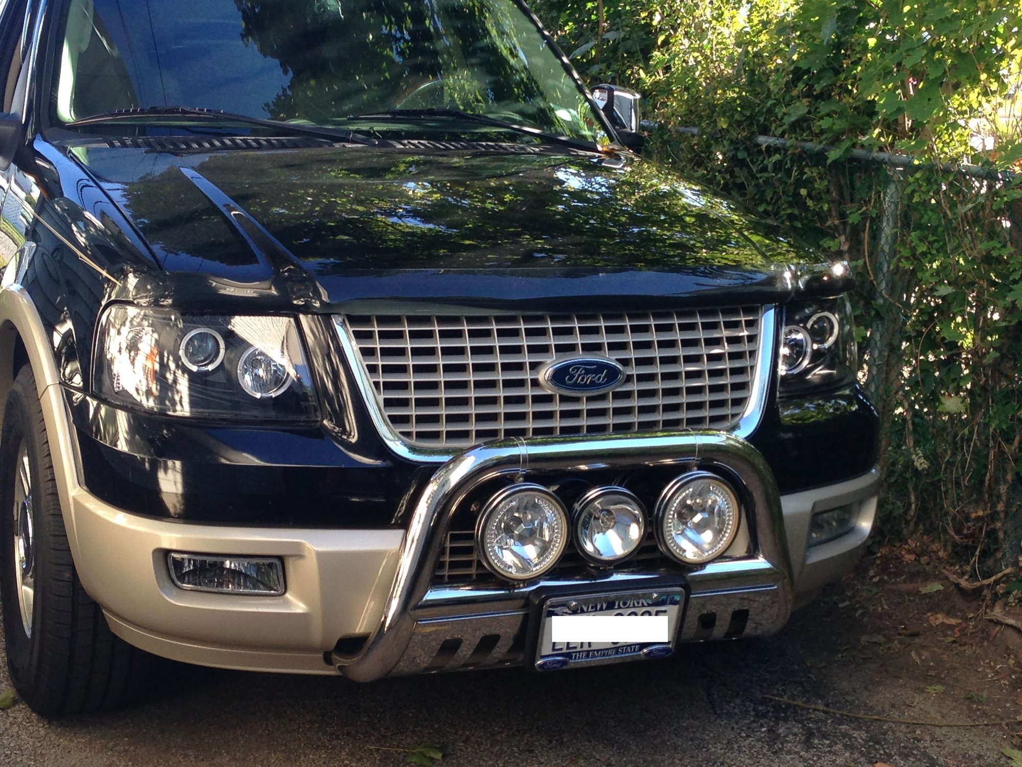

Projectors Installed
Ok so installed my projector headlights today after work and they completely exceeded my expectations in every way. They're keepers for sure.
General appearance
Honestly when ordering, i gave it a 50/50 chance that i would even keep them. However after installed at first glance, they don't really seem to look too aftermarkety which is a good thing. The blacked out housings work well with overall appearance of a black truck which is what i was hoping for. The Halo rings (which i really didn't care about) are a nice touch and look pretty sick at night without being too extreme. During the day, they are not so bright to be noticeable but no big deal (again, didn't buy them for the halos so if anything, its a bonus to have em). I wired the halos to work as drls but also to illuminate with the courtesy lights when you unlock from the key-fob. There are also 3 additional leds at the top of the housings that run horizontally. I didnt hook them up, will test them at night to see if its worth doing so.
Headlight output
Its literally a no brainer that these are the solution to scattered light even before i made my adjustments this evening. The difference is night and day. They needed adjusting but no issues at all with that. The adjustment is very accessible and easy to use. Plenty of white light. They are not blinding in any way whatsoever even standing directly in front of the truck.
Parking / turn signals
Ok so if you notice in the daytime pics, the parking light lenses are wide open clear with an orange reflector on the side. Instead of having an amber only led bulb, i will use led amber/white switchbacks instead. Meaning white parking lights and when turn signal is on, they will blink amber. I think it will be a nice touch rather than seeing an amber parking light on at all times.
