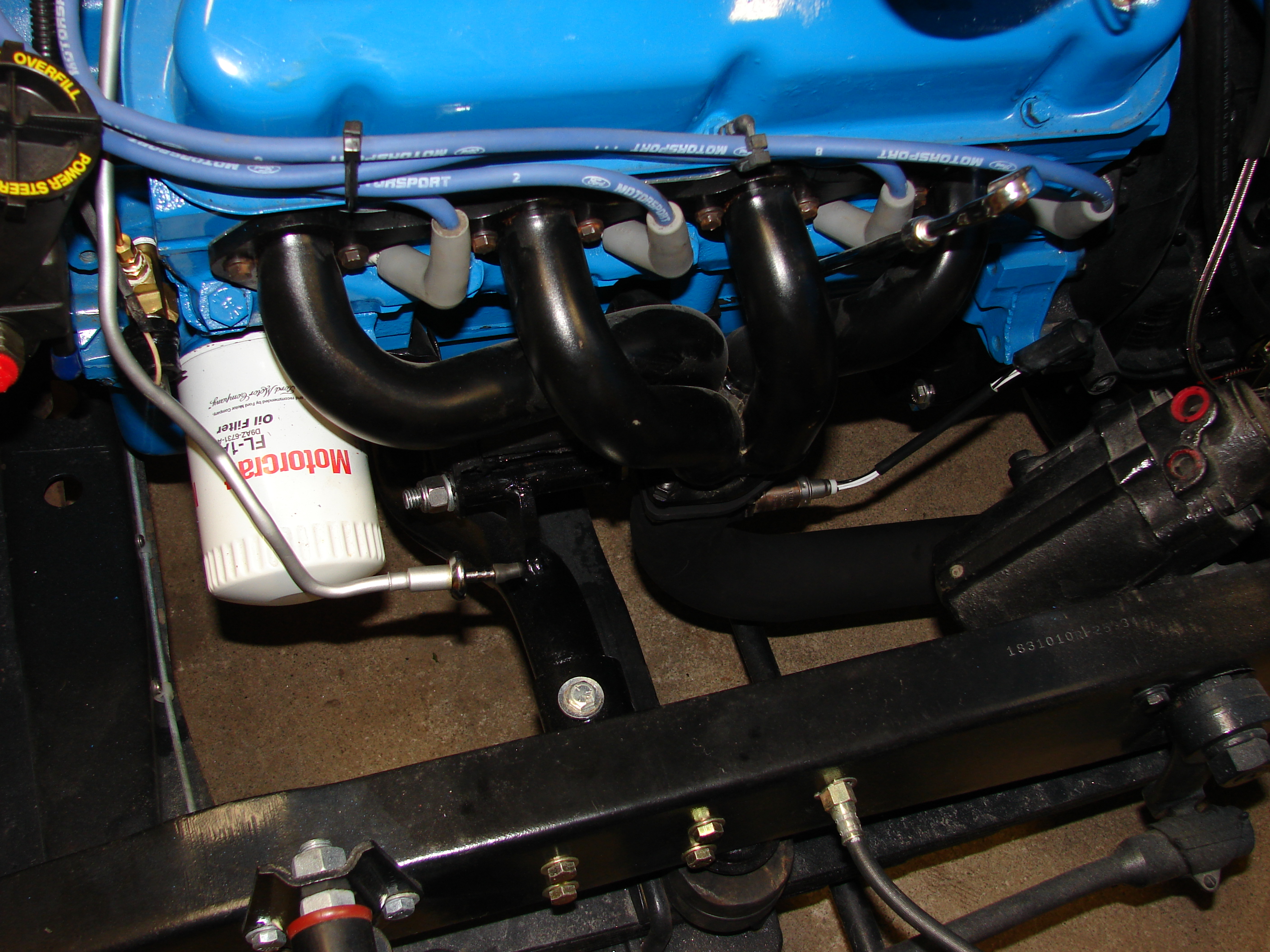

I have a 55 f100 that I put a 289/c4 into it..I also have the toyota style steering box mounted where original box was..Does any one know which shorty headers will fit best? Brand? Any pics of same set up? Thanks

Here's mine. Good luck.

Sorry; Shorty's from Speedway Motors. Patriot Brand.

Looks great! Thanks
