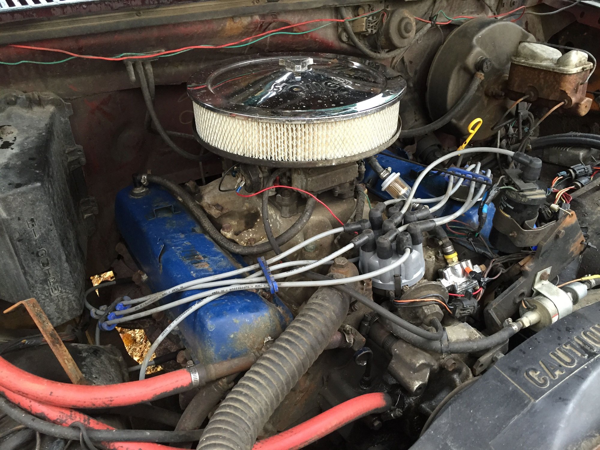

Hey all. Last month I bought a 1983 F-250 Custom with a rebuilt 460 installed. For the sake of getting the right parts at Napa and elsewhere, is there a way to identify the age of my 460 or what model year it came from? Any identifying features or part numbers I could check? I only ask because one of my local auto parts stores gave me the wrong distributor cap and wire set, and when I exchanged it, they were able to find the right kit but under an older model year truck.
Here's a picture of the beast in question.

I see a DSII box over on the fender.
You *should* have the larger cap, the tall rotor and a cap adapter on your distributor.
.... whatever. As long as you don't have a lot of arcing with the points style cap I guess you're okay.
The only real difference in any 460's found in *carbureted* trucks was the running change to external balance cranks in 1979.
You can tell by the tomahawk counter weight behind the harmonic damper or a D9TE casting code on the block.
Your truck is way too far from stock to say what will fit, determined by what SHOULD fit.

Check for a counterweight or the block casting number behind the starter.
At least you will then know if it is before or after '79.
"Rebuilt" ... its impossible to say what parts were used to put it together, but as it stands it didn't come from a bullnose truck.

Is that a bungie cord asa throttle return spring? What HACK job
the timing cover dipstick is from a car engine(front sump)

460's were only available as a C6 2wd automatic truck in the '70's.
They disappeared for a few years while the 400 (stroked 351M) took over.
In 1983 they were again available, this time with the option of 4wd and/or a manual (T-19) gearbox.
Probably doesn't help you much... but there you go.
A front sump engine can't fit with a 4x4 crossmember.
