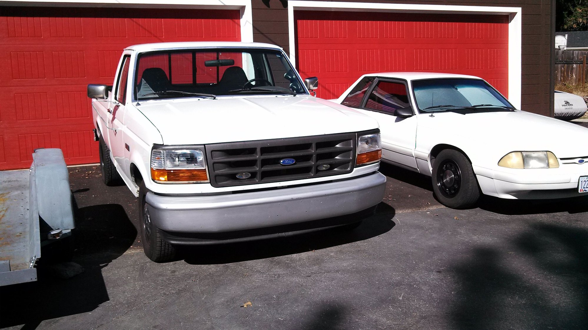

After installing drop hangers and shackles (will never do that again with the bed on!)on my '96, I was supposed to get an advertised 4" of drop on the rear. As you can see in the pics, that's not 4" of drop, more like 2-ish from what I've measured.

The rear of the truck still almost looks stock height to me!

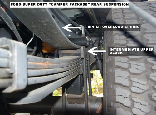

I do not have drop hangers, they are stock. They do have an affect on ride height however you only get as much drop as the thickness of the spring, so maybe 1/2". You could always remove more leaves for more drop but then you run into axle wrap and wheel hop problems as well as decreased payload hauling ability
Yeah I would never remove leafs on a truck, defeats it's purpose IMO.
Do you have any pics of your truck already posted elsewhere on the forum?
When you said overload spring, for some reason I thought you were referring to the spring on top of the spring pack, guess that's more of a "helper" spring.

Lowering questions.
I do have pics but I don't think I have any after the overload spring was removed. By overload spring I was referring to the bottom spring in the pack. Its a lot of work to remove it for only a 1/2" or so drop though IMO. After drop hangers my truck will sit just how I want it in the rear and I'll probably go with 2" drop coils in the front as well.
BTW boots and slicks that's a clean looking truck, nice

Can't see your avatar real well, but looks like we have a common interest:

Wish I had a better pic,the notch is actually my ol lady's car, I take care of it for her though.
Pretty clean lookin pair you got there your self, I like the red interior in the hatch.
