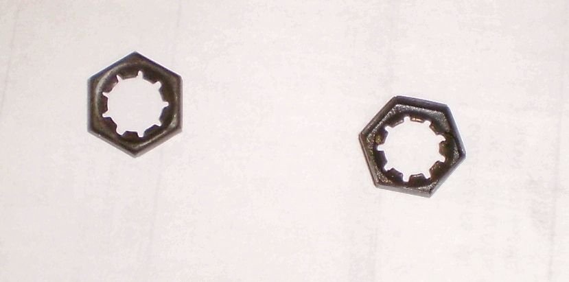

If you mean the thin, stamped steel "PAL nuts" that go on after the real nut, you don't need them. Van Pelt sells them if they give you comfort, if they are the same 3/8"-Fine as the V8's. On the V8's, most people just toss them or use a dab of Red Loctite on the big nuts. My engine doesn't have either and is running fine. The stretch in the bolts is what holds things from moving.
Edit: The ones on V8's don't get bent over, they just tighten against the main nut. The '52 manual shows the 215 using the same p/n as the V8's
This is what they look like

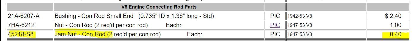

45218-S8 .. Pal Nut 3/8" -24 / Obsolete
NOS PARTS LTD in Waxahachie TX has 16 = 972-937-2201.
GREEN SALES CO. in Cincinnati OH has 34 = 800-543-4959.
KLIMESH MOTOR SALES in Calmar IA has 50 = 563-562-3241.
