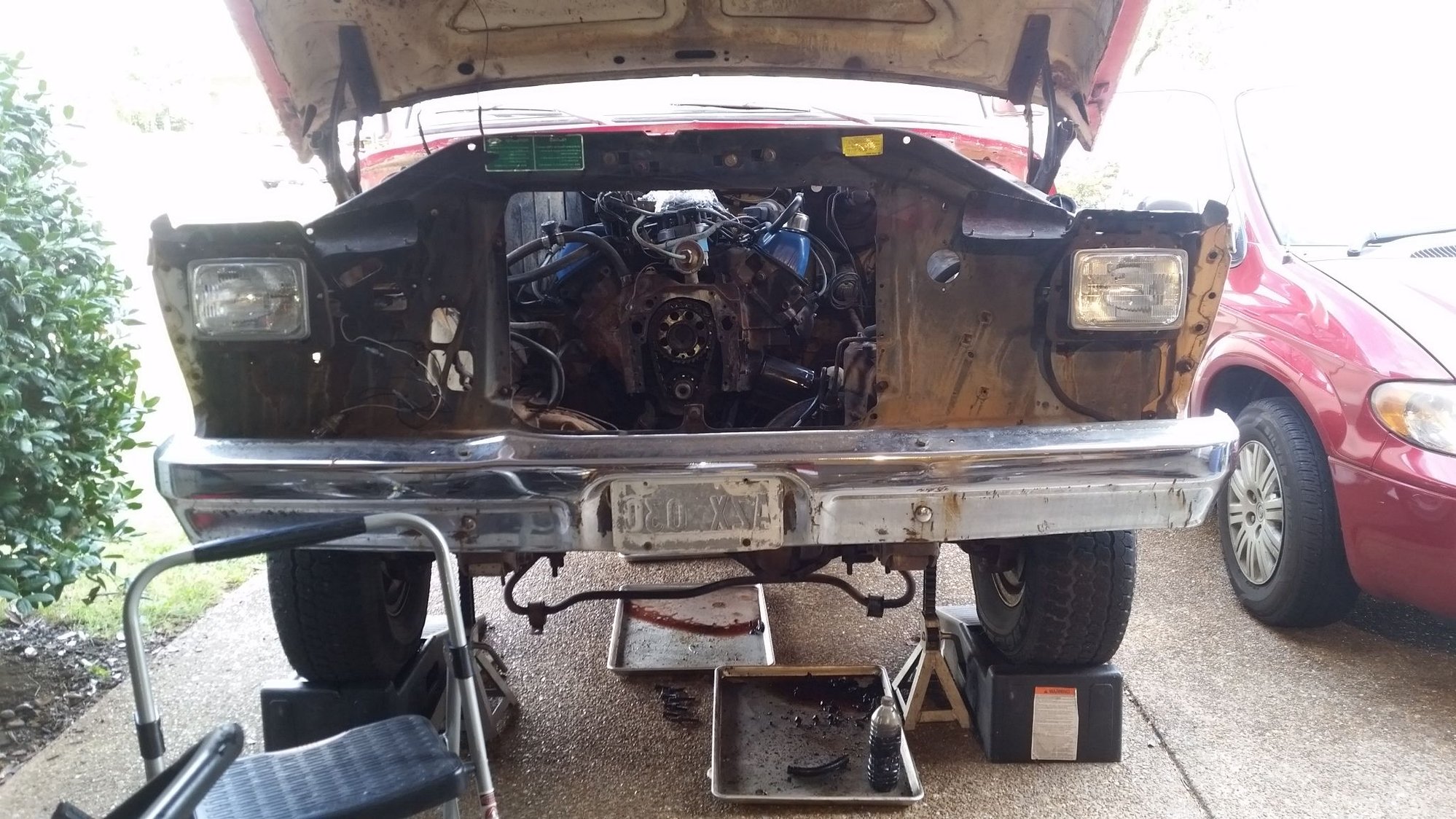

here is a pic of what it looks like now. you can see the key marker line up and each corresponding tooth points directly at each other. if it had slipped, assuming the two point wouldnt be in alignment...is that correct?
here is also of a pic of the new cloye c-3005k set, which appears to have the same markers, etc for lining them up. again, this probably is all basic stuff to most of you. all new to me. first time tearing into an engine ever.
and so you believe that the new set will not be retarded, and the key is already preset to zero, so no need to get one with the 3 keys, etc or anything different.
sounds logical to me. If there are any differing oppinions out there please let me know. my plan is to start putting this back together as soon as I iron this question out.
also if there is any thing else you all think I should do while I have it down this far, please let me know. was a lot of work to get to this point and dont want to have to deal with getting that oil pan back off again, etc.
this is a farm truck I picked up about a yea ago.
