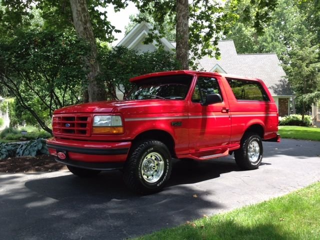

I live on the NW side of Indianapolis and have a 1995 Ford Bronco with 55k miles.
See the link for a picture.

Nice ride there---you don't see many sport models cruising the roads!! Your best bet might be going to a smaller town, like Mooresville or Martinsville. I would think any Ford dealership can handle/fix your issue's but if they turned you away, maybe I'm wrong! Have you checked your fuse's? Also, if you have an aftermarket radio/stereo in there it could be wired incorrectly...? Like Tim said, Ford issued a "safety re-call" on the cruise control, and if that's not been fixed, have them do that also---it's free!!

It seems the guys already put you on the right track, look at your local FTE chapter, you'll find good local info there. If you decide to learn then keep asking, we'll try to help, that's a beauty of a Bronco you have there.
