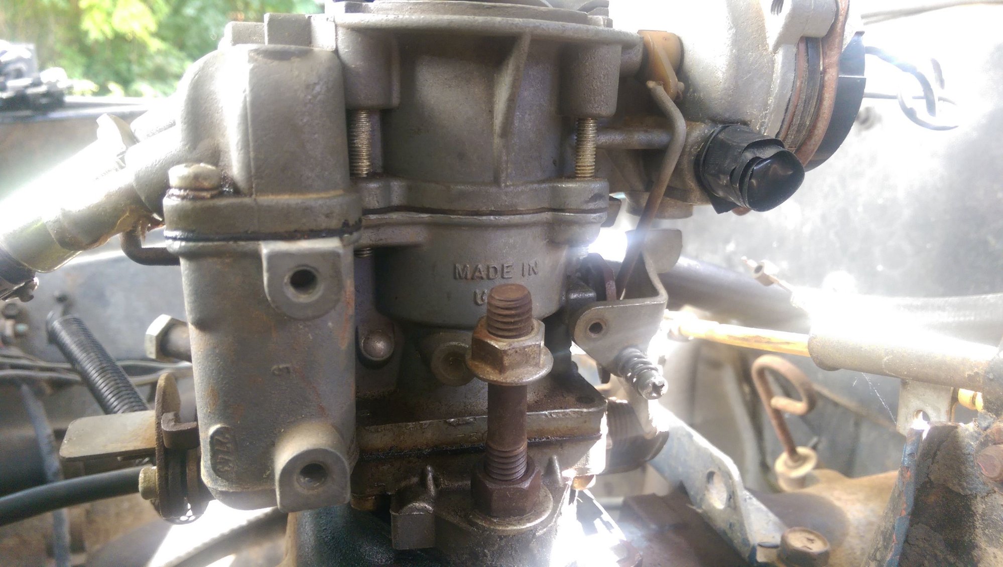

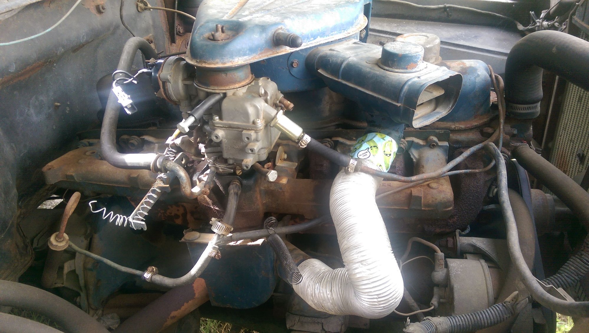

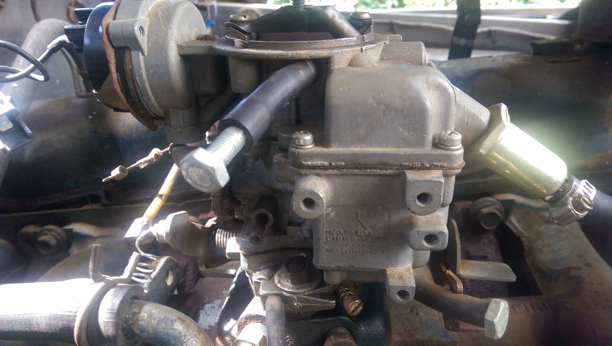

I don't believe the carb is original. There is a choke cable but it is not hooked up to the carb..I think that may be one of the main issues, along with there being a vacuum leak at the base of the carb because it is cracked around where the bolt goes through. The only numbers I found on the carb were 2243..Here are a few pictures.
The engine is from a 1974 (see post 3) F100/350, as is the Carter 1V carburetor.
Carb has an automatic choke, so there's no choke cable required. But originally (1966), the Auto-Lite 1V carb had a manual choke w/a cable.

Engine has been swapped, it could be either a 240 or a 300 from 1974, as the block was cast October (K) 22, 1973 (3).

The engine is from a 1974 (see post 3) F100/350, as is the Carter carburetor.
Carb has an automatic choke, so there's no choke cable.
See the lower cable feeding from the firewall? It's this: D4TZ-9A758-E .. Accelerator Cable - 24" long / 1974 F100 240 I-6 or 1974/76 F100/350 300 I-6.
Is the top cable on the firewall not a choke cable? That's what I was talking about not being connected to the carb.
1966 had an Auto-Lite 1V carb w/a manual choke and cable, but it's not being used, as the engine has been swapped.
The Carter 1V carb that came with the swapped engine has an automatic choke, so there's no place to attach the cable.
