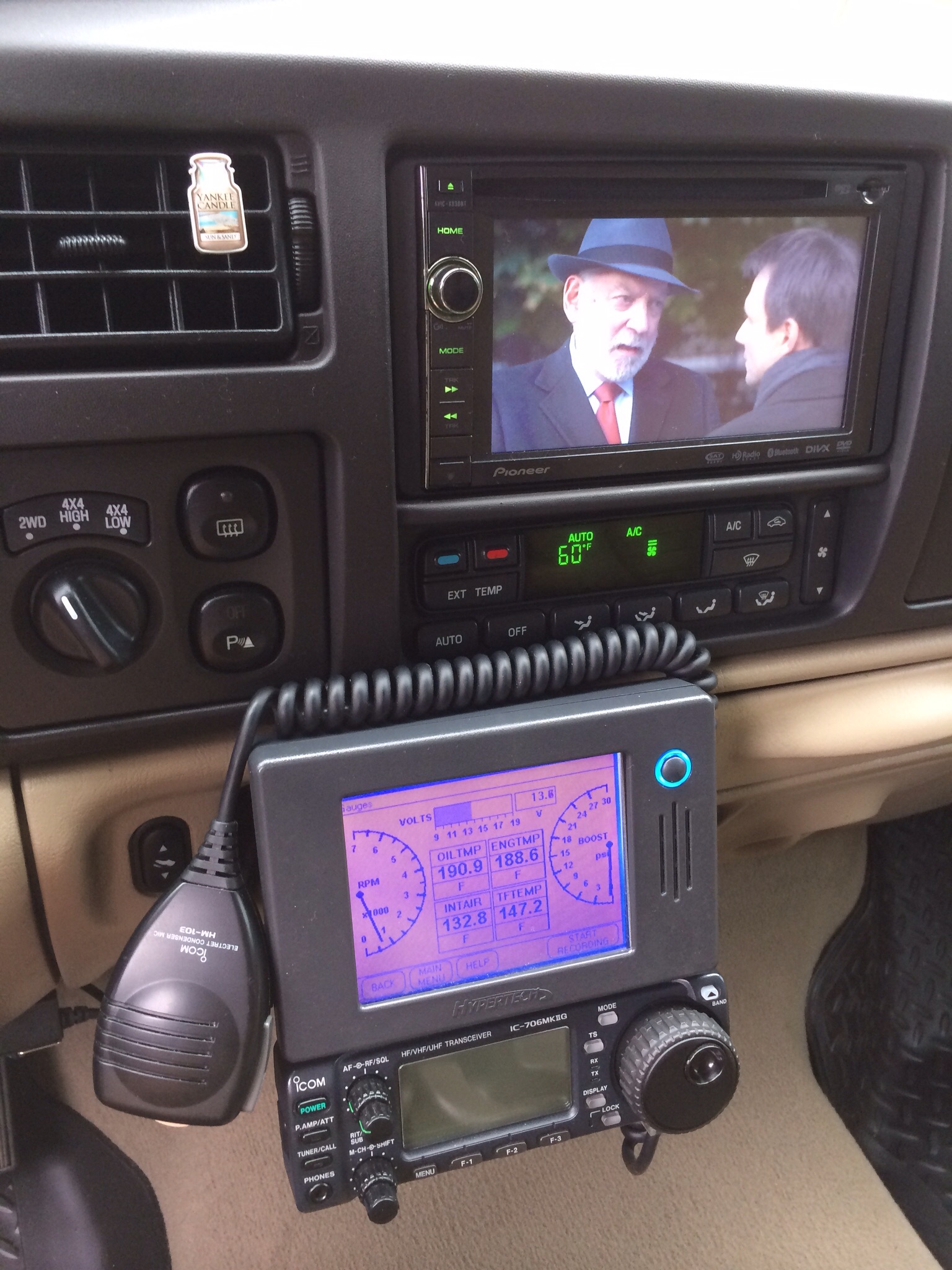

That's a good radio, I'm sure the added power is causing your interference.
I run an icom in the excursion but hardly use it.

What antenna are you using? livinglarge
Old Sep 19, 2015 | 11:16 PM
LivingLarge's Avatar
LivingLarge
Joined: Feb 2011
Posts: 26,410
From: Ft. Lauderdale, FL
I'm using a mag mount base at center of rear of roof. There's only 3 inches or less of cable exposed before going in the rear hatch. I have 3 separate whips that are tuned for the 3 bands I use.

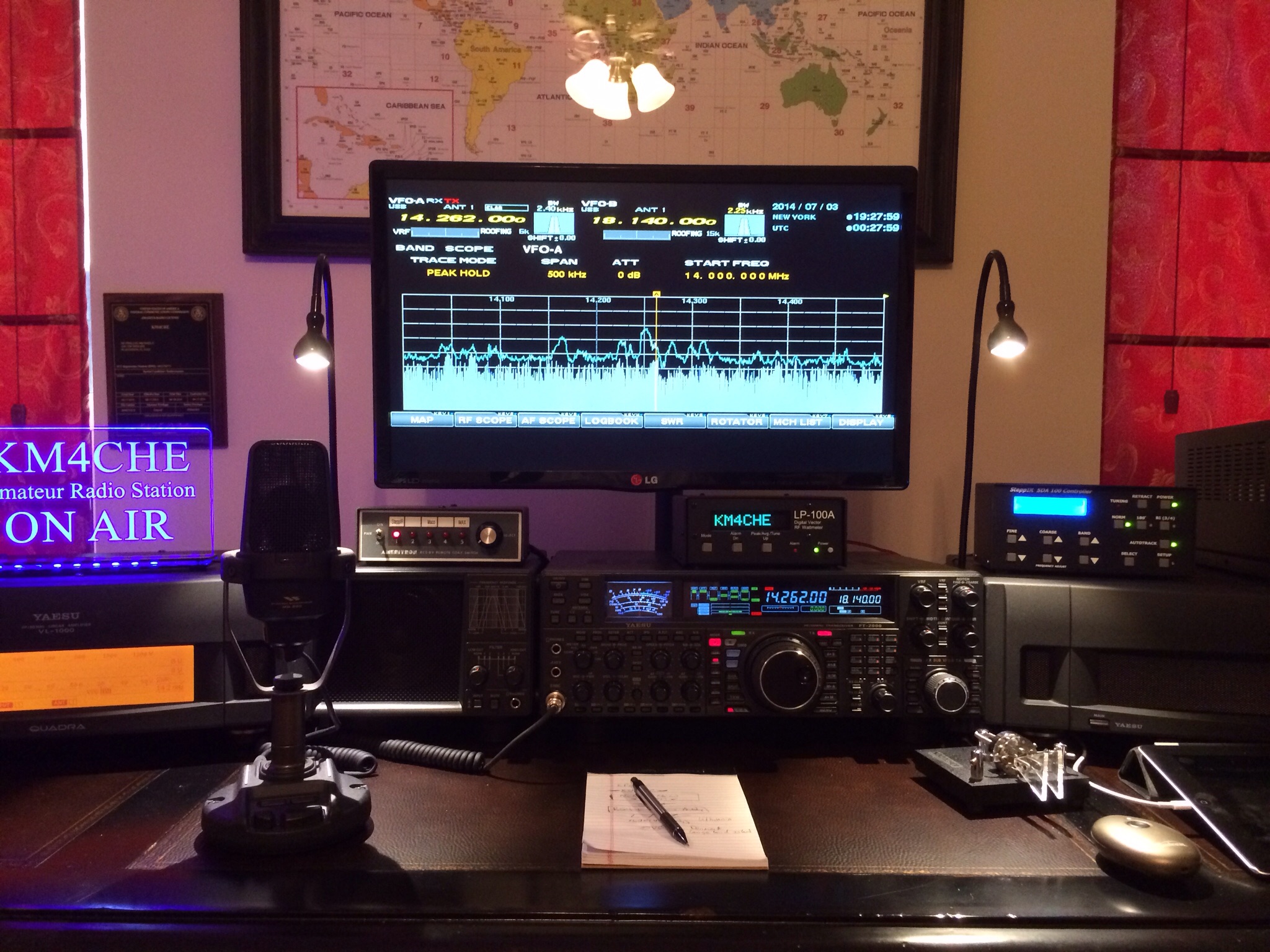

I agree with all above, but I won't be drilling anything into my truck anytime soon.
In my case, besides the proper wiring I had to use an RF choke.
As far as range, with my mag mount and the 100watt radio I've talked all over the world and very happy with the results.
Here's a pic of my ham room lol more like ham desk

I do not know what most of that is, but your setup is sweet!
