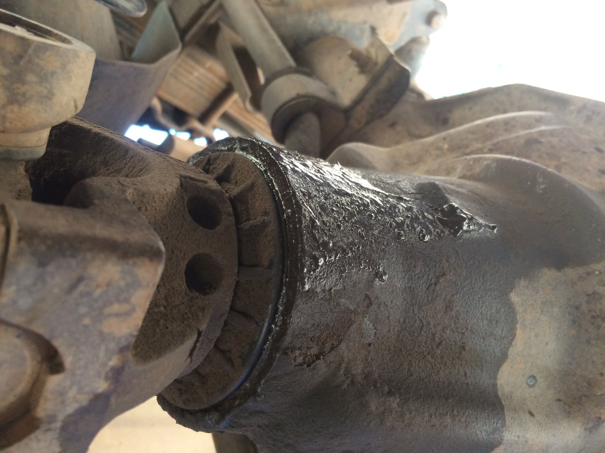

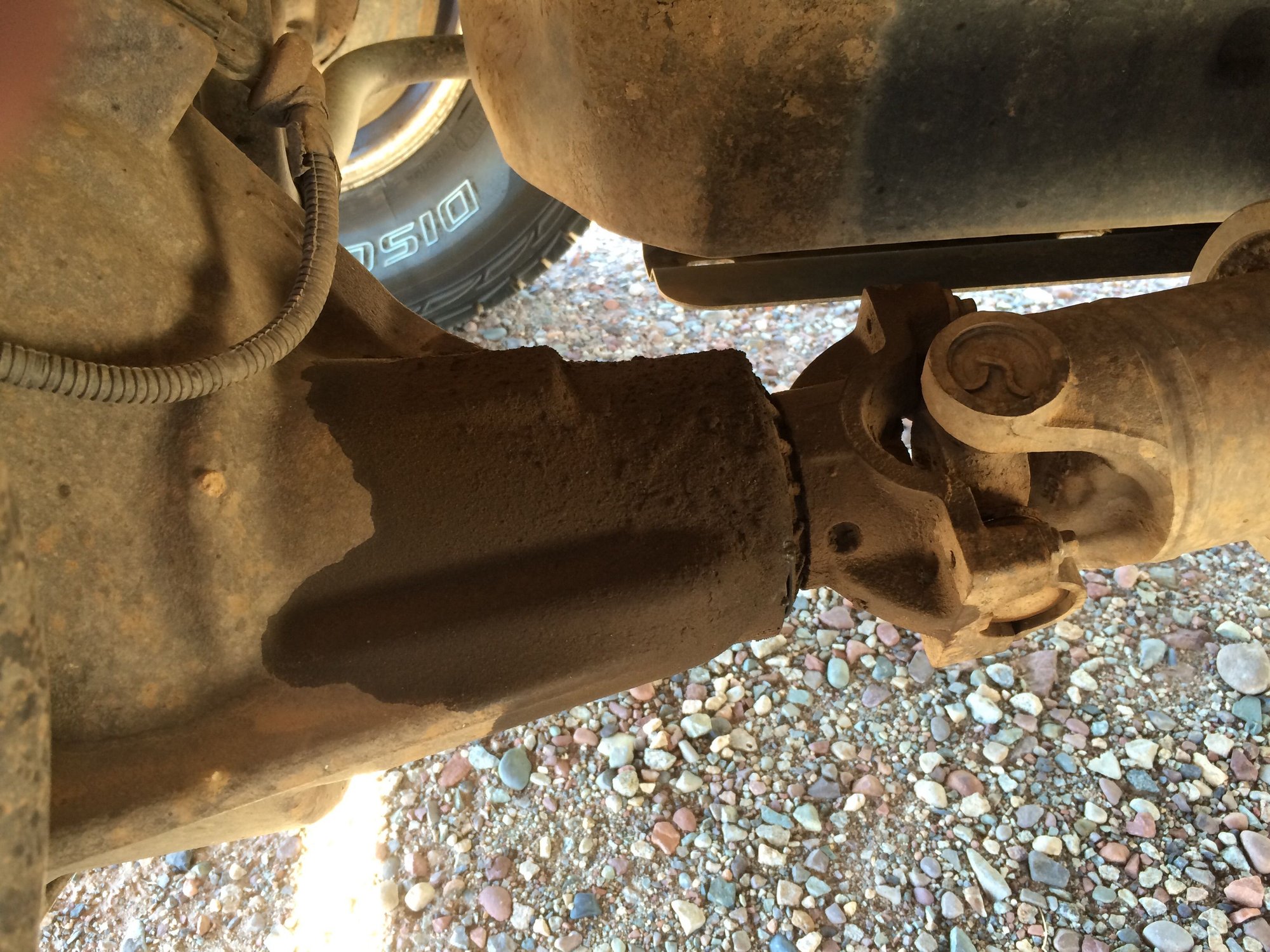

Minor leak from pinion seal - but it has flung some spots of oil.

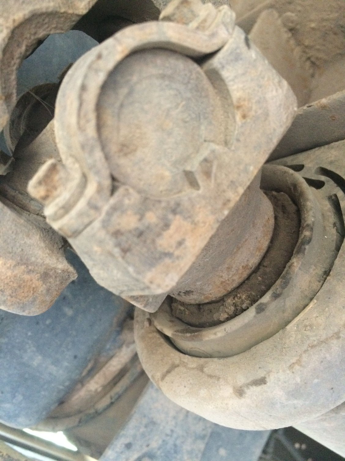

Drive shaft 'centre bearing'(? U shaped attachment on drive shaft to chassis with rubber bearing?) has play I can push the drive shaft at least a 1/4" with my hand and it seems a little sloppy but I'm no mechanic.

I've never seen an old truck with a good D/S hanger or center support bearing yet. It may not be the cause of your problem - but it needs replaced. 250k+? Uh, yeah.

Originally Posted by stuart1
That is not leaking.
Check tires and ujoints.
Nice it's not, that's the centre bearing, the pinion seal has the leak. Didn't post photo yet, but I can. Just had 4 new tyres all round and balanced - checked the weights they're all still there. Doesn't mean they didn't mess up tho eh?

Center support or hanger bearings don't ever leak. They just get loosey goosey and vibration levels go way up. Replace it.

Originally Posted by Skydivelout
I would not be concerned about that bit of leak. Clean it off and watch.
Remove the driveshaft and look at the ujoints. Just because you can't feel slop when it installed does not mean they are good. I bet you find one or more seized.

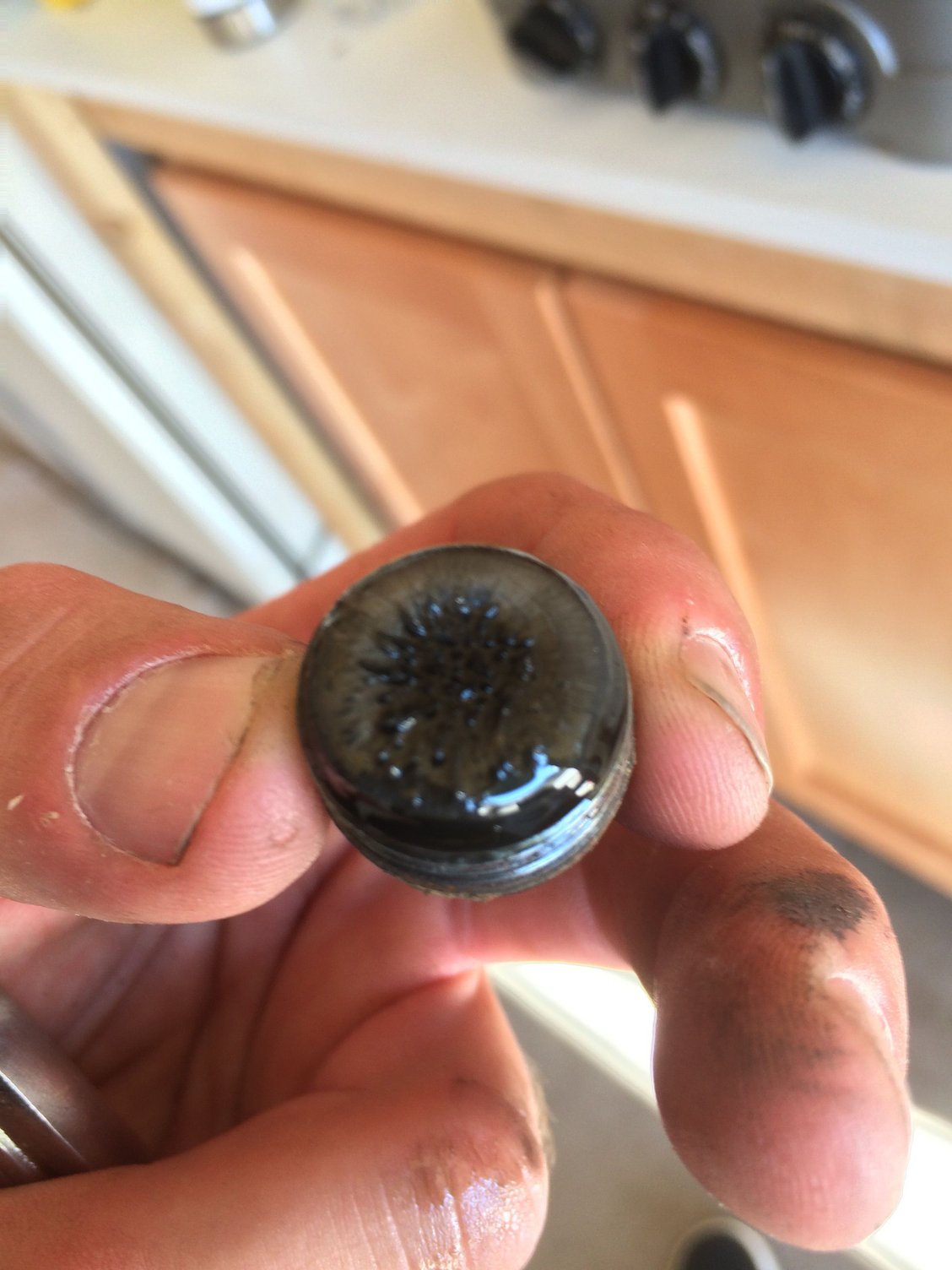

So the diff plug doesn't seem too bad! Oil was just below the full plug hole which is encouraging. Checked drive shaft this morning and there's no play in u joints. Edge of centre bearing hangar isn't uniform I noticed, like it may have had some rubbing. Drive shaft out tomorrow for new bearing and balance and then test run. Rear wheels off for re-balance as well, even though the tires only been on 2 weeks.

Centre bearing changed out, new U joints and driveshaft balanced, have two fastners to replace on the rear yoke? to driveshaft and then i can take it for a run and see whats what!
