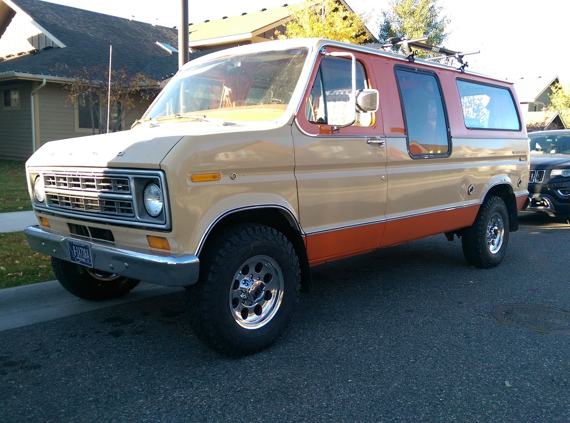

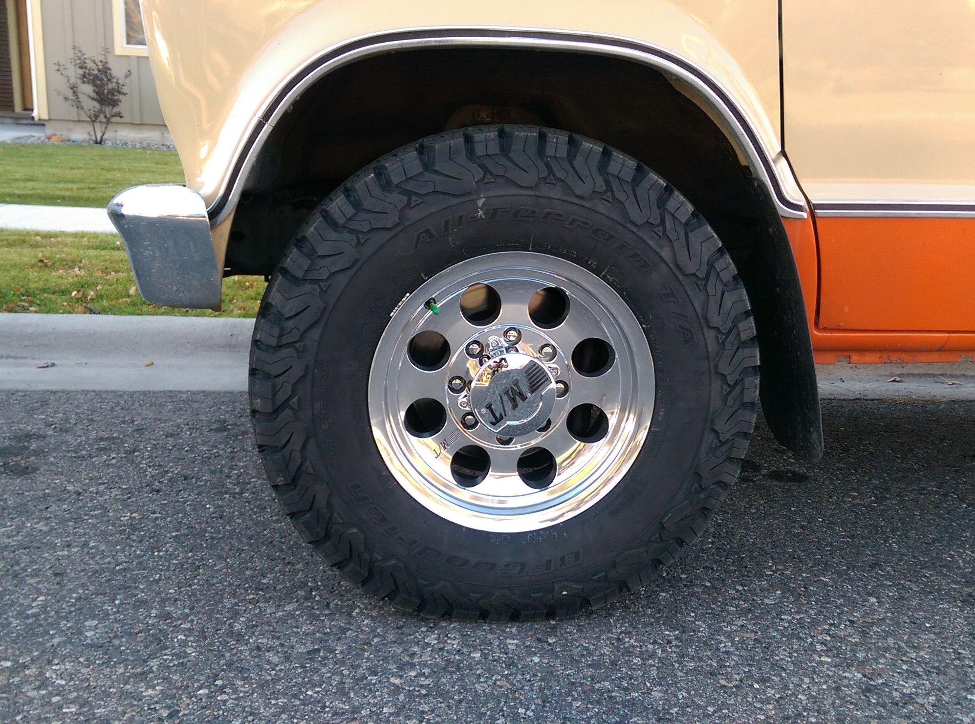

Update - Wheels and Tires Installed
I thought I'd share a couple photos after the tire and wheel installation. I just installed a set of 235/85R16 BFG All Terrain K/O 2's on Mickey Thompson Classic IIIs and it looks great!
I thought I may have clearance issues up front, but they fit nicely. I purchased a set of Airlift 1000 bags for the front coils to give it an inch or so boost, but have not installed yet - and may not need to.

Looks good. I have always liked the tough look of BFG T/A AT's but they cost a lot and cut gas mileage due to their weight and heavy tire tread. Definitely a great looking van.
Is the engine a 351? It will definitely feel more sluggish with the heavy, large diameter tires but should get you through some pretty rough terrain and weather.

Thanks George. The van does indeed have a 351W, with performer intake, an RV cam, and a few other mild performance mods. The previous owner swapped in an E4OD tranny which combined with the 3.73s gives me plenty to work with.

Those are nice looking wheels and tires, look great installed too!
Looking at your front wheel wells the Airlift bags up front might not be needed. If you're not bottoming out during turns or bumps the existing clearance seems just about right.
