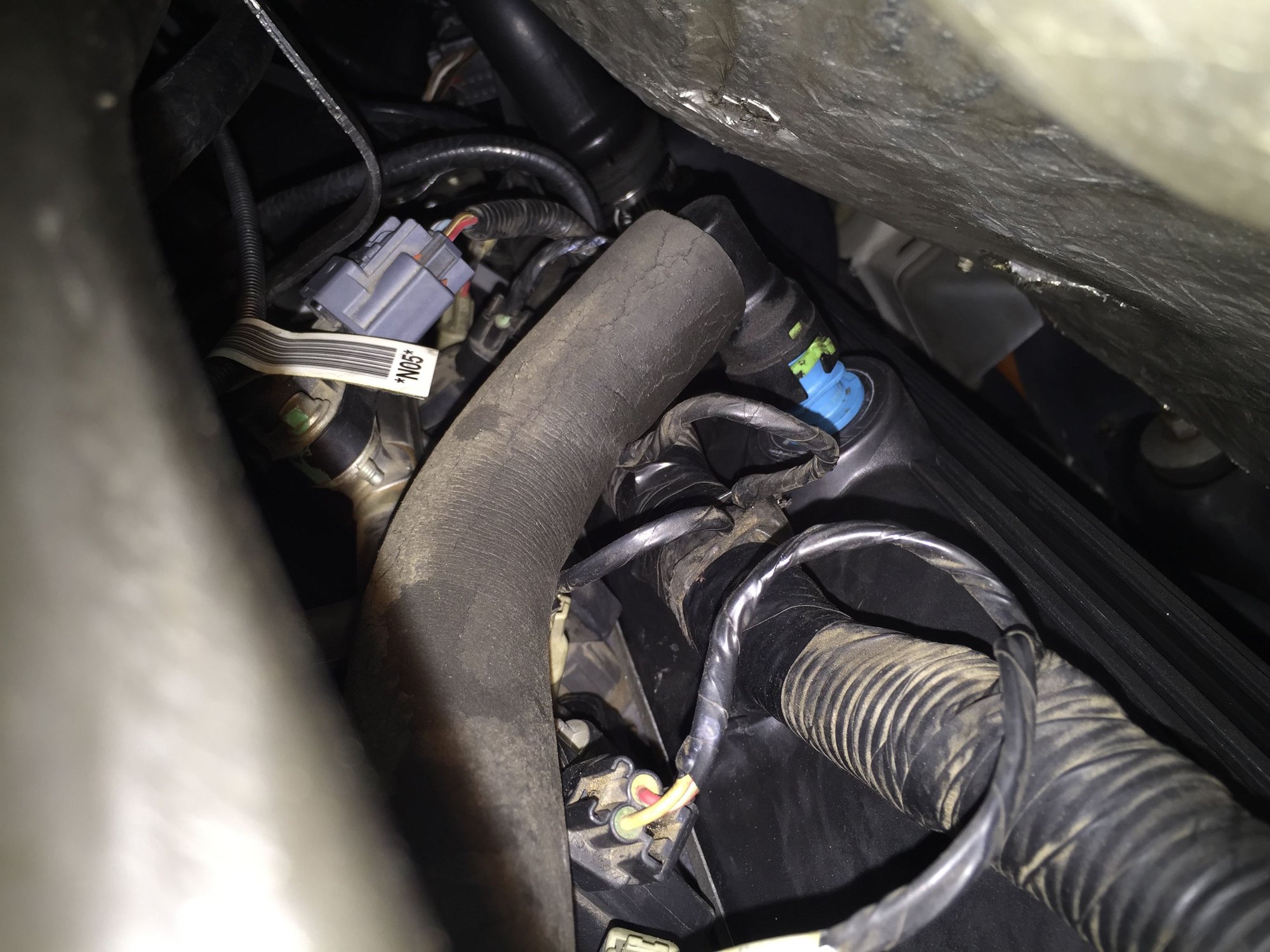

I'm guessing this little dude is the PCV Valve, and it looks ok to my eyes.
Thanks for your input!!!!

I'd vote against replacing the oxygen sensors without some more diagnostic work. You're showing lean codes for both banks, so unless both oxygen sensors happened to die it's not them. I've never seen a broken valve cover like that, how'd that happen? You can check the waveform for the sensors with a good scan tool or oscilloscope. You can also pull the sensors to see if they got coated with oil.
